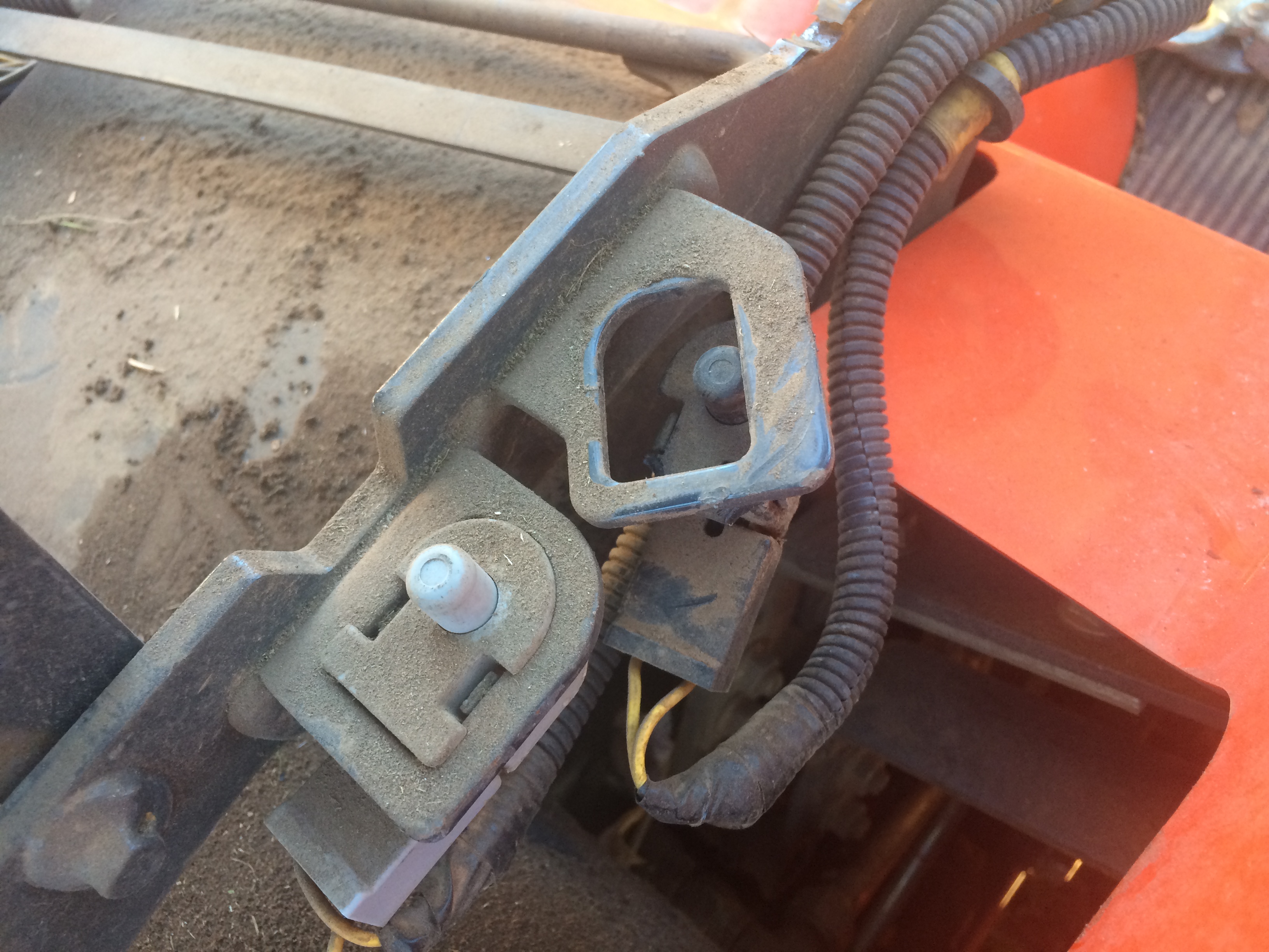

Stopped by the dealer today and spoke with the mechanic who worked on my BX23 last fall and described the problem. He felt it was a safety switch and he printed me out a detail drawing of all the safety switch locations. One saftet switch I noticed is under the neutral/turtle/rabbit speed control levers. Test this and it wasn't the problem.
I kept hearing over in my head how the mechanic thinks it was the seat switches, but I replaced both with brand new switches and I started focuing on the seat again. This time I decide to lift the seat so it wasn't locked into postion or touching the two safety switches.
I started the BX23 in neutral and it started up as normal. I moved the tractor forward and the problem continued with the engine wanting to stall. I pressed the button switch down with my finger and tried to move and the tractor started to stall. Then I left the push button up and this time I held down the white lever on the other safety switch and guess what - it did not stall. I put the seat down, and tried it again just pushing down the white lever and it stalled. Lifted the seat again and pressed down the white lever and no stall. So I decided to take the push button safety switch and popped it put of it's mounting hole under the seat and left it hanging - locked the seat back down and it's working.
Excited to have it working - and I am scratching my head as to why the new, grey colored, button safety switch is making the tractor stall. Keep in mind there are two safety switches under the seat. One looks like a little black box, with a 2 to 3 inch white colored spring lever. The other is a gray push button switch and the seat comes down on the push buttom.
What's strange is when the seat is in the down position, it doesn't look like the seat is pushing the button down. So for now I left this push button switch out and I am running.

Now that is odd! It seems like there is a short somewhere! Do me a favor. with the seat up, can you engage the pto without it cutting off ? maybe pto switch is shorted out? Something is causing the switches to be in open circuit.

Most here suspected fuel issue. I understand you can rev up with no load. Once a load is applied, more fuel is needed to maintain RPM, correct?
I remembered I was able to move the tractor very slowly, however, I was also able to raise able lower my bucket which had forks on it. Wouldn’t raising the bucket with forks enough load to stall it?
I got up this morning and was convinced it was a safety switch/button. Sure enough went out this morning and looked under the seat. There are two button switches, one gray, one black. I saw the black one had slipped through the mounting hole. Upon further inspection, I’ll need a new switch as the plastic mounting tabs are torn. I reinstalled the old one and fired it up. It worked fine.
I guess I’ll add the switch to my Christmas shopping list at Messicks. My wife is happy to allow me to do my annual pilgrimage to Messicks as she gets a trip to Lancaster out of it.
I’ll try to upload the picture of the hanging switch.
