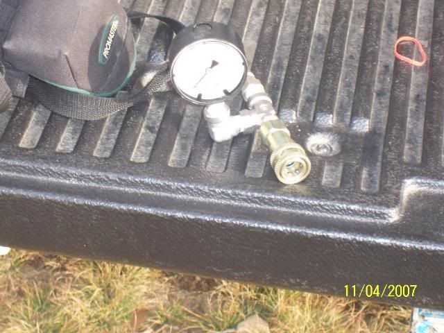

Hey all - got the $14 gauge from Grainger and went to look at hookup pics (Tommu56?) and they're gone.
I'm thinking... if I plumb it, Tee'd in line in the FEL, then operate a cylinder until relief operates (noise) - wouldn't it be exactly the same as if I just deadheaded it (the gauge) inline past the hand valve without the Tee? (It would save me a QD fitting, or maybe I could just hard pipe it in for the test...)
THX in advance

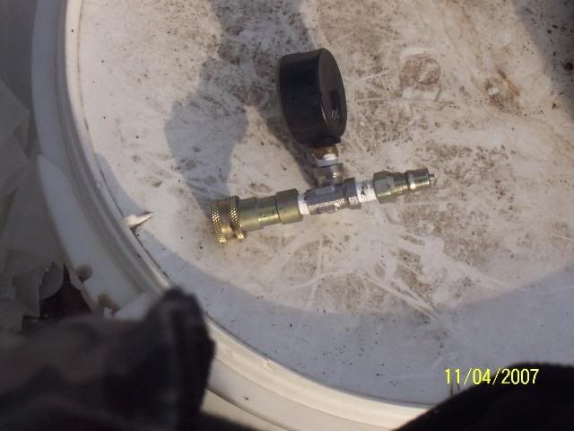

/ BX23 Pressure Relief Test #2
how is this.
hard pipe will work but I couldn't find a place that it wouldn't get knocked off make sure you use good pipe fittings rated for the pressure and these are hydraulic fittings on my gauge assy.
OK - thanks - but still I'm thinking...
Is there a difference between an (open hand operator) valve going to a Tee and then on to a closed, extended cylinder, or just going to only the gauge? (For testing only, besides not being able to use the cylinder.) Seems like it's all deadheaded anyway.
Is the Tee and second connector necessary for test?
/ BX23 Pressure Relief Test #4
either way you are "dead heading" the system.
straight to the QD without the Tee is going to be more accurate, if you have a leaking cylinder(internally) you are going to get a lower reading because if fluid bypassing thru the cylinder.
