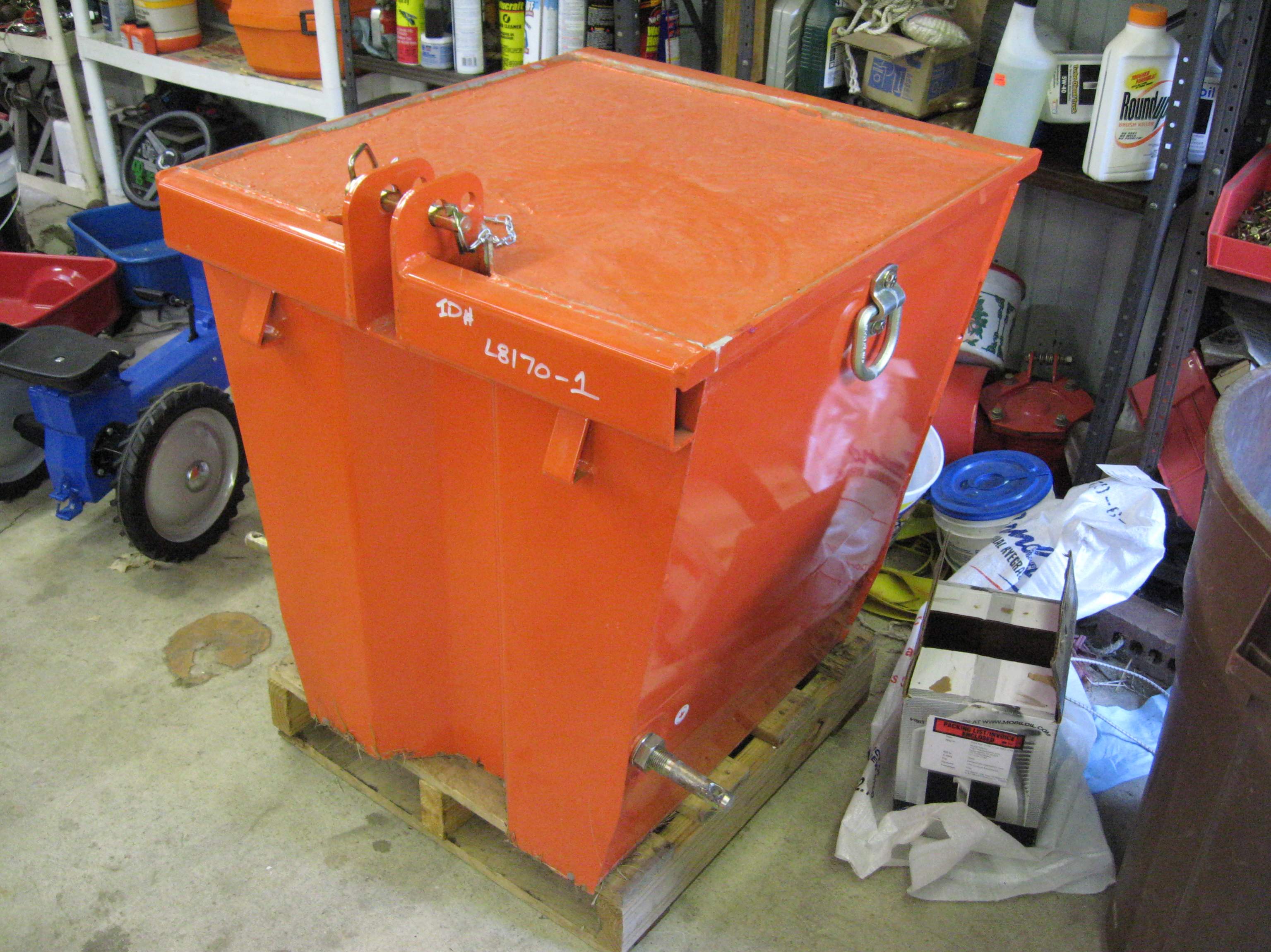

I thought the 3 point lift capacity for a BX machine was around 700 pounds??? The Kubota ballast box for my Grand L weighs 1250 pounds filled with concrete. Philip.
