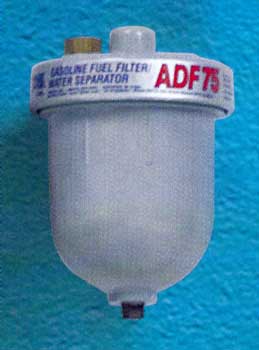

Well I think it is time to get a Dahl Compact Fuel Filter/Water Separator and install it after the 2nd plastic filter (close to engine).
   / bx2200 will not start #8
</font><font color="blue" class="small">( Well I think it is time to get a Dahl Compact Fuel Filter/Water Separator and install it after the 2nd plastic filter (close to engine).
)</font>
I would install it closest to the tank to remove the maximum amount of water and other contaminants. That way, the disposable filters will stay cleaner and if anything does get by, they will pick it up before it makes it to the injector pump....
Dahl Fuel Filter Information Page.........

Will the water be primarily from the fuel being added or from the tank itself? Would the water separating funnel that I had see on here work if you kept the tank full all the time? $170 for one of these separators is quite a bit.

Water separator is a good investment, cheaper than filters, most places will have a universal model for 20-30$ with a see through bowl.
