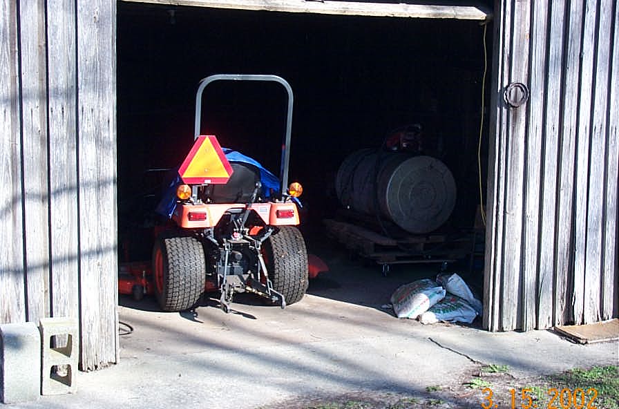

Dealer authorized a local repairman to fix mine under warranty, only about 19 hours on the tractor. Steering cylinder, I believe was the primary culprit.
See attached photo of my setup . . .snazzy ain't it
