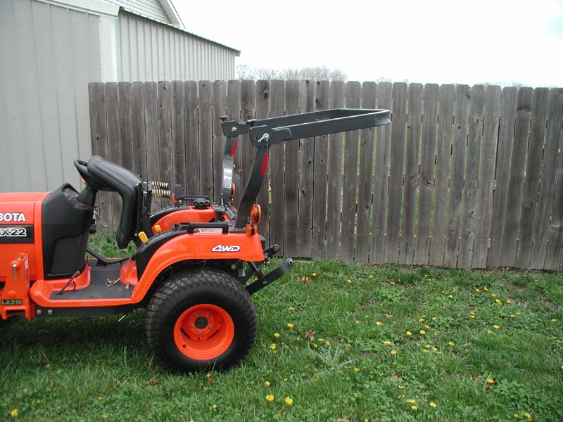

I don't know if this will help. I traded my BX2200 in on a BX22 a couple of weeks ago, attached are photos of ROPs onBX22. The first photo shows ROPs folded. I don't know how other ROPs fold but this only folds to about a 90 deg. angle. I don't think tractor was to be used with ROPs in this position. I belive it only folds to allow tractor to go thru low doorway.

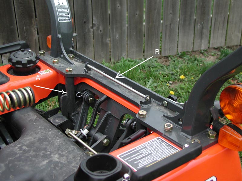

Second photo is of ROPs to tractor attachment. On the BX2200 the ROPs is attached on each side with 4 bolts thru a square mounting plate. On BX22 both sides of ROPs are connected with heavy steel plate. 4 bolts are still present , a 5th bolt is also there. It goes down to backhoe attachment (A in photo 2 & C in photo 3). B in photo is where seat attaches when facing back. D in photo is top mounting point of backhoe 4 point attachment.
It appears that bottom of ROPs is part of the strenghtening that was done to allow backhoe to be attached. Hope this sheds some light on the subject.

Thanks for the replys. The 90 degree fold as on the BX22 is all I'm needing. 99% of the time the ROPS will be in the "Up" position but that 1% that I need it to fold is so I can mow under a row of 6 trees with low lying branches. I definitely want to keep a ROPS on the tractor and will either modify this one or leave it alone unless the dealer does a trade in as mentioned above (assuming the BX22 ROPS can be retrofitted to the BX2200) Crazykansasan, could you post some closeups of the folding hinge and pin system on your ROPS. The design looks fairly simple.

Thanks for the pics. They sure beefed up the backhoe mount. When things settle down for you and you've had some time to play, uh, work with the BX I would also be interested in seeing how they plumbed the rear hydraulics. Would be nice if it was available as a kit for the other BX flavors as well.
