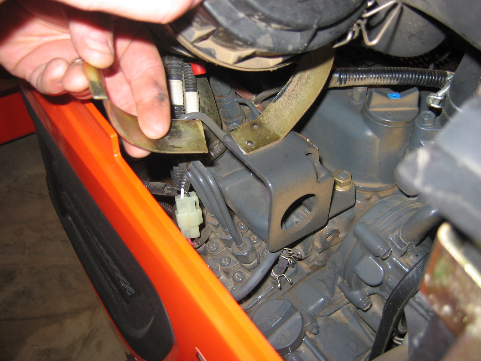

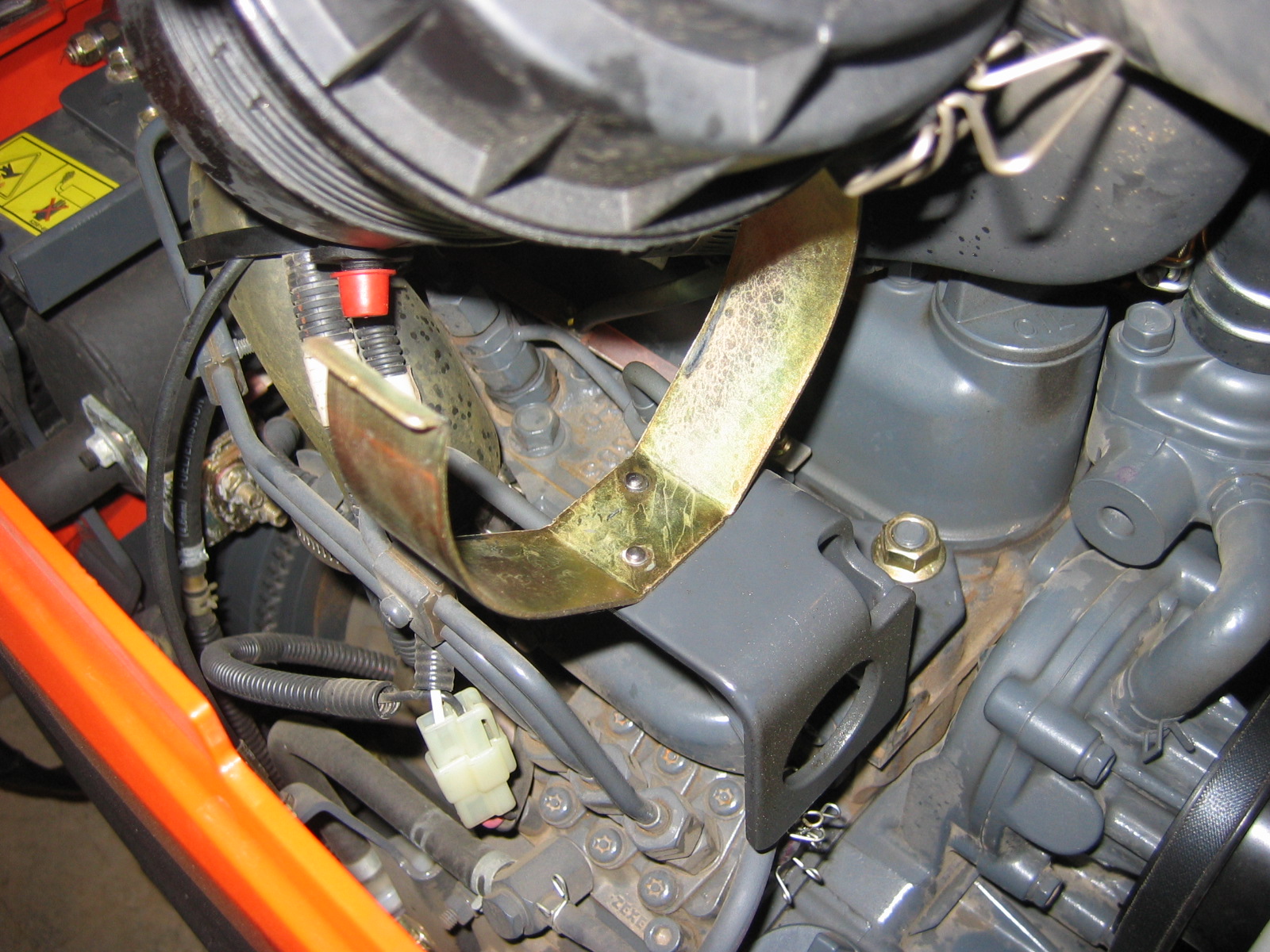

/ BX22 air filter bracket broken again #11
This I GOTTA see. Anybody got a photo of the newest BX bracket??
Here ya go. Pictures of the bracket that I had replaced that broke. The gold part on thr outside broke off close to the gray mounting point. letting the air filter assembly rattle around.
/ BX22 air filter bracket broken again #12
Thanks Tim! :D
IMO that is a much better bracket design than the older BX's. Looks beefy and doesn't have tension on it.
If that works, I bet bungee cords would be just fine on the older machines. I am on my 3rd BX23 (strap-style) bracket.
