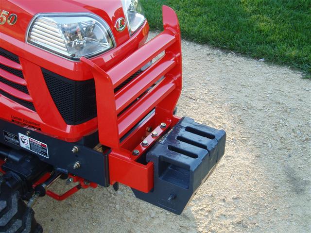

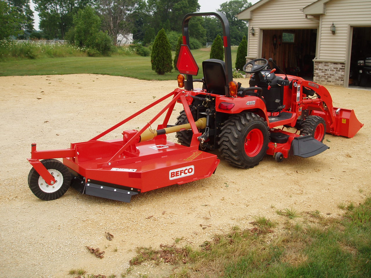

48" Befco RM - works great on my 2350. Keep in mind you will need the FEL or front ballast to keep it on the ground. I have suitcase weights I utilize when the FEL is not mounted up.

I don't know what might be different in your case, but for most people, counterweight is not necessary. I run a 40" heavy duty Gearmore (just under 400 lb.) on a BX2200 and don't come close to needing counterweight, even on fairly steep slopes.
/ bx1850 rotary cutter #7
Weight...
If you look at the link and the attachment your 40" Gearmore weighs in at approx 390lbs. The 48" Befco tips the scale at 440lbs
I can assure you counterweight is necessary on the Befco/BX2350 setup when the mower is in transport mode (off the ground - in the air w/3pt)

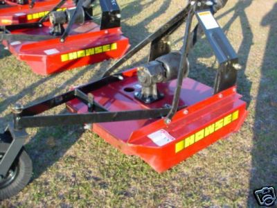

We are looking at a howse 3 foot rotary cutter. To use with the bx 1850.

Hmmm, 50 lb just doesn't seem like it would make that much difference. I will take your word though, because I haven't used your rig on your property.
For the OP and others, it is my opinion that at 390 and below, no counterweight is needed, even on hills.
