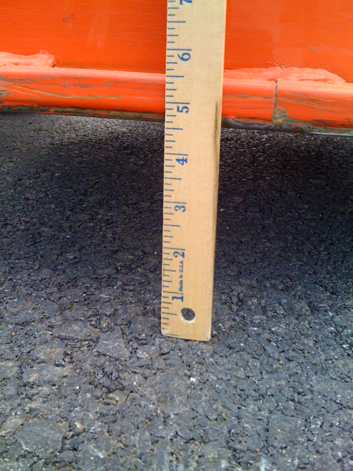

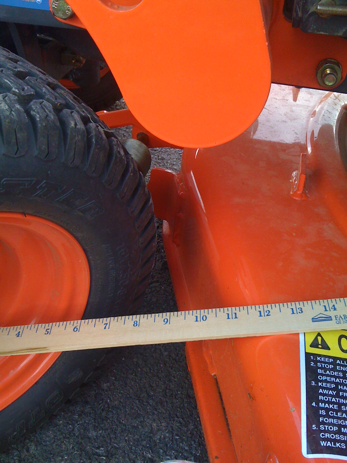

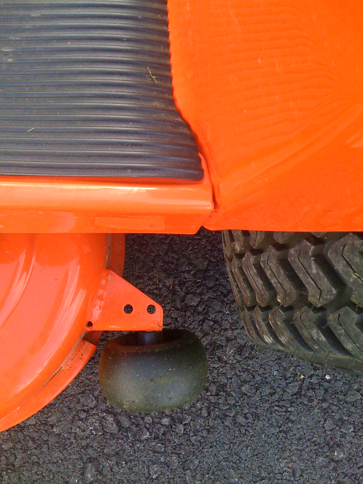

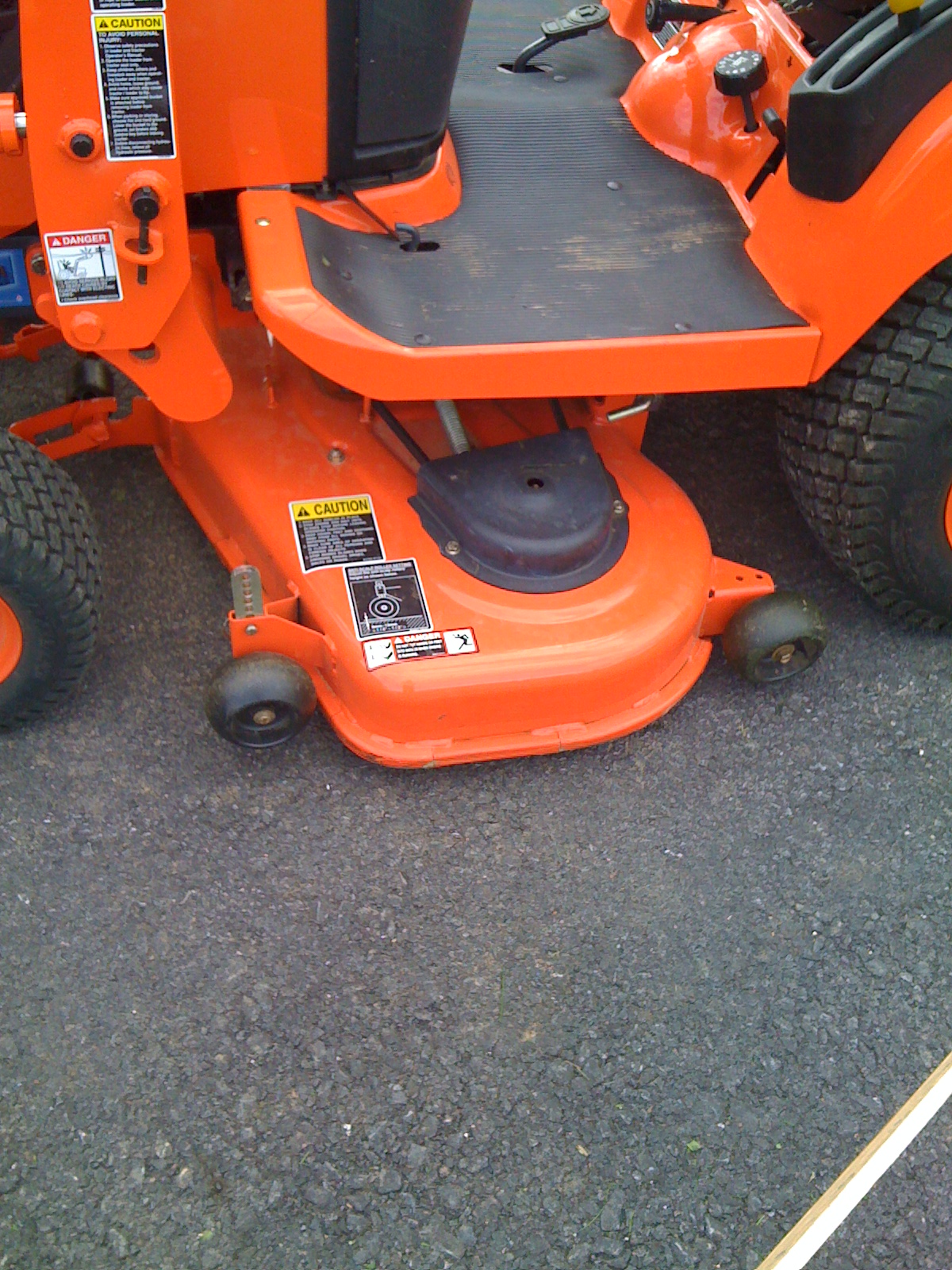

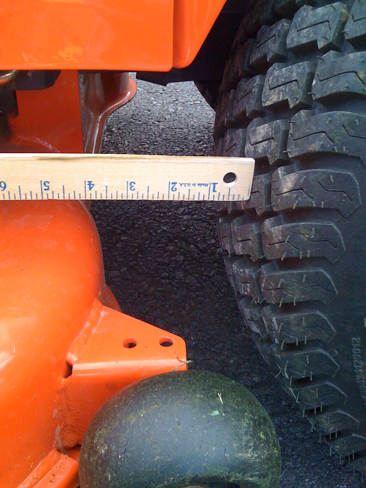

I have a 1860 with 48 mmm. I will post picks when I get out there. The 2year old son is demanding my time now.

Wow. Thanks soooo much.
When you turn the front wheels, how close do they come from the deck? I know it sounds weird, but do the front tires ever come within striking distance of the deck, it's linkage, etc?

Another question, if you don't mind. I cannot tell from the photography because angles always are tricky. The rear deck wheels. Are they closer to the rear tires than where you measured, or are they irrelevant because the are outside the tires? Thanks so much for the information.

I'll post pics tomm. of the wheel turned in on the front and a better angle on the back. Never had a wheel come close to hitting on the front. There is more room in rear then in the pic. They were taking with an iphone and in a hurry because of the kid.

hump, I want to thank you for your pictures. Actually, the photography was pretty good, better than I do with my camera, most times.
There looks to be 3" or better of rear clearance and no issues of clearance in front. Thank you very much. I guess since sw03 mentioned how the 60" had very little clearance on the larger BXs, it begs the question of clearance of the 54" on the 1850/60. Thank you again, hump. Very helpful.

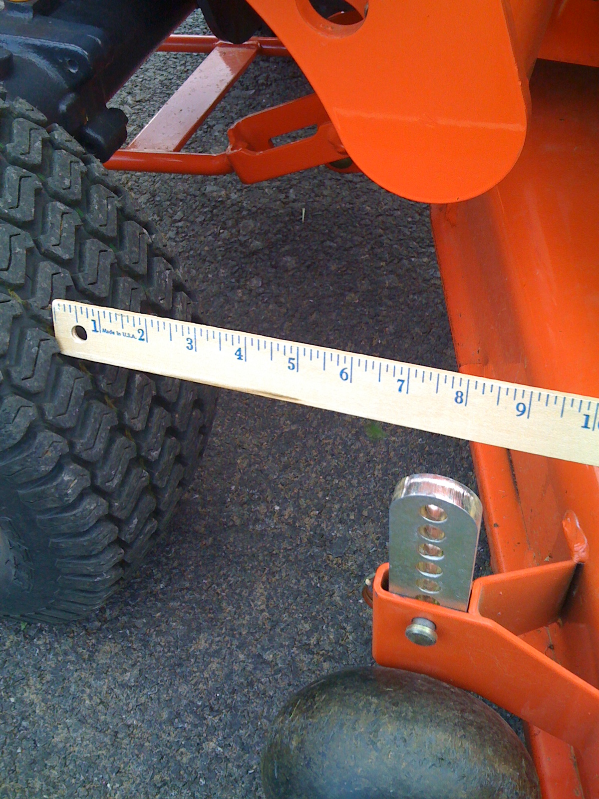

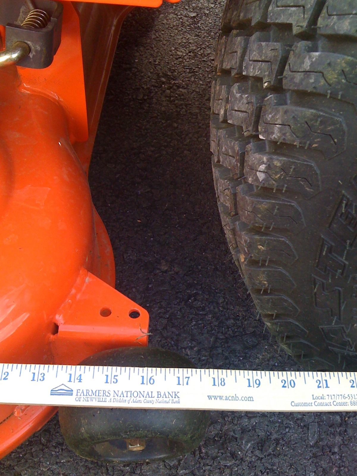

There's a couple more pics for you. Hope that help's even more.

hump, this has been incredible. Wow, what a good job of showing the clearances.
OK, now these two photos. The one shows the front tire turned out and there looks to be a huge amount of clearance. Great.
The second photo, though, looks totally different. The tire is now turned in and boy!!! does that ever look close. What do you think? Sometimes the photos make things look farther or closer, i get that.
But now, to your own eye. On that photo in question. How close is that tire to the front of the deck, would you say. It looks to be within 1" of rubbing. Is that right, or is that just the photo illusion? Is it really as close as it appears? A million thanks.

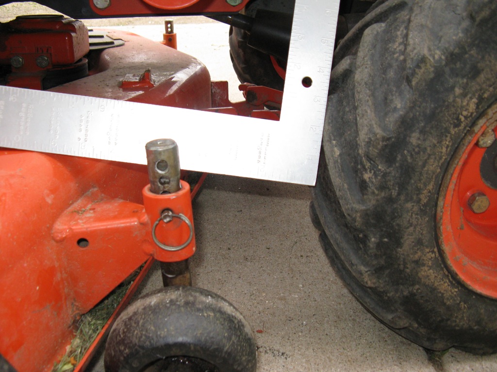

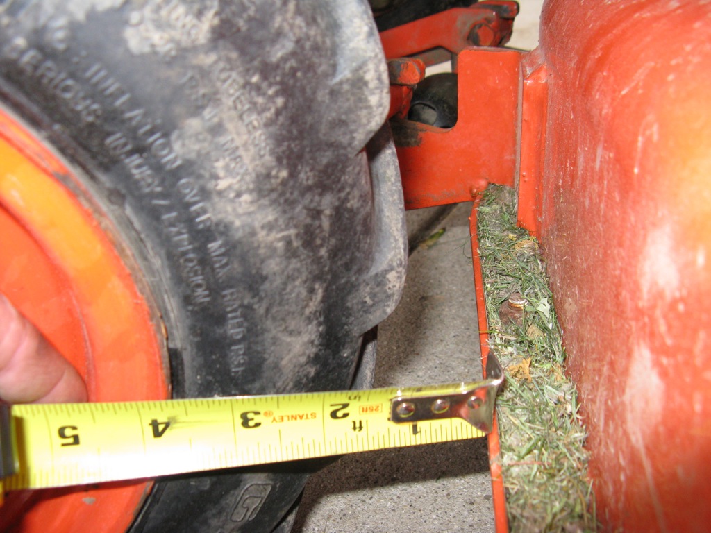

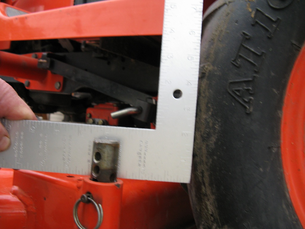

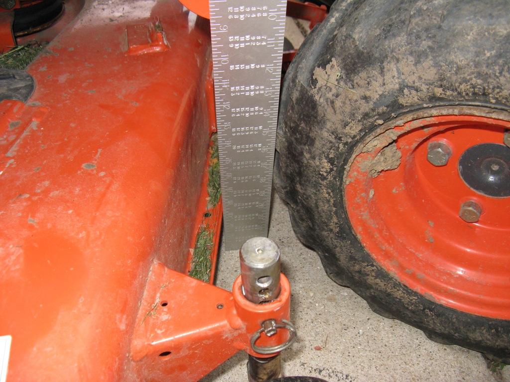

These pictures are all with deck on the stop set for 3 inches. I am not a photographer so some of these may not be the best.
BX1850 with 54" MMM

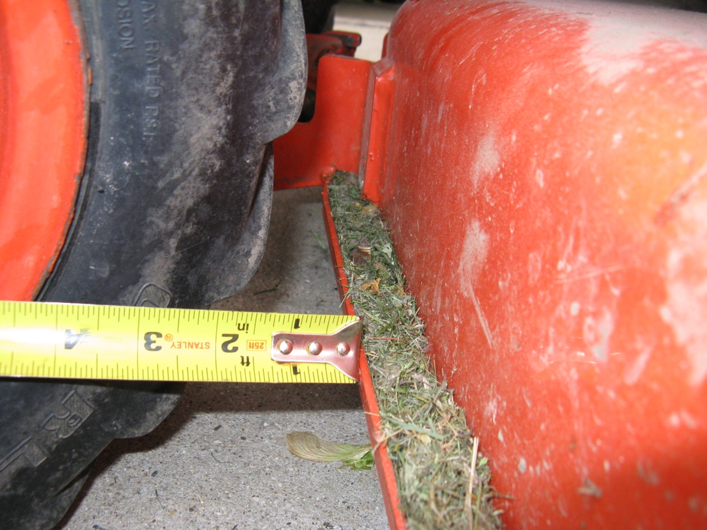

These pictures are with the FEL holding the front of the tractor off the ground so I could try and simulate one of the front wheels dropping in a hole.
Going straight there is lots of room between the deck and the left front wheel. I would not recommend mowing with chains on...

Apparently, as I might has suspected, the clearances on the 54" seem to be tighter than on the 48", even taking tire type into account.
Calls for an opinion here, I know, but based on what you see, does it seem that way to you both as well?
/ BX1850-60 w/ 48" MMM? #20
there seems to be quite a difference between the decks. Much more on the 48". Glad to help BP.
