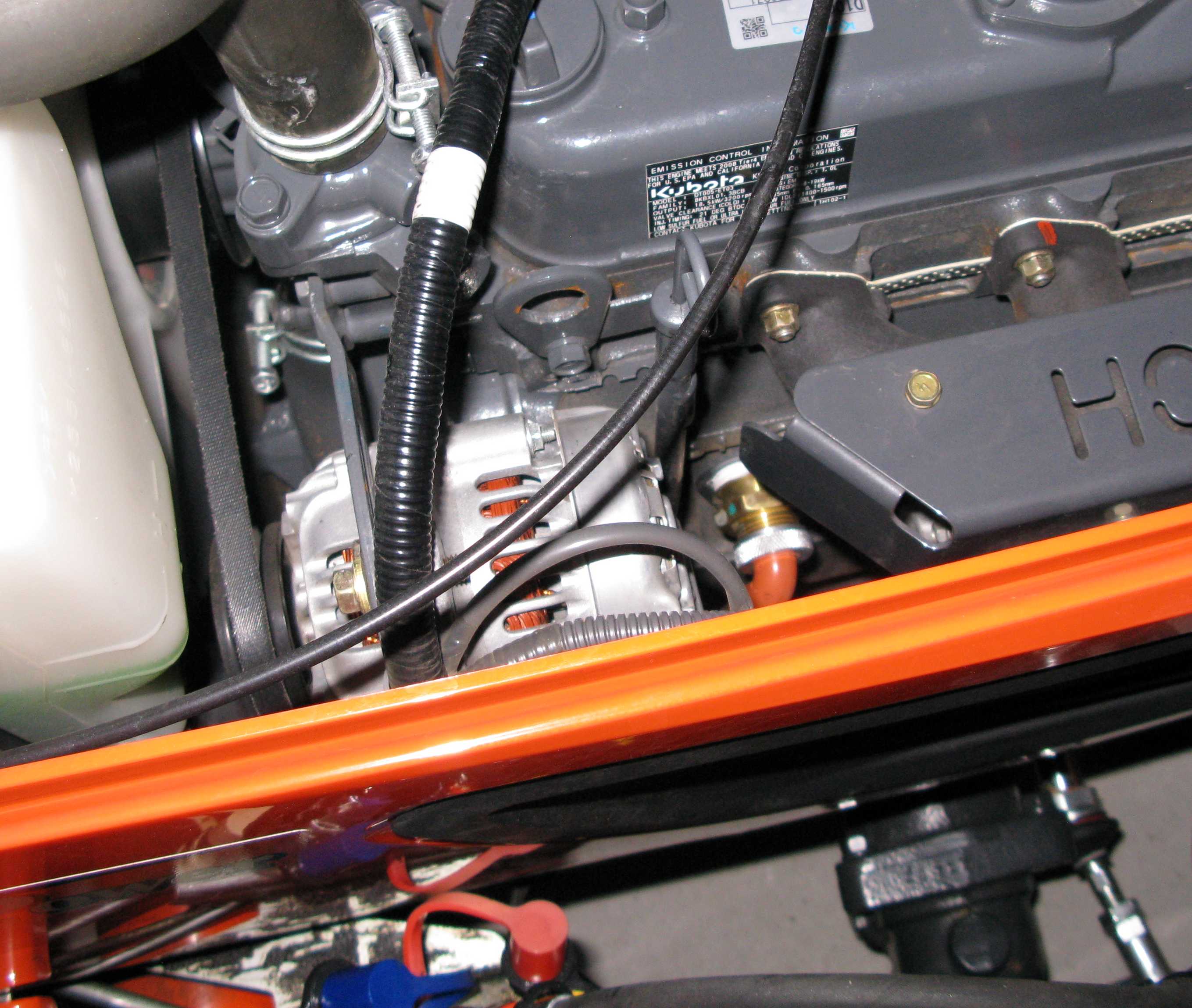

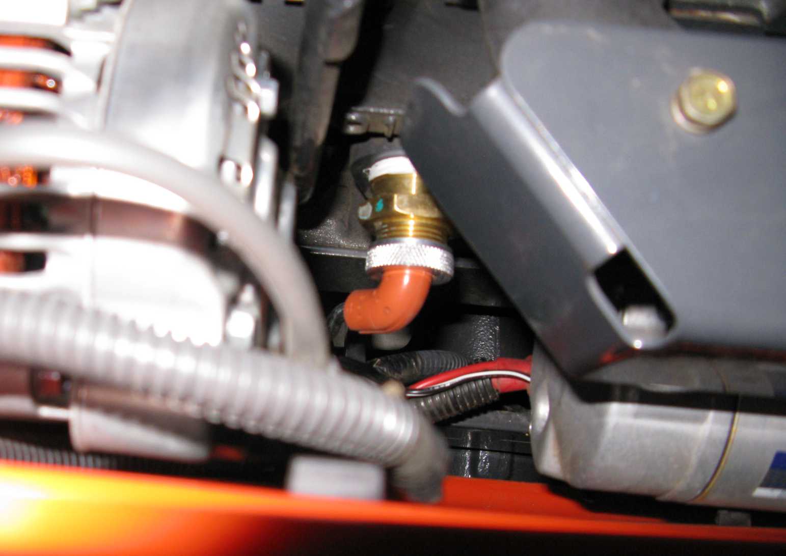

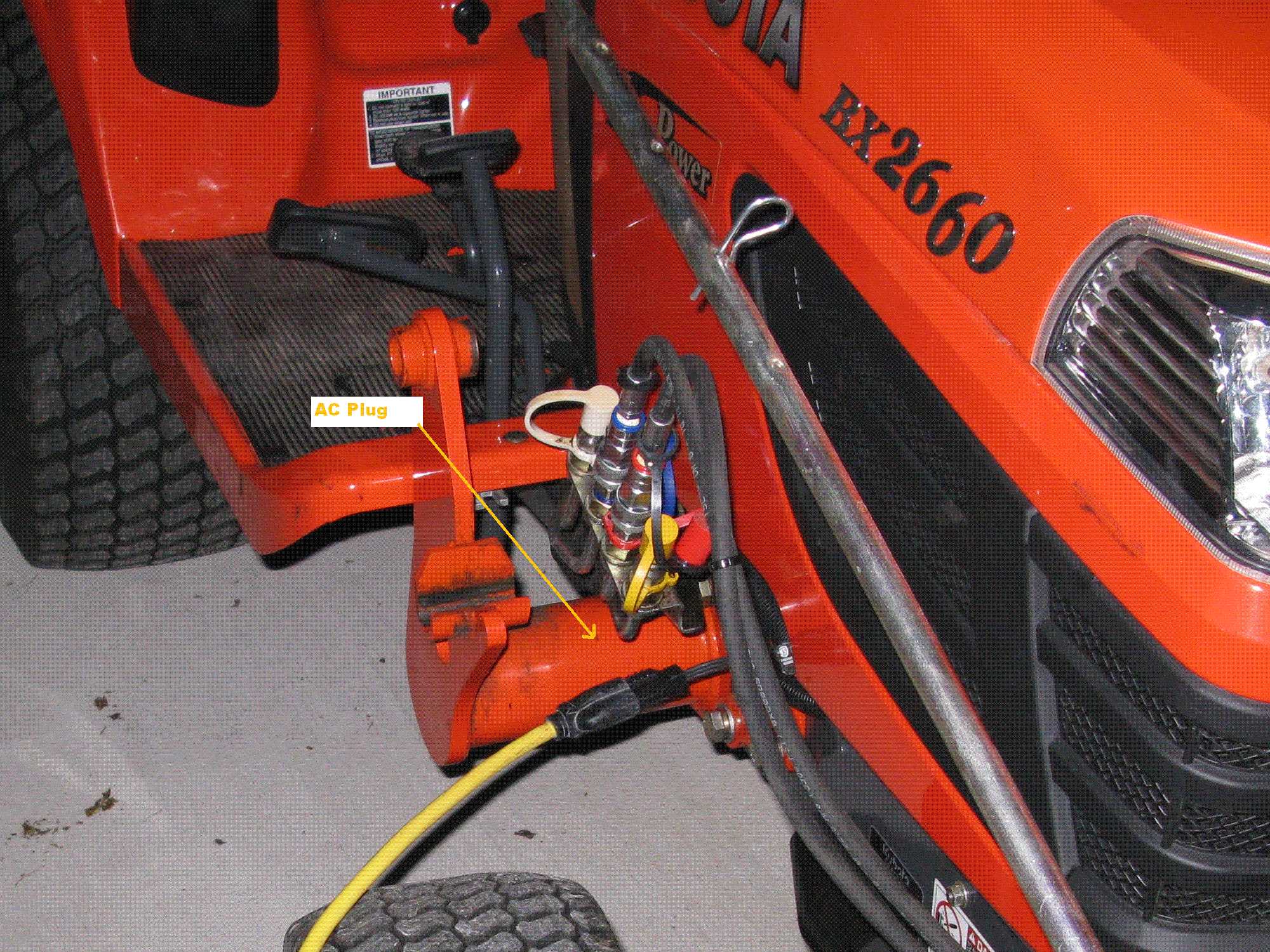

Hi, I just got my tractor back from the dealer with the block heater installed. It was picked up on Friday along with the block heater that I had purchased a year ago. When I got it back, it turns out that they installed a different block heater than the one I gave to them. The new one screws into the block on the right hand side near the starter. There is a plug that you remove with a rather large Allan wrench and the block heater screws in in its place. This is a much easier install than removing the freeze plugs.
I took a couple pictures but did not remove the cowling as I had just reinstalled the snow blower. This coming weekend, I will remove the cowling and take some better pictures.
