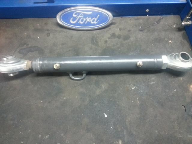

Just a couple easy little mods here to take care of some annoyances with the factory BX top link

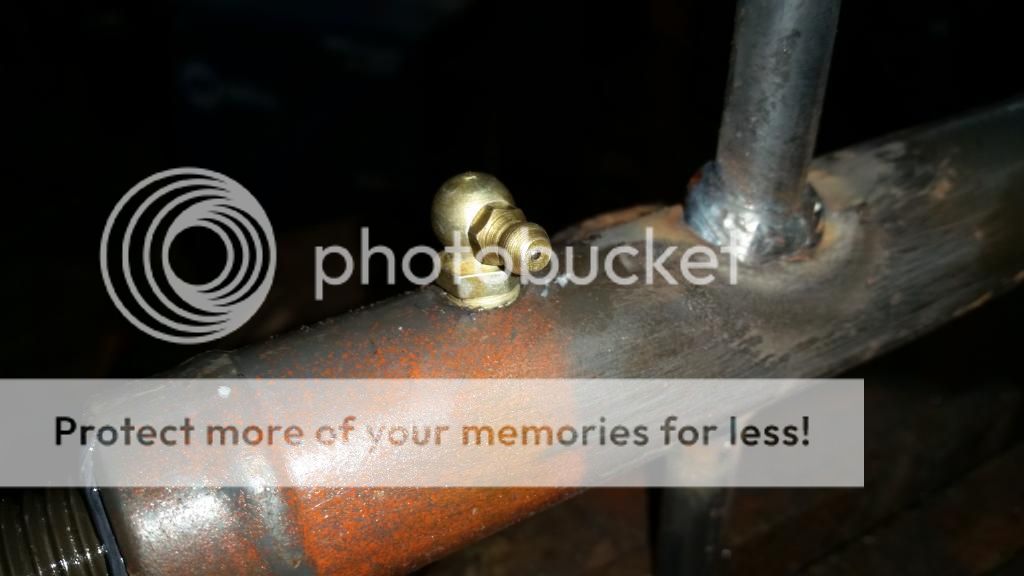

First is to add a couple grease fittings. Under the black caps, there is a hole that is used to push in a roll pin when the link was built. This hole is just about the right size for a 1/8NPT grease fitting. I tapped the hole with a 1/8 NPT tap, no drilling required. There is a fair bit of clearance between the tube and the adjusting screw inside, the threads only go about 1" up the top link tube.
Now I can squirt a shot of grease in there once and a while to keep things smooth.

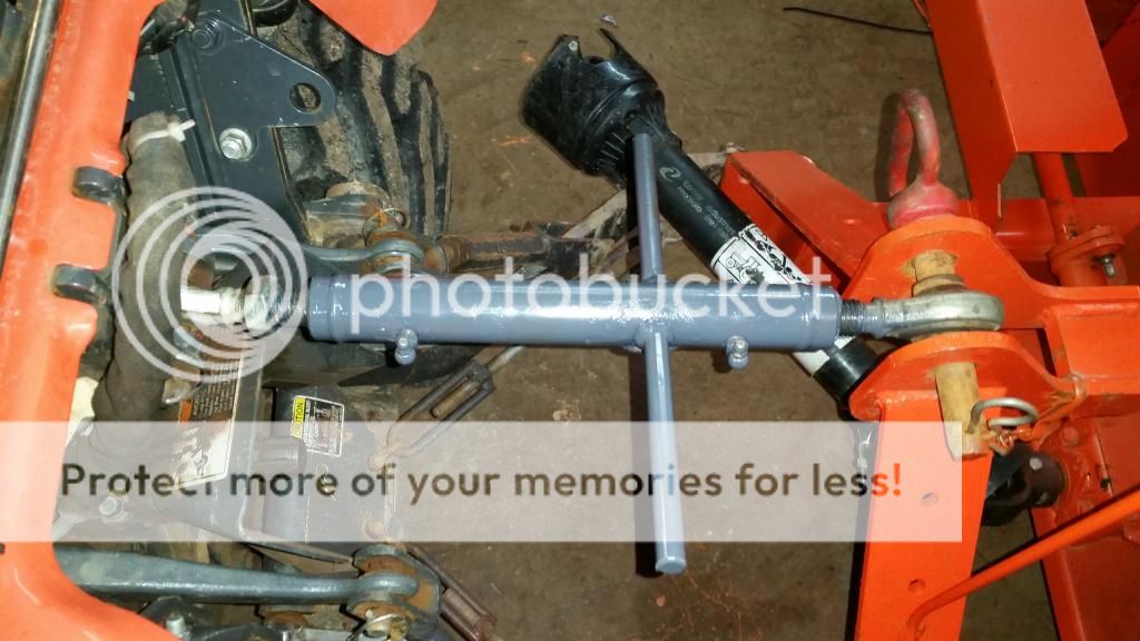

Second was to add some handles to the link to allow for easier adjustment, the welded on chain link is basically useless. The handles are 5" long, 1/2" round.
Lubed with some Cat 5% moly
Installed with a fresh coat of Kubota gray

Good pics. The handles really make life easier. It is so annoying trying to hook something up and not be able to connect the toplink because you can't turn it.
/ BX toplink mods
I think the handles will be a great help. Not only is it annoying to hook up things, but its also difficult to adjust the TL while in use, like when using a Box Blade. I think the handles will be as close as you can get to a manually operated hydraulic top link.

Any concerns about grease building up inside and reducing adjustment? Or will you just take it apart periodically (once every 10 years) and clean it.

The handles would be a great help. My concern is that they would interfere with the PTO shaft or lift arms if they slightly rotated. My method of adjustment is to use a short crowbar and stick it through the "chain link" that is welded to the body.

I predict that the TL might see 2 squirts of grease a year if that. The fact that there are through holes there to pound in/out the roll pins means that even though one side is plugged with a grease fitting, the other side has a loosly fitting plastic plug so you should never end up with a situitation where the grease causes it to lock because you can never get enough hydro pressure to cause it. If the pressure ever builds that high the plastic plug would shoot out I think. That whole tube is basically hollow with just a small set of threads on each end so there is a lot of volume in there you'd have to fill before this becomes an issue.

I was concerned with clearance too. But with the snowblower on there with its PTO, so far clearance isnt a problem for the TL and the PTO or 3pt. If an issue comes up, a few minutes with a hacksaw to shorten the handles is all it would take.
