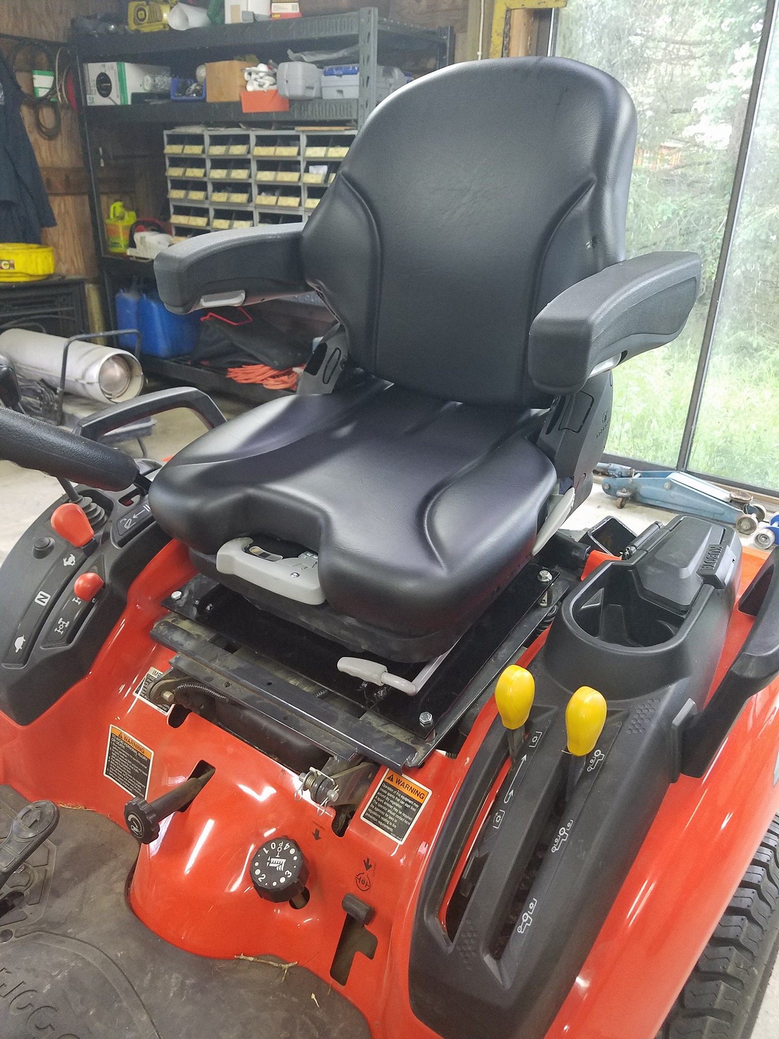

I removed the whole medieval seat and replaced it with a Grammer seat. Now I can get out of bed in the morning after a day of mowing.
Never hooked up that **** switch again.

I'm assuming the Grammer seat installation required some mods? I don't know of any that are strict bolt-ons, but if there is one, enlighten me!
   / BX Seat Safety Switch #19
Mr. Beagle,
It came with a steel plate. I used longer bolts and some spacers. Was not that hard. The seat latch had to be bent a bit, and It's harder to get at.
The seat is very nice. and is adjustable for your weight.
