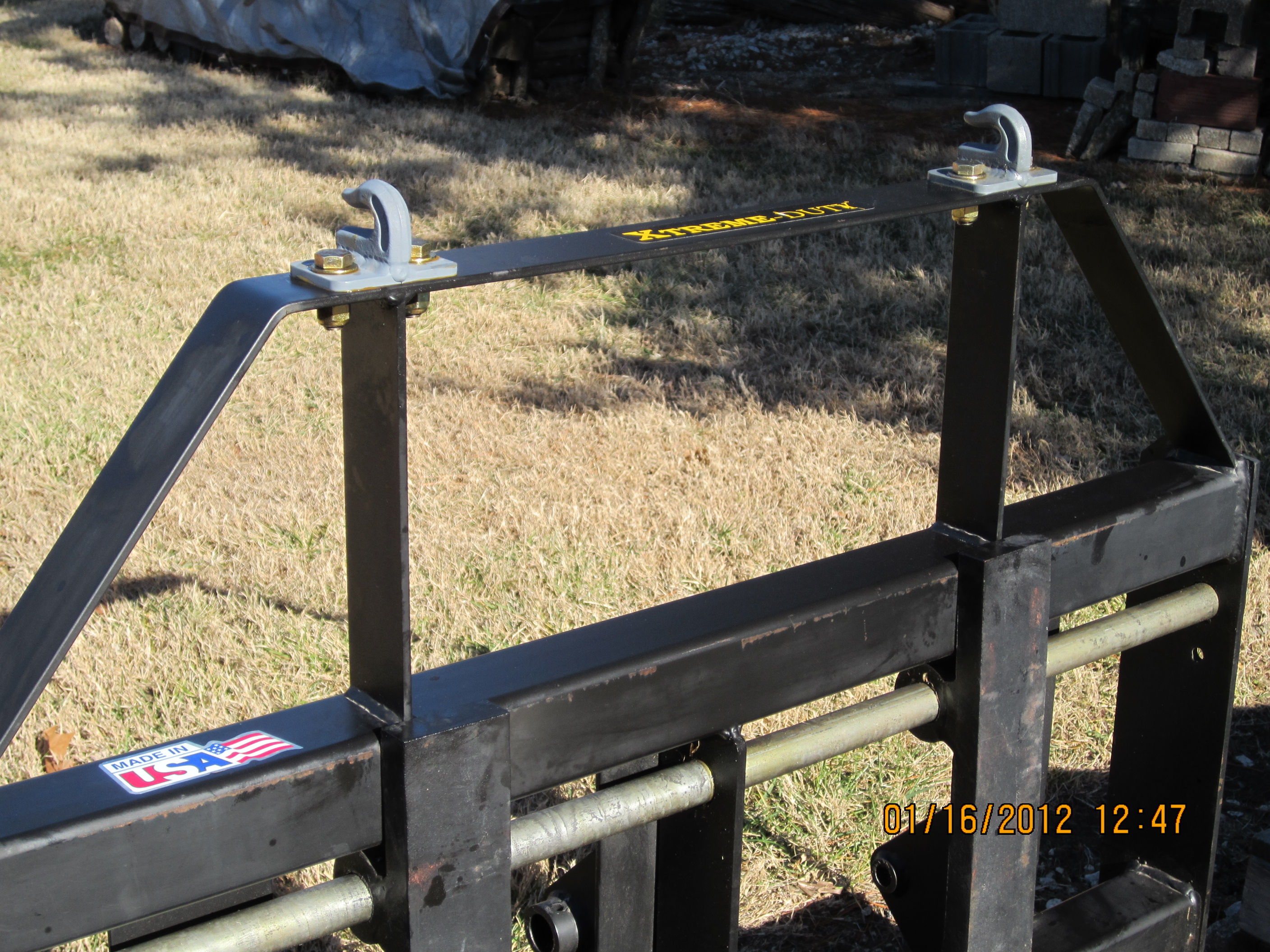

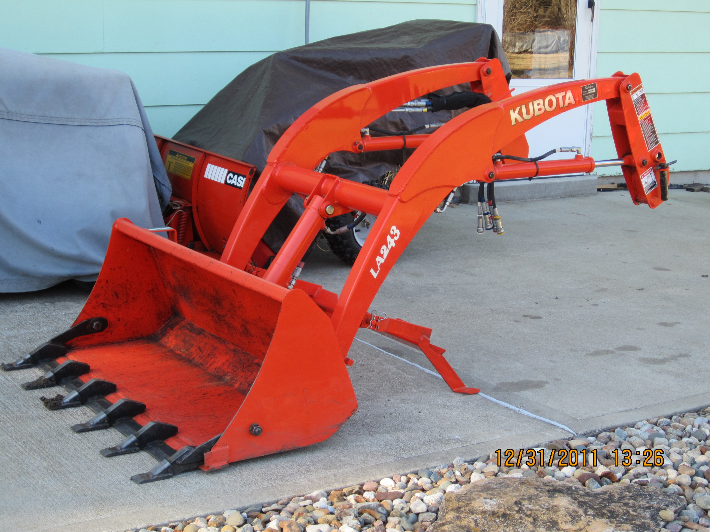

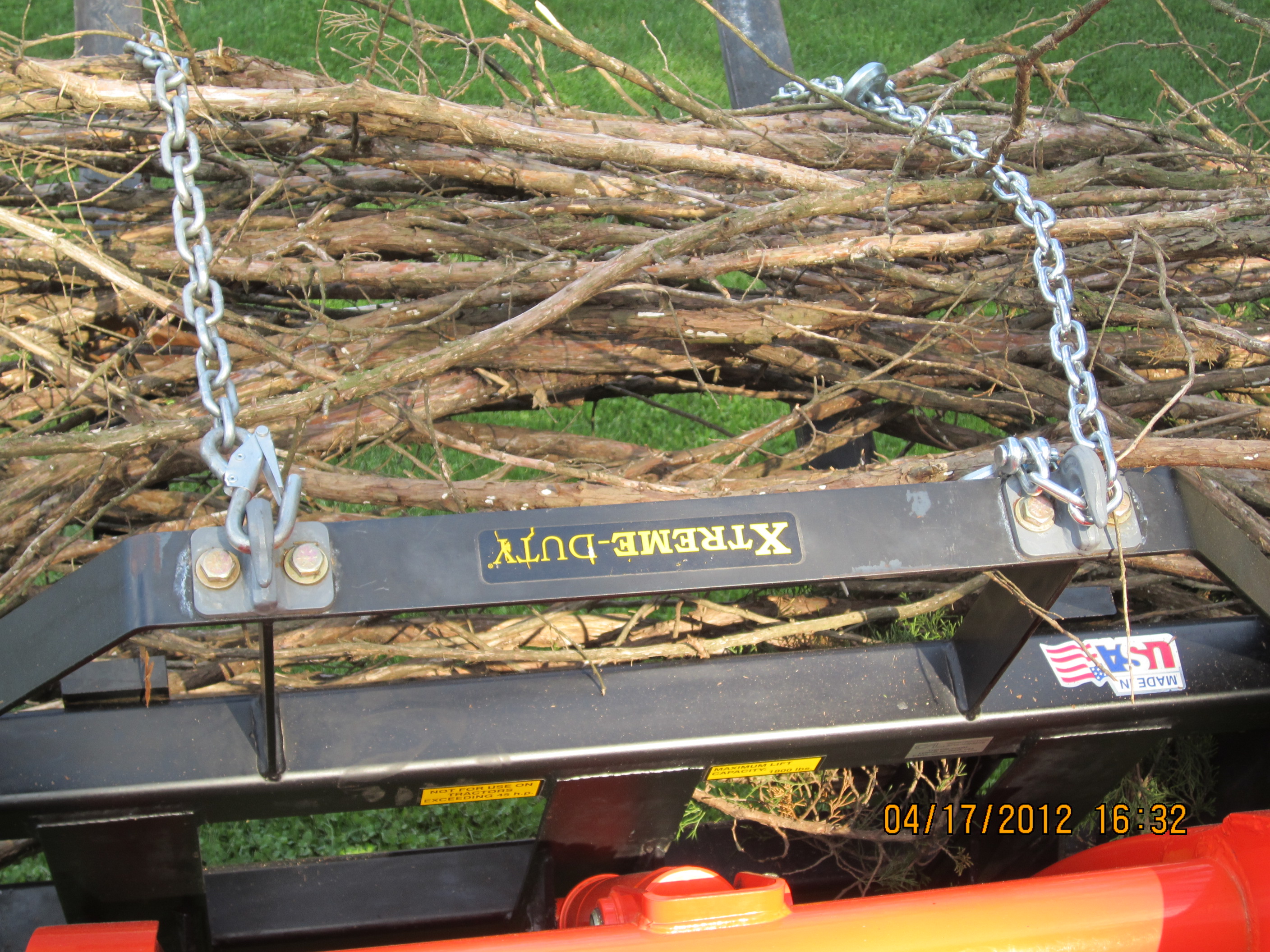

Hardly noticed were the bucket hooks to go along with the Tooth Bar 032.JPG038.JPG084.JPG

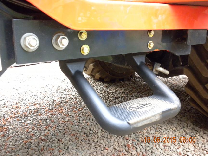

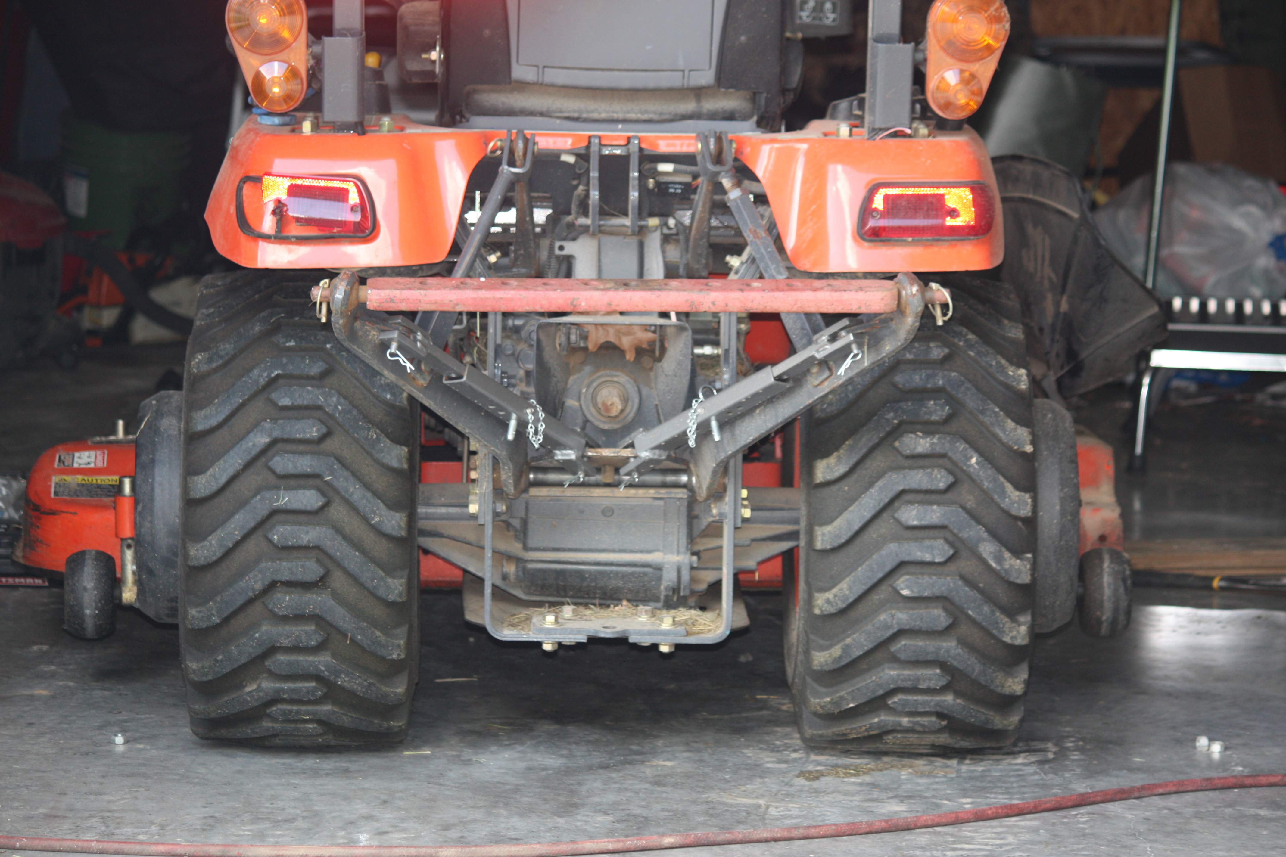

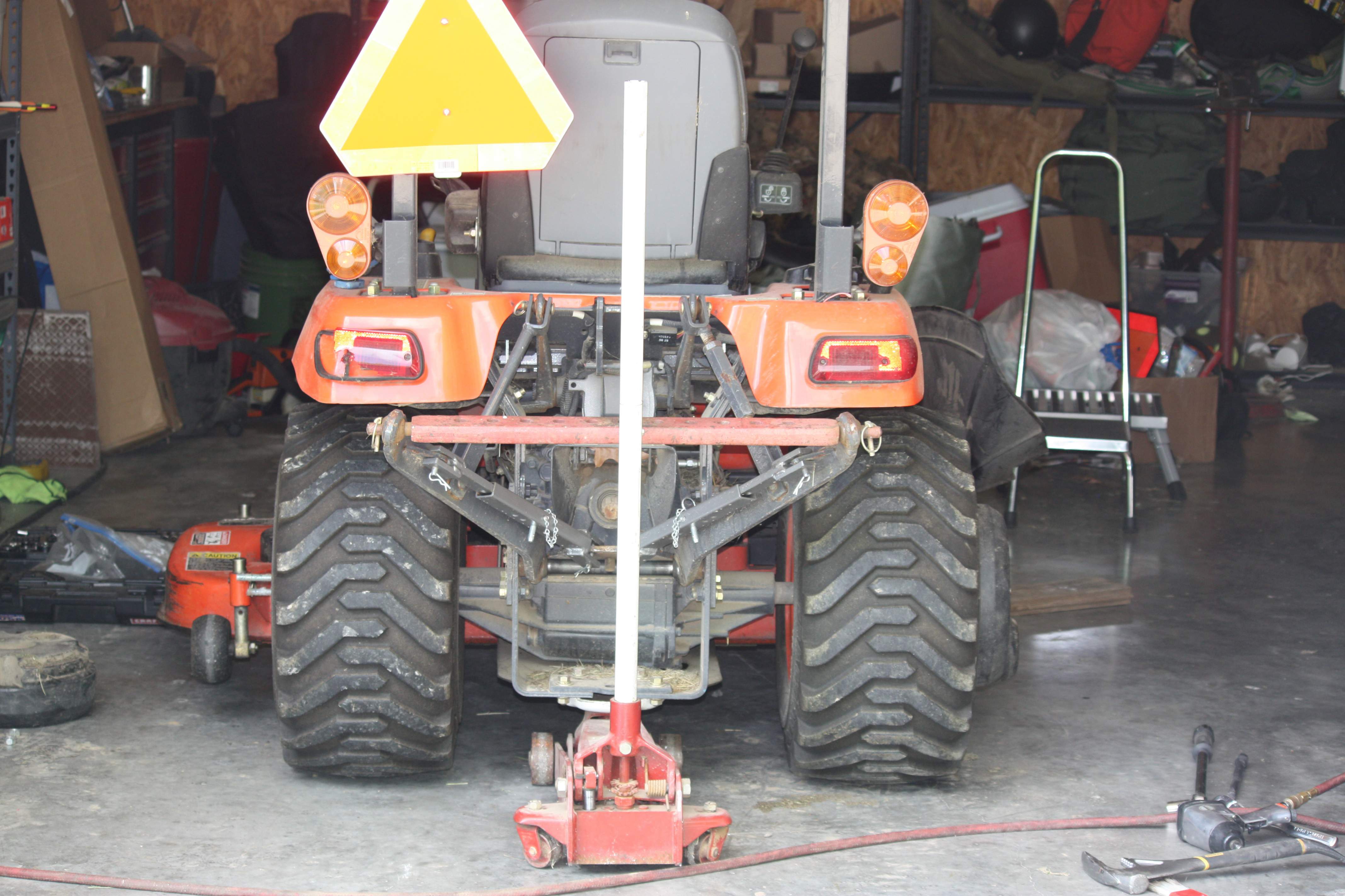

I don't have pictures, but I just got my light protectors from Paul, I've also done Bro Tek fan protectors along with wheel spacers. I also put a after market grill protector with trailer hitch as my BX2200 didn't come stock with a grill protector got it from Fab Works. Also have stabilizers from Hodge. Have wheel weights. I am going to add a step.

Oldballs, where did you get your tooth at from? With the rocks we have here, that would probably be the best for any digging. Probably work better than than a Piranha bar, just too many rocks here for anything built lightly.

IMO, the Piranha Tooth Bar is not built lightly. 1/2in hardened steel. I ram mine into rocky soil routinely and it is still looking great! And it can scrape up and smooth but big teeth cannot.

NewfieDan, I bought the W. R. Long "Flat Tooth Bar" from Iowa Farm Equipment in 2010. WR Long does not sell direct, and this was the closest dealer that I could find. The "Flat" tooth bar has the solid bar on the back side of the bucket which makes "back dragging" go better.
At the time I was working in piles of large rocks and dirt that had settled for several years. I found the teeth do a better job at digging into such.
The Piranha Tooth Bar I have used for many things too, especially in small root entangled earth.
