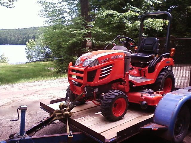

I got the horse trailer conversion working. Still needs finishing touches and to be painted. Just ran out of time so I never got the 2' beaver tail on it before it went to work so it will haul everything fine except the machine with the rake and fel on. (Just too short at 10' 2"!) ;)

Before I got my big trailer, I'd do that with mine. I actually transported it like that with the BH installed on my 5'x10' 3,500# capacity trailer. Single axle. It actually worked pretty well.
In the case of this particular trailer, though, I fear that would only amplify the issue he has with overloading of the tongue. Better to see the mass of the tractor slide REARWARD rather than spin the tractor around and promote sliding if even further FORWARD.
Do you really think the trailer tongue is overloaded?

I have access to another 20' trailer so this is really only used to haul tractor/mower but will work with fel and tiller also in a pinch. ;)
I was speaking more to the weight distribution on the trailer than the weight on the tongue itself. The rear wheels of the tractor is nearly between the two axles of the trailer, the front wheels (with engine block) near the very front of the trailer, THEN the weight of the FEL way out front. This would constitute far more than the "10% guideline" for distributing weight between the trailer axles and tongue.
When I load my tractor on my trailer, I generally put the tractor body squarely between the trailer axles...the rear tires a little behind the rear axle, the front tires a little ahead of the front axle. I figure between the HST transmission and the engine block, this is decently centered. The weight of the FEL then constitutes my 10%. If my BH is attached, I slide the whole thing forward 6" or so to compensate, putting more of the BH weight over the rear axle instead of hanging off the back of the trailer.
Whatever the weight of the trailer (bumper-pull, I mean), 1,000# or 10,000#, it will always tow better with the weight properly distributed. It is a trailer dynamics thing, not a weight capacity thing.
I still love the trailer, though. I would have loved my 5'x10' to have been built like that. Sweet rig.

I was speaking more to the weight distribution on the trailer than the weight on the tongue itself. The rear wheels of the tractor is nearly between the two axles of the trailer, the front wheels (with engine block) near the very front of the trailer, THEN the weight of the FEL way out front. This would constitute far more than the "10% rule" for distributing weight between the trailer axles and tongue..
10% is NOT a rule, it is a guideline.
