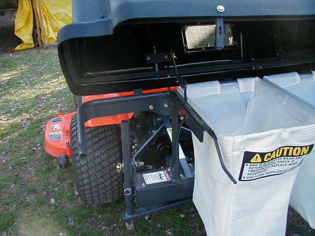

As promised, here are some pictures of my new Grass Catcher on my BX1800. I will post some pictures tonight, but don't have time to get into much discussion on taking on/off, operations etc. as I was out picking up leaves with it right up till now and now I have to go make dinner for the kids..........

/ BX Grass Catcher
Bags w/stop arm to hold cover up.

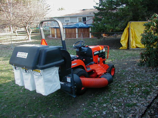

/ BX Grass Catcher
Storage Supports shown down

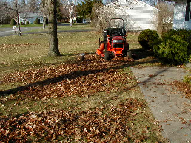

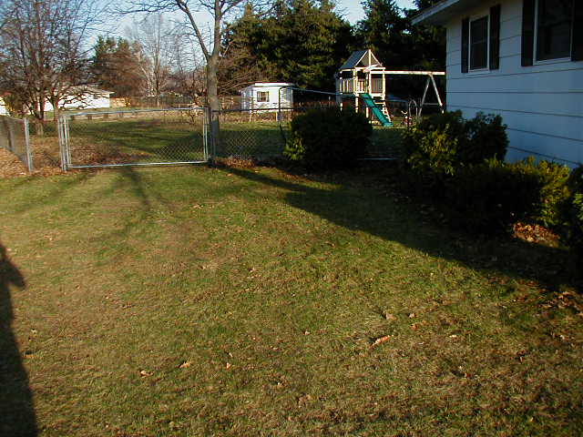

/ BX Grass Catcher

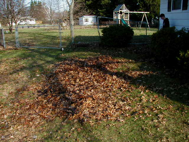

What I was up against tonight.......#1
/ BX Grass Catcher
#9
Kubota conquered #2.........but I do have to be honest, that I did clog it up 3 times. The first was by continuing to mow with the bags full. The 2nd and 3rd were because I was trying to move to fast. I had to go slowly as many were very wet. I learned this after the two mistakes.....but, it really picked them up. I also had to make 5 trips to dump with many more to go tomorrow night!!!!
Overall I am very satisfied with performance, but it does take some getting used to. I am somewhat concerned with the durability of the mounting pin on the deck chute. I will take some pictures of that tomorrow and post then as I have to go now..........

My questions in no particular order.
Is the bagger easy to take off (I take it you set it on its own stands).
Does it go up and down when the deck goes up and down
Does it ever rub the ground (as my weights sometimes do when I transition a hill)
How much did you have to pay (in your area / my mileage will vary /forums/images/graemlins/smirk.gif)
Any grease zirks?
Do you have to drill the deck, what holds the grass chute open on the deck.
Thanks again, you went WAY above and beyond the call, but your posts were well worth it, because there is SOooo little out there on the baggers. Kubota will owe you a cut!

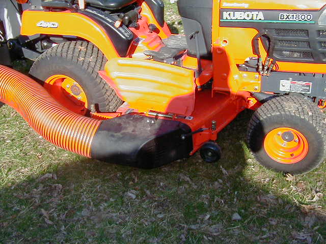

Great pictures. I’ll add a few cents of my own. As I mentioned in the “Transporting a BX22” thread I did take some pictures of the chute mechanism and make some comments in the "Describe the grass collection system" thread. My apologies if I duplicate those comments here.

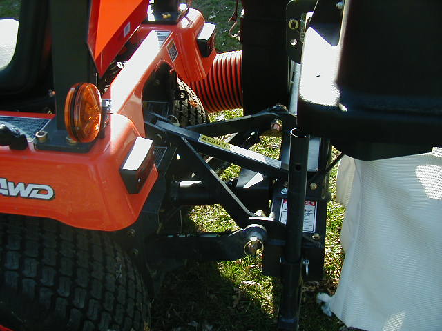

I picked it up from Russ in the box and put it together myself. Easy assembly as all the difficult stuff is pre-assembled in the gearbox / blower unit. Probably took me two hours, going slow.
I was a little dismayed that you need to take the lift brackets off the 3pt lift arms, but when you think about it, since the mower and the 3pt mechanism use the same lift hydro there really isn’t another way to do it. Wait, before I get flames on that I do recall someone on TBN that built a really slick quick hitch type mechanism for their BX bagger. Getting the thing on is a bear, I wrestled with it a while before I came to the (erroneous) conclusion that something was not sized right. I called Russ and he sent out his head mechanic the next day to have a look see. Tractor newbe that I was, his mechanic explained that 3pt hitch implements are not the micro tolerance machines that I might think they are. They often take a mallet whack, drift pin, and foul language to get on. Using all three, he and I were able to wrestle the thing on.
Now that I have practice and know what to expect it is decidedly much easier, although I do use my floor jack to hoist the thing up while I get the top link in place. That’s right, you don’t use the top link itself, instead the bagger has its own “top link” built in that you wrestle into the top link bracket. My apologies to 3pt nomenclature “purists”, after three years of TBN benefiting from the experience of tractor masters, I fear I am still a newbe, so I’m calling the 3pt parts what I THINK they are called, not necessarily WHAT they are called. It probably takes me 10 minutes to put on and 5 to take off. Most of that time is spent removing and attaching the 3pt lift brackets. Kubota does give you some “key ring” pin restrainers to replace the cotters in the pins that have them so this task is not really that difficult.

What I like:
1) It is fairly compact and stores very nicely. Those little stand arms that drop down are brilliant.
2) Short 8” take up hose. The Simplicity and Cub rigs I trained on had long 6” take up hoses. I’ve only clogged the thing a couple of times, doing things that I really knew better than to do.
3) Well built. It’s heavy for a reason. Although I hope those bags last.
4) It really works well and sucks up anything. Have some extra shear pins on hand if you do like I did and take it places you know better than to.
5) It is pretty easy (and quick) to empty (see caveat below).
6) It makes a cool jet engine like noise when you flip it on and crank up the throttle!

rogue,
Direct answers to your questions. I'll try to hold off on the rant this time.
Pretty much like any 3pt implement. As I mentioned in my rant my floor jack comes in real handy.
No. You remove the lift arm levelers (I called them lift brackets in my last post, but I think this is what they are really called, they are the things that connect the lift arms to the hydro servo "ears"). This way the lift arms flop down. When you attach the bagger and tilt it up to connect the "top link" it rocks agains the lift arms and they lift up. If my description is still not clear and surfran doesn't have time to snap a picture I'll do so when I put it on in a week or two.
I really don't have any hills, but if anything would rub it would just be the bags and they hang so the wost that would happen is you would un-hook a bag. It would have to be a pretty steep hill to do so.
> How much did you have to pay (in your area / my mileage will vary )
Don't recall exactly but I think it was around $1600.
> Any grease zirks?
No, but others please check and correct me ASAP if this is not the case!

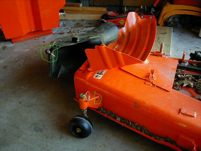

The boot attachment for a 60" and 54" deck are different. I'll post the instructions for drilling in a later post. There is a metal "ear" on the boot assembly that holds the chute deflector open. See the attached picture.

Hmm... can't get the scan size right for the 54" and 60" boot installation instructions. On the 54" (which I have) you need to drill one hole (see attachment) for the boot pin, and widen the other hole for the bungee cord that holds the boot on (see previous picture). For the 60" deck you need to drill two .390" holes on the top of the deck spaced 3 3/4" apart 5 1/4" from the edge of the deck where the chute deflector spring is. Not sure how the boot connects.
In my previous answers I mentioned that there are no zirks. While I still beleive this to be true there is a gearbox that is going to eventually want an oil change and a PTO shaft and 3pt pins that would like a little grease from time to time.

The grass catcher does come off a little more difficult than I would like to have seen. I receievd my BX on a Sunday and promptly tried to remove it. I could not get the top pin out easily so I was going to hook up the lift arms to "easily" lift and take pressure off top link pin, but decided against it until I talked to dealer so I didn't damage.
Problem with Kubota manual is that it does a good job explaining how to install this thing on the tractor from out of the box, but NOTHING on how to take on and off normally!!!!!
Anyhow, I called Al Murray from Carvers on Monday and he indicated that you have to lift up on the unit to remove pin (hence rocks use of floor jack I suspect). Well I got out a hammer and drove pin out close to being removed and then lifted and removed it and lowered down onto support legs. This worked ok, but still was not as easy as I think it should be.
The bottom pins are no problem and the storage legs are great as well. Last night when I got home, I re-installed it. Contrary to rock, I left the lift arms on and first attached the bottom 3-pt arms and the PTO shaft, then standing on the right side CAREFULLY lifted the hitch to move the upper arm above the pin location (making sure it was centered before lifting). Then I rotated the catcher forward and put the pin in (this did take a couple of up and downs as the up is kinda quick some times). Afterwards, I lowered the arms to take pressure off them so I could remove the lift arms. I pulled the pins and wholla it was hooked up (well not totally). Actually then I had to adjust the lower links.

You guys with the 60" decks must have that hole near the back part of the chute already if it indeed mounts with a pin like the 54" deck (see picture for pin location on boot (all these pictures are from my old post)). The two holes that the instructions tell you to drill (Rogue, try a little WD-40 on the bit when you're drilling) for the 60" deck must be to hold the boot on instead of the bungee set up like I have.
I don't really mind the bungee as it is one of the heavy rubber kinds and I can take the boot on and off in around 5 seconds.

Here is my latest round of pictures. Rock, the two holes are for a deflection chute that you install on the deck. The 60" boot attaches the same as the 54" except the bungee hooks to the side hole on the deck anti-scalp wheel mounts.
Tonight I sheered the pin on the drive shaft, or it fell out. I am not sure, as I don't recall any loud noises, but suddenly it wasn't picking up leaves very well. /forums/images/graemlins/confused.gif Luckily I was pretty much done. I did hit some sticks during the endeavor, but don't recall any at that time.
Anyhow, Rock where do you get new pins? Can I get them at Tractor Supply Co? or do I need to get from Kubota? I think I will want several on hand if this is going to be a normal occurance (which I hope it isn't). /forums/images/graemlins/frown.gif
