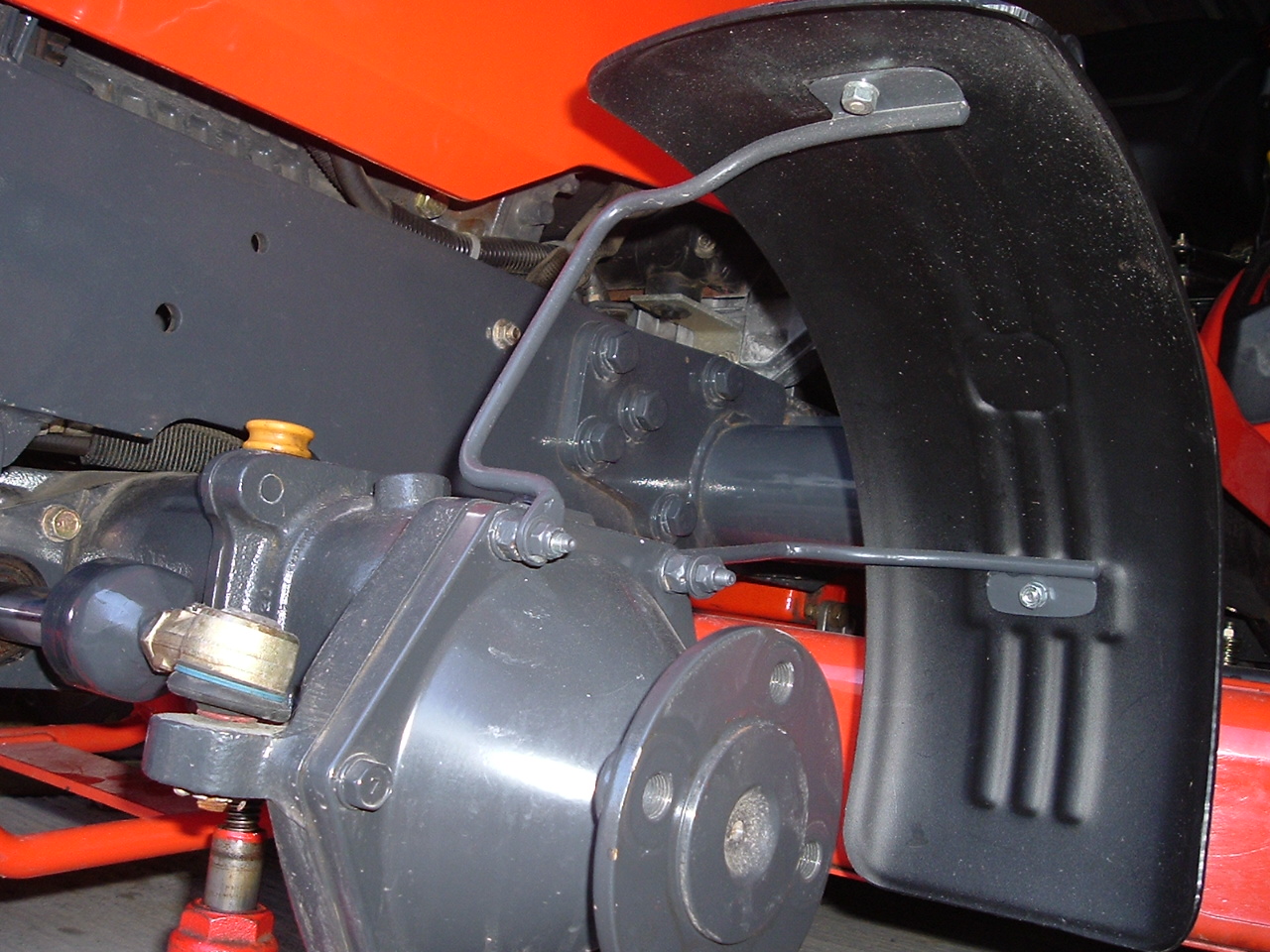

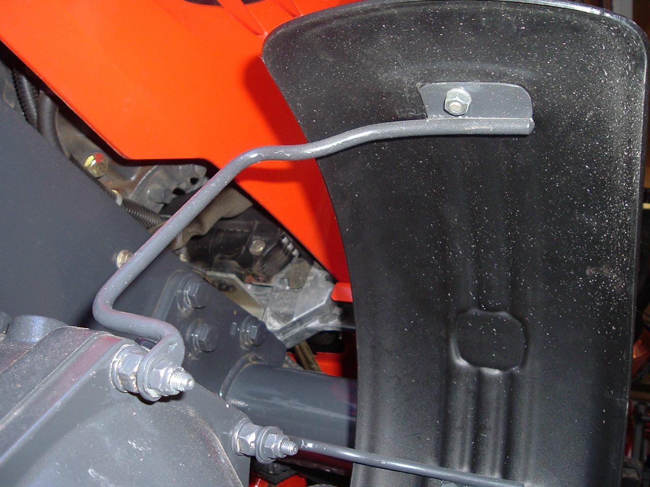

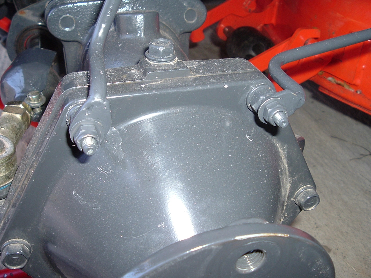

These pics are for those who are interested in mounting front fenders on their Bx tractor, I know , why do you need fenders I guess you really don,t, but they really do a nice job keeping the lower half of your tractor cleaner ( I quess I'm a clean freak )

Where did you get the fenders?
/ Bx Front Fender Mounts Pics
The fenders are from John Deere dealer part # AM133907 at $32 also for more pictures do a search on this form for bx front fenders
