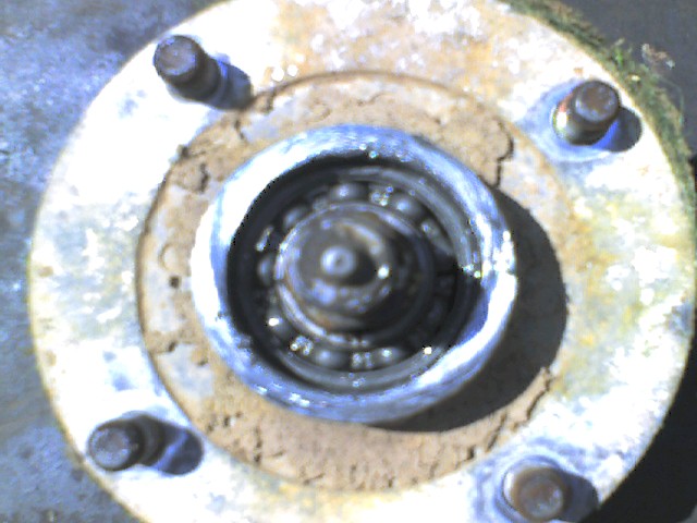

Here are the pix
You can see how the housing is chewed up in the 1st pic
/ BX Deck Warning #22
here is the pulley, both are bad, but this one won't even hold a bolts anymore.
BTWm Those are metal shavings I found

OK,
Went through everything and just ordered all the parts, $250 yikes.
I was thinking of ordering a new belt as this one has been exposed to alot of heat, but at $100+ for a belt, I'll wait.
According to the schematic my serial # calls for K5673-34710, and much later serial numbers call for K5673-34712.
Well, K5673-34710 at $70 has been replaced with K5673-34712 at $100+.
Thought the price would go down, not up by 50%.
/ BX Deck Warning #24
Got my parts order delivered a couple of day ago.
Everything is replaced and repaired.
Just mowed about 1 acre. All good.

The bolts came loose and damaged the pulleys. It was under the boss, so I couldn't see the damage to the pulleys. I just kept and tightening and replacing bolts when they came loose. The plastic covers/shield just allow you to see the top nut and grease fitting. I couldn't really see the vibration caused by the play in the pulleys unless I took the shields off. When I took them off to see what was going on, I knew I was in trouble.
The rebuild was pretty easy.
