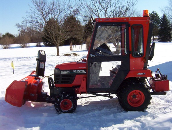

Rear of the cab. Sims was so concerned for air coming into the cab they added this vinyl cover.
/ BX Curtis Cab Owners Help Needed....... #28
I called Sims and asked if they have a cover for the air in take for the engine. They said no, but Curtis has one. /forums/images/graemlins/confused.gif So I covered it with plastic, makes a big difference.

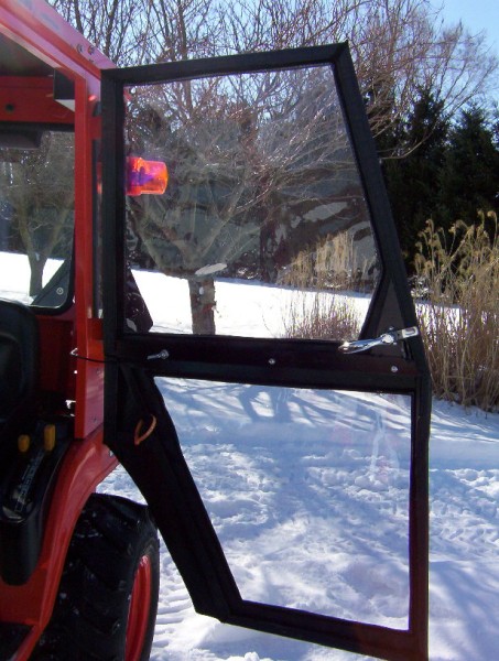

AV,
The left side door you remove one bolt that holds a cable on the door to prevent the wind from damaging the door. Then you just lift the door off two pins. The right side door snaps into place with about 10-15 snaps with Velcro along the edges. This door is not met to be removed very often. I like the Sims because it has more steel then vinyl. But both are much better then having snow blown in your face and down your back when snow blowing. /forums/images/graemlins/grin.gif

Agreed on both points. How quiet is it inside the cab during snow blowing, etc. Was that effected much? Do you keep it on during the summer?
Thanks for the answers on all the sill little questions.
/ BX Curtis Cab Owners Help Needed....... #35
The noise level was not bad at all. Next time I have the BX out I will take a noise level reading just to see. I think it is less then when I have the MMM running. I think the 1 inch head liner makes a big difference.
My plan is to take the cab off in the summer. I have installed a Harbor Freight hoist in the garage to lift the cab off. The section of the cab where the heater is located will remain and the top section will come off.
I plan to rewire the heater so the wires on the side will not be subject to the door hitting it. The extra outlet on the heater pointing towards the windshield I hope will take care of the frost on the windshield when blowing snow.
If you have more questions, or need more pictures let me know. /forums/images/graemlins/grin.gif
