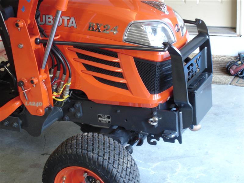

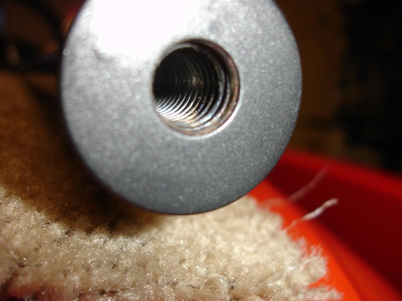

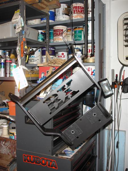

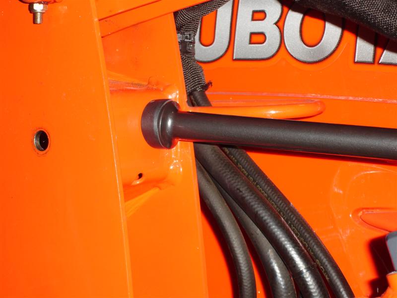

Here is the answer; Last week I moved 9 bags of Sackrete (720lbs) . With the new pressure setting the FEL was able to lift it with no problem - would have tried more if I had more bags - not sure how much I could have lifted before the upgrade. The issue that came up was that over bumpy ground I got some creepy flex at the mounting point for the loader arms.
Of course that spelled quality monster garage time to me: I fabbed these struts to transfer some of the load to the front bumper, and in the process painted the front bumper to match the canopy arms.

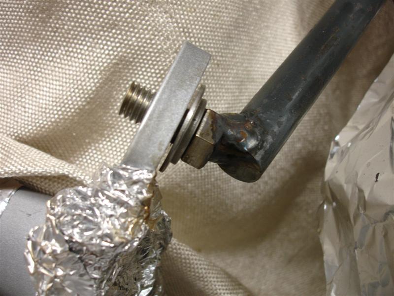

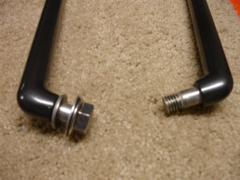

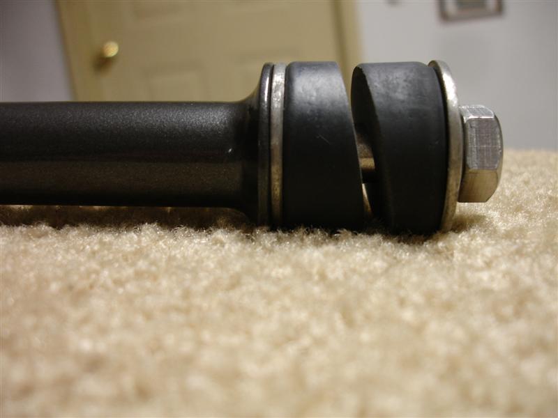

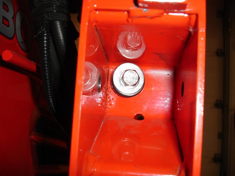

The rod is 3/4" stock with a washer welded on one end and a bolt on the other. The round bumpers are polyurethane shock bushings cut at an angle.
After assembly I wish I had angled the struts down more to follow the lines of the hood, but that would have angled the struts in more possibly causing too much lateral (outward) force on the FEL arms. This setup should eliminate flex when back blading too.

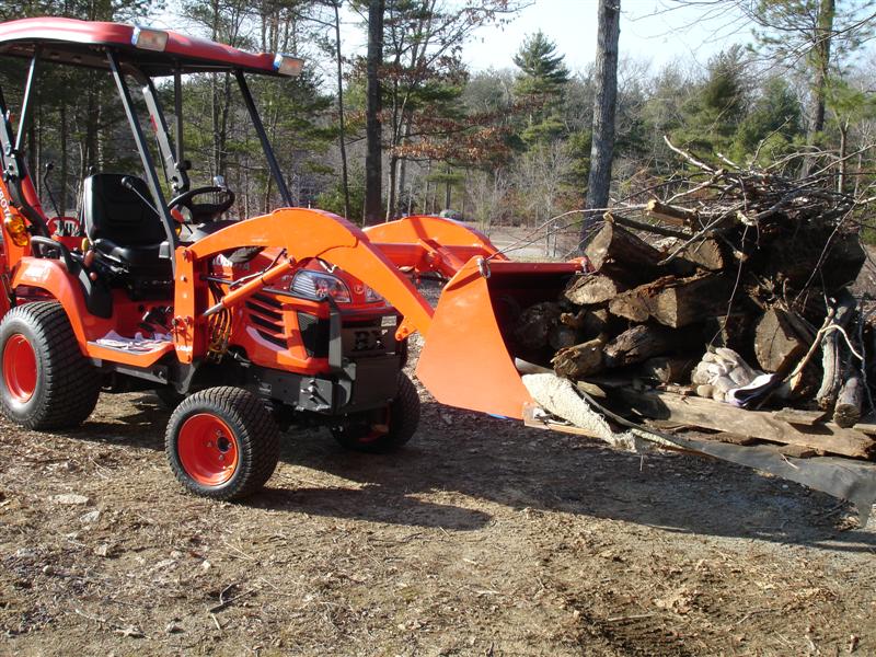

Finally got the tractor out of the garage for the weekend. We put up some wood for next winter, and started the burn pile for next weekend. I used the FEL carrier to move an 18 year old log pile in pretty bad shape to the burn pile and found the new struts make a big difference. With a heavy load in it over bumpy ground the front bucket and arms used to bounce all over the place like a bobble head doll, and sway from side to side like a hula girl.
The loaded tires and the addition of the struts have really smoothed out the ride. Once in a while a crazy monster garage idea actually flies.
