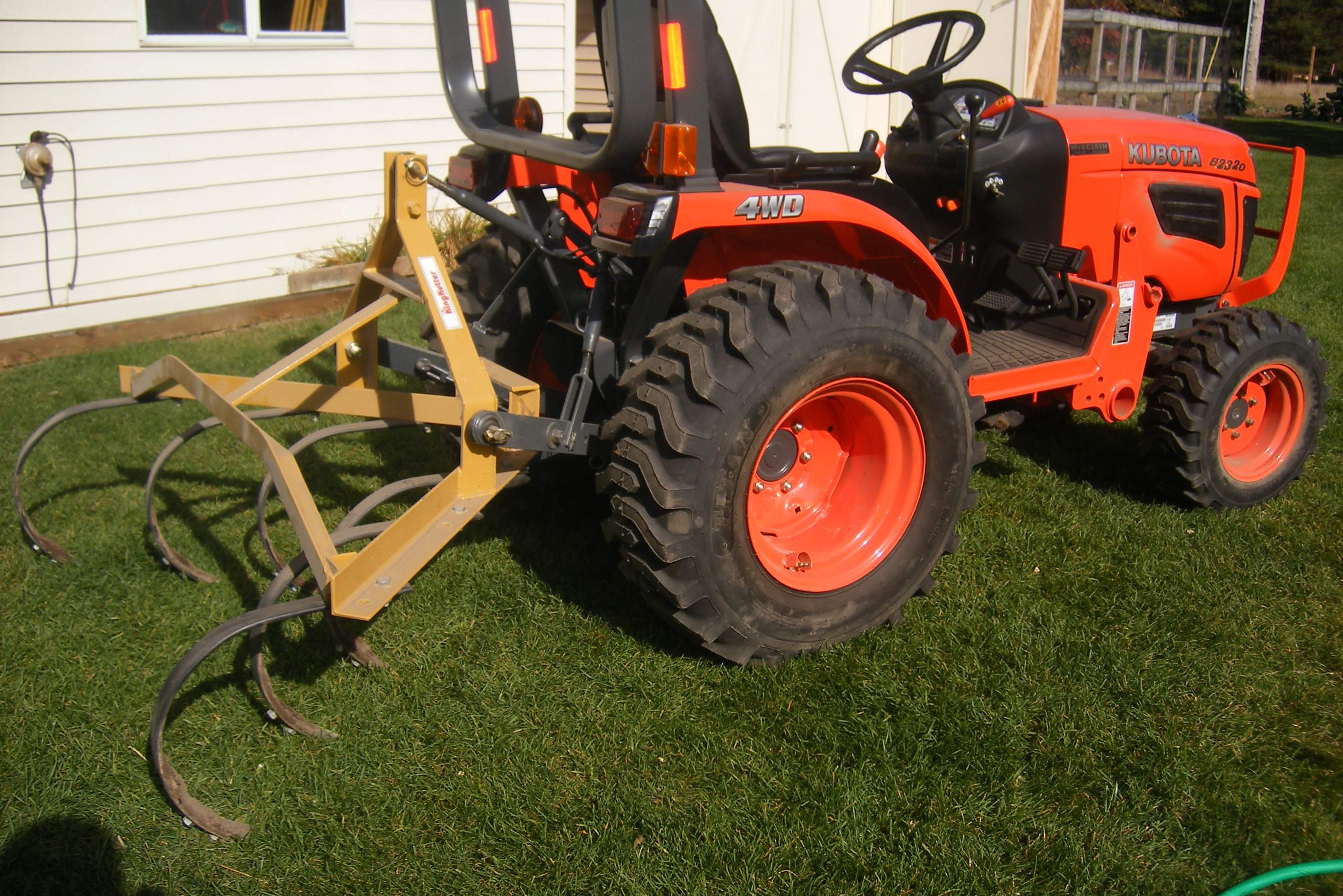

My first potato plow/middle buster was a yellow one from TSC. Since they had many OEM's back then, it is hard to say, but it was far too long in the shaft and I couldn't transport across even slightly uneven ground, Went back and got the orange one and I've worked it every since. Love it.

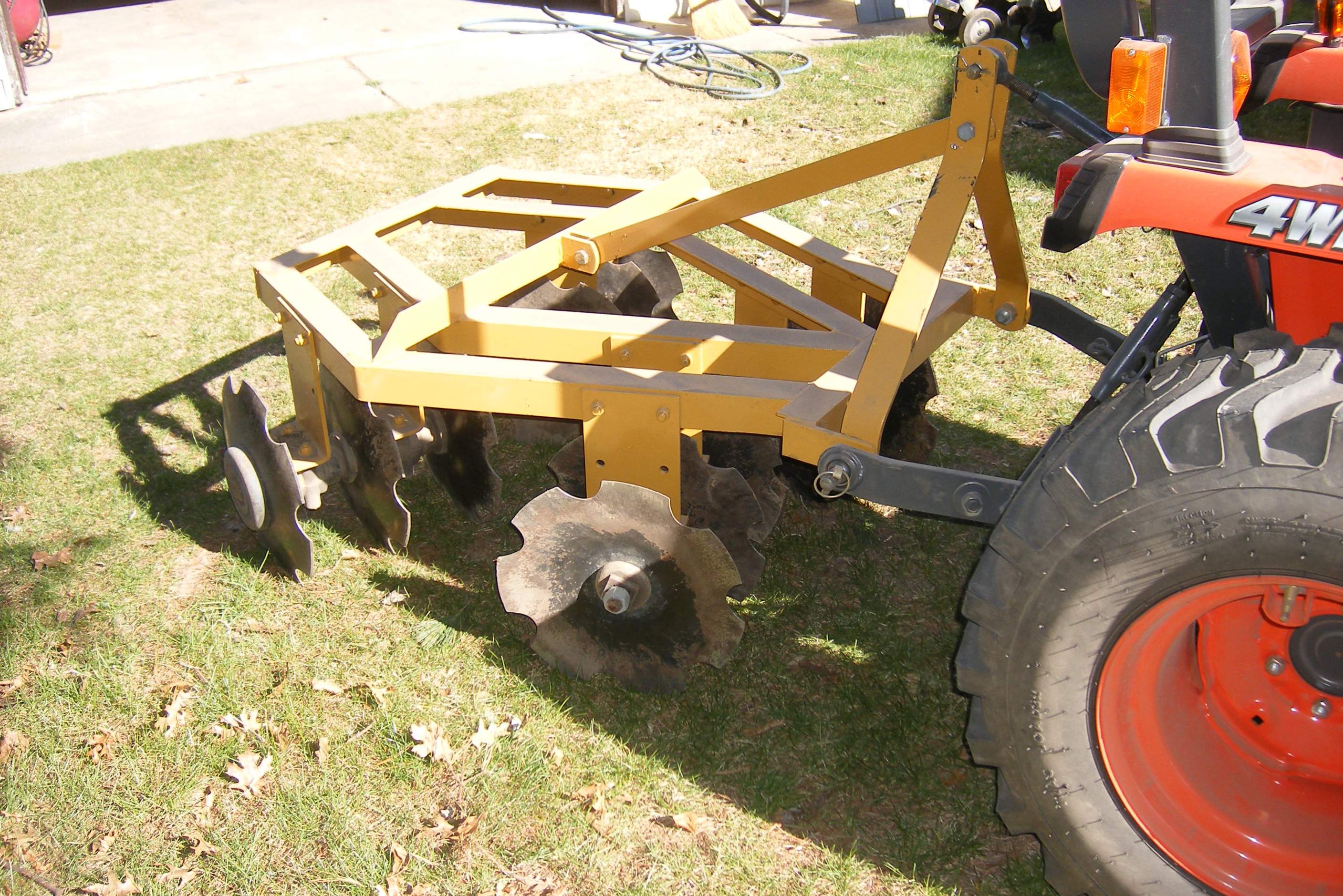

Bought the King Kutter single row cultivator. I found there were a piece of iron extensions, built into the frame that interfered with the lower arm stabilizers and bent the crap out of them. The solution in that case was to cut those 2" "ears" off with a hack saw and it worked, although it's fitment was better with the B2320. The disc, as I said earlier, has 16" cutting disks so it's design is simple too high for the BX.
With the higher B2320, there was never much doubt, but with the BX's you just have to evaluate each implement and see what's what.
