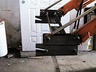

I mow with the loader on but i remove the bucket with the bracket i made. less trouble than finding a spot for the whole assy.2 pins and the bucket(or my other attachment0 is off.
