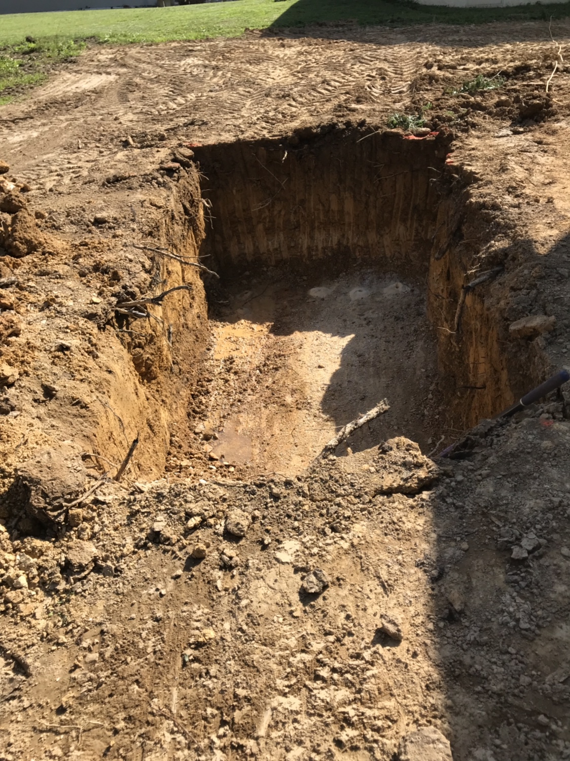

Roll the bucket all the way back and move the machine so the boom is about 3/4 of the way extended and dig away. I don’t see how having the bucket on backwards would help. IMG_6942.JPG
