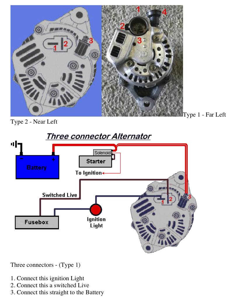

I recently put a 40 amp alternator on my D600 genset. Got one with an internal regulator. 3 wires hook up and no muss no fuss. Only had to make two spacers, used the original stay (elongated one hole) and the cost was $78 shipped (no core). Did drill a hole in the dash and slipped in a $2 indicator light. DB Electrical
Seems easier than spending $200 on a whole goods kit and still having to mess with the wiring harness and relay. :2cents: Battery is at 14.3 volts with electricl fuel pump, 12v radiator fan, kill/run solenoid on and idle/run solenoid on. The original dyno would not cut it.
Jim
Wiring diag.
