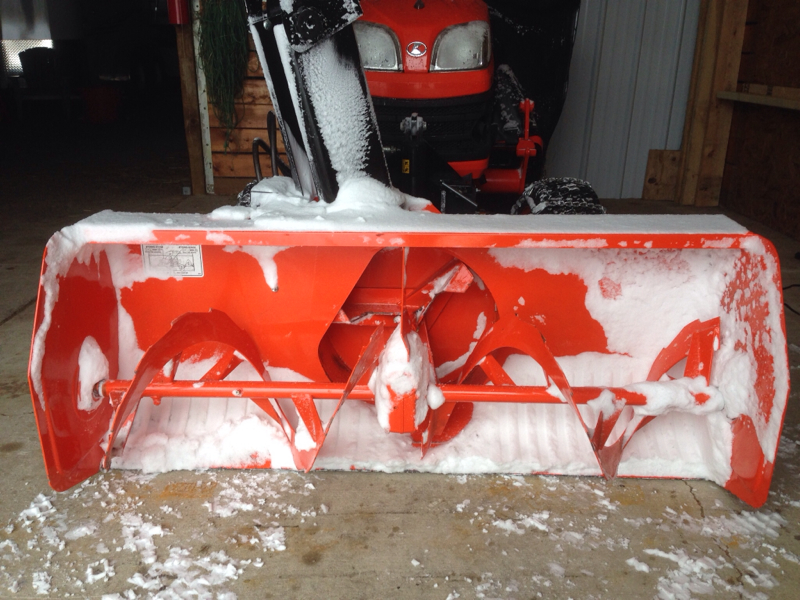

I have a BX2750 and have noticed a change over the years.
On the back side of the blower ( behind the auger) there seems to be an increasing build up of snow. When I first got it it stayed clean while blowing snow, but the last year or so the has been a substantial build up.
Question: Could the auger be worn down causing higher clearence in the back ? If so should the auger be replaced or is there a kit to attach to the auger to take up the space and keep the back clean ?
The edge of the auger has little raised sections that have a shiney edge to them.
Thanks
/ BX 2750 #3
The gloss finish to the original paint eventually wears down and allows the snow to stick.
Best solution- spray the whole blower with Fluid Film and nothing will stick for multiple storms. You could also choose to apply an automotive wax to that area.

My 2750D is about 3 years old with about 15 hours of actual use. I use it on a paved driveway so no gravel. I have always had some snow buildup between the auger and the housing, maybe 1/2 to 3/4" thick. It does not seem to be getting worse and I do not see signs of rubbing/ wear. May just be the way it is designed.
Update, I just went out to blow the driveway. Here is what mine looks like right after blowing
/ BX 2750 #7
I would do as mentioned above and spray the surfaces with Fluid Film, or Ariens Sno-Jet Spray, or Snow Jet, or wax it. I had trouble with my 2750D plugging up with real wet snow last year and hope to avoid that situation this year by using one of these products. I have 2 layers of Snow Jet on right now and will have a third by the end of the day.
