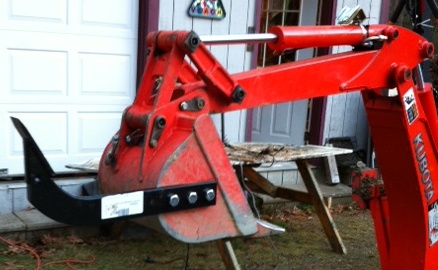

Got any pic's of that set up? Sounds interesting. Curious just how you pinned the ripper to the side of the bucket.
Straightforward... drilled holes and bolted through. It's held well, with no apparent stress at the holes. This shot shows the ripper 'reversed' from what I found to be optimal. Not quite 90 degrees off, it allows bucket use without snagging the tooth, and ripper use without catching the bucket, in most situations.

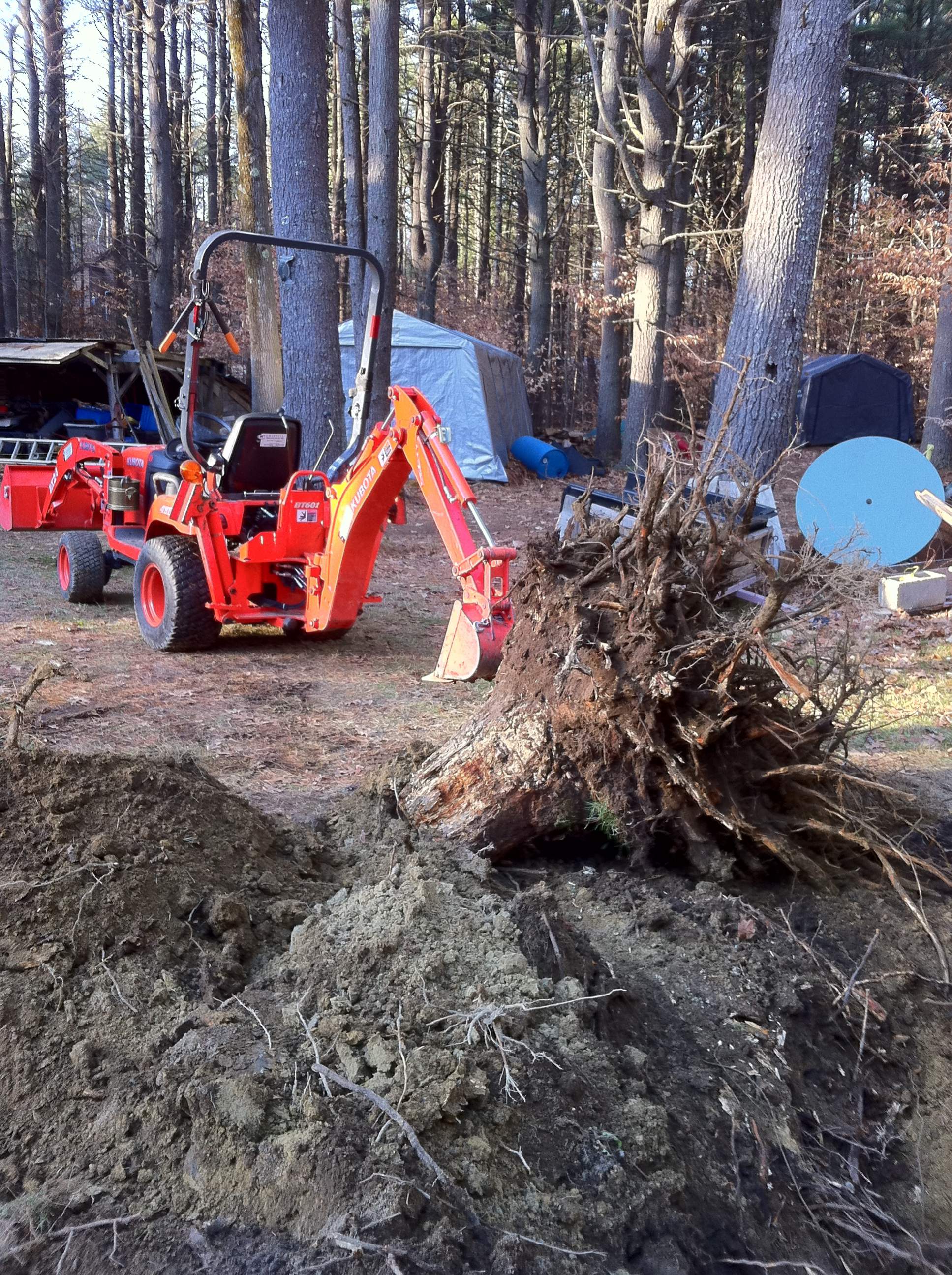

It was very helpful on this stump, too, getting it cleared, then stripping soil from the base to lighten the carry.
Thank you for the pictures. That is not the way I would have done it but I can see your way is better because it allows better use of the bucket.
Nice pic's - thanks. But when you said above "This shot shows the ripper 'reversed' from what I found to be optimal", are you saying you ended up reversing the ripper so the tooth is facing the same as the bucket? It would make sense there's more force applied via the bucket curling toward the tractor since the hydraulic force is applied to the non-rod side of the cylinder.
--- Yes, that's what I meant. I should just take a new photo, but neither the BH nor the ripper shank are attached right now! :)

Yes, with skilled digging and cutting spare roots, I can stump out a larger one than I can lift to carry away - need to roll it or drag it or push it
