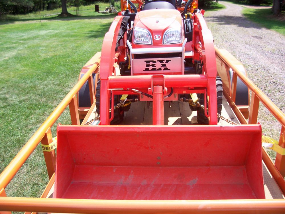

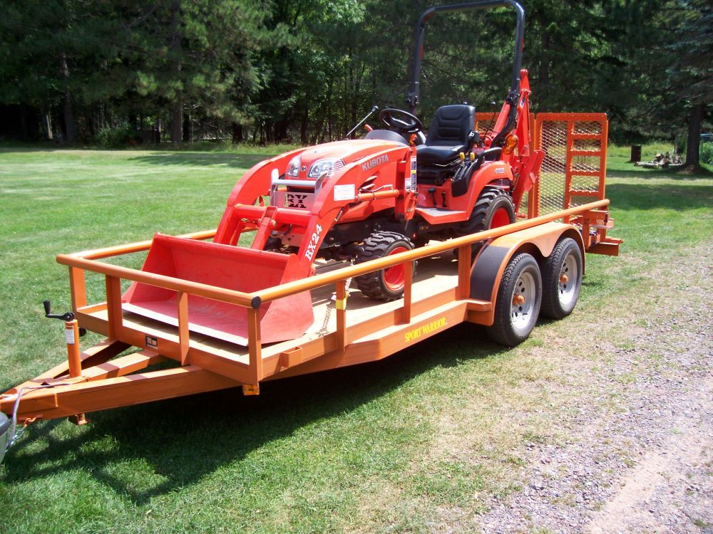

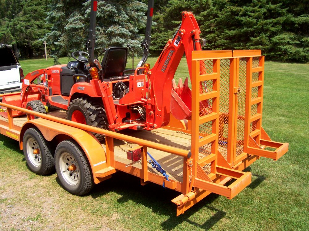

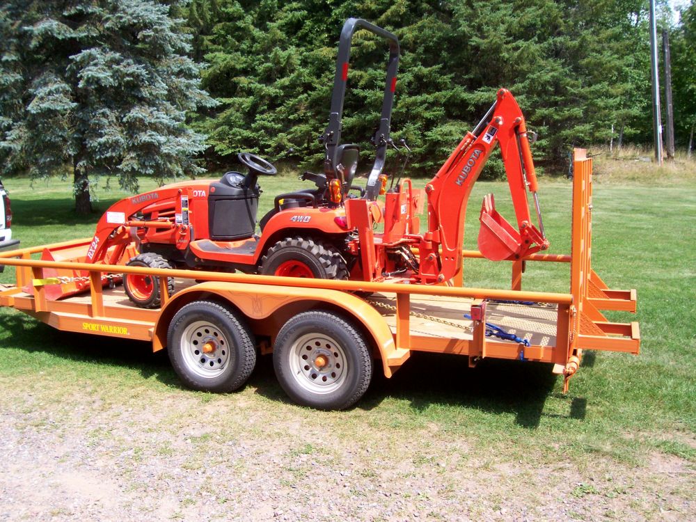

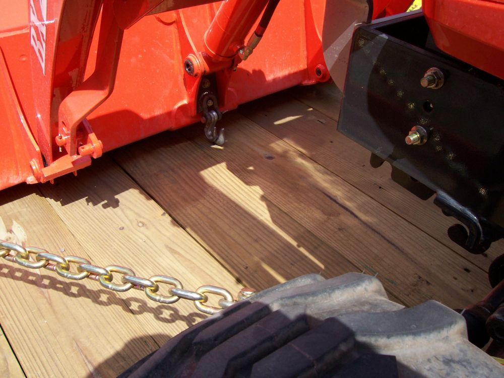

Here are some pics of my new trailer for the BX 24. Actually, the third picture is of a bucket hook, the idea of which I stole from others on this board. I'll provide details if anyone is interested.

Very Nice Looking Set-Up. Nothing like having the right size trailer for the job. Please provide more info...

Great looking rig Dicks!
Need more details......what brand of trailer is it? Where did you get? What it's worth if you don't mind!:confused:

DickS,
Great looking trailer. What's the overall lenght and is it wide enough for a mmm?

I purchased the utility trailer from www.johnsontrailerco.com in Colfax WI. It is 16' long and 5' (59 1/2") wide. Obviously it will not fit the 60"MMM. The trailer is made to order by a company called Horse Creek Mfg. and Fab. in Texas. The ramp is 4', spring loaded, split, and covered with treadplate. It has the 7000# upgrade. Tires are Kendon (China) and I looked them up on the web and couldn't find any complaints. The web site is pretty comprehensive and you can build your own to order and all the option prices are listed. As far as I know, they do not deliver. I liked the 5' wide option because I'll probably not need the trailer for anything wider, it takes up less space in the toy barn, and all tie-downs can be installed standing alongside the trailer rather than crawling around on top of it. You can see the tie points in the pictures. That's a big plus for us creakers. I also selected the utility style as opposed to the car type or bobcat hauler because of the rail that goes around the trailer offering unlimited tie down points.
Anything else?

I also like the "bucket hook". Please elaborate. That's a wonderful addition.

The hook mounted on the bucket is placed between the bracket sides in the middle of the bucket. I don't remember the exact dimensions but 2-1/2" X 3-3/4" of 1/4" steel flat plate with two 5/16" holes seems about right. A 5/16" anchor shackle is welded to the plate between the holes and bolted to the bucket with 1" bolts. As I mentioned, this is not my original idea; others have fabricated differently based on the type of equipment but the principle is the same. Some like to place the hooks on the ends of the bucket but I didn't want to stress the loader this way. My preference is to keep the load centered but I'm sure more skilled operators could argue otherwise. Where I live in the UP of Michigan, downed trees are not uncommon. A chain around the tree and attached to the grab hook works great. Just keep the bucket low when backing up to pull anything.

I keep trying to locate a nearby source (New Mexico or Colorado) for the trailer located in the first post of this chain. Does anyone have any current info on trailer or something comparable. I checked out the website that DickS provided but and they seem to be the exclusive dealer for these Sport Warrior Trailers Tandem Axle Utility Trailer, Johnson Trailer, Colfax Wisconsin trailers
And if DickS checks in, what is the bed width of your trailer 77 inches or 83 inches. Also, what length is your trailer. That is a sweet trailer rig.

Would it be possible to post a few more up close pix of your hook set up?

Just comment.
In NH (not sure about other states).
The bucket should be down with a chain over it. At least that's what my dealer told me when I picked up my BX24.
P.S. Did that hook require drilling or welding? Interesting spot.

The main thing i don't like is the is the rail all around the trailer =makes it imposssible to load skids/pallets from the sides.

May I second the request for close up photos of the hook ? I'd like to post one on the BX Wiki site.

Thanks for posting the details and pics of that trailer. It confirms my thoughts that I could squeeze a BX24 onto a 16' trailer without many problems.
I'm also curious about mswlogo's comment "In NH (not sure about other states). The bucket should be down with a chain over it. ".
*Would that be for safety? E.g. a chain over the bucket is more visible than one at ground level, and less likely to trip someone?
*That's to hold the bucket in place /has nothing to do with a trip hazzard.
