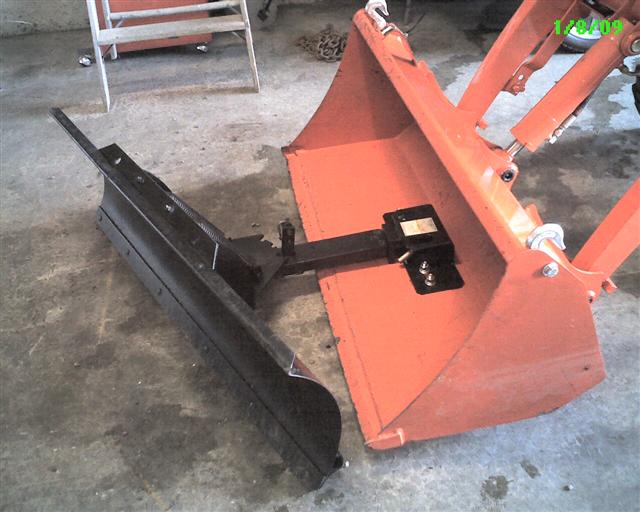

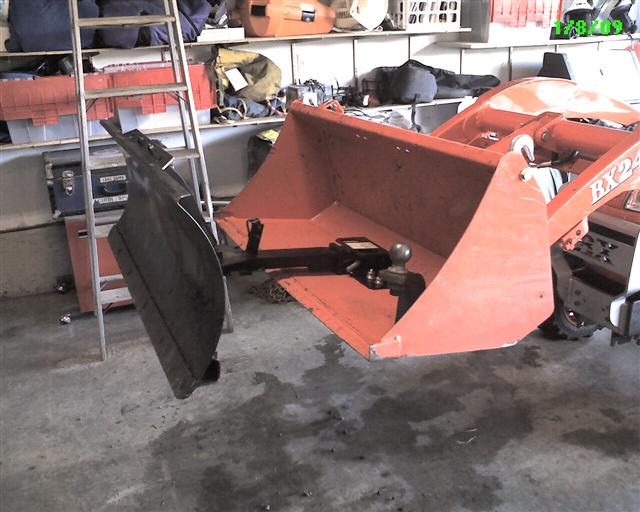

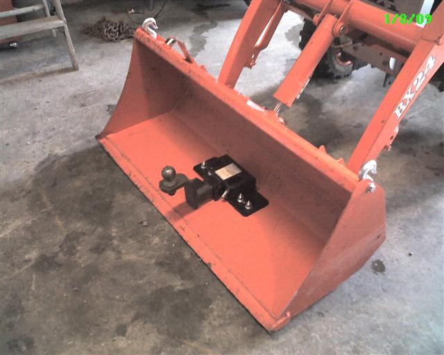

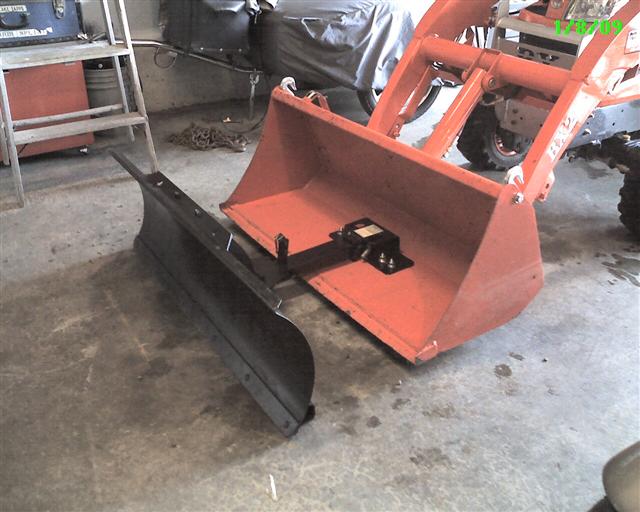

Here's what I'm using.

Looks like that would work pretty good. But I think I would clamp it down to the front edge some how.
/ BX-24 Snow plow blade #3
Interesting configuration...Has it worked well for you? Does any snow get past the blade and into the FEL?
Don
/ BX-24 Snow plow blade #4
where did you get the blade set up and what was the approx cost?
The blade is 54" wide If I remember right. I have $25 for the blade at a g-sale, 20 for the receiver, but that also lets me move some my trailers around, and a bottle of Jack for the welding. So total $45. Didn't get it done untill after the snow left. Just waiting for another snow storm to try it out. I have pushed some horse sh*t around the field and it worked ok. I'm hoping it works better then the FEL for pushing snow. At least this way I can push it to one side. I also have a 48" back blade and it worked great when I could keep traction.
/ BX-24 Snow plow blade #8
I'm not sure if this would help but I have seen several plow's for sale at Lowes/ Home Depot (on clearance) $149.00 48-54". I have a feeling they are for smaller tractors but with the right support and bracing I'm sure they would work! Great excuse to buy a welder!
