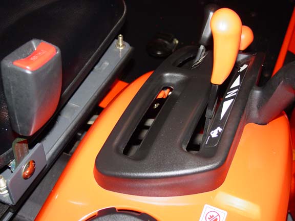

OK, I'm stumped. I've looked at it repeatedly since getting this machine not knowing what it might be for. Then a neighbor asked. There's an additional slot in the right control area. Possibly for a remote hydraulic control?
photo of said slot attached..

Sho nuff! There's an empty slot on the BX-24 too! Right behind the 3PH lift control lever there is a slot with no lever, no decal! Never really noticed it before. Wonder if this control panel is used on another model with another control?
/ BX-2350 Whazzat? #4
Looks like the cruise control on the 1830/2230 from the other model pics. I have the 2350 as well...blank.

Could be for a rear hyd connection like a hyd top link. I wish I had a hyd top link.

That is incorrect. The levers on the left side are pto mid/rear/mid-rear and pto engagement. The levers on the right are 4x4/hi-low gear/hydl lift-lower control. The empty slot on the bx1830/2230 and 23 was for cruise control. Maybe the intend to install this on the bx 1850/2350 and 24 series down the road.

I imagine it is for rear remotes. If you don't have rear remotes, you don't have a lever there. My L4400 has room for two. I have one set of remotes so one slot is used, the other is empty.
/ BX-2350 Whazzat? #15
When the first BX came out, Kubota had not considered cruise control. Quite a few of us e-mailed Kubota re. cc for the BX, and as an afterthought, they designed a cruise control that could go in that slot (Kubota Parts item No. BX7340). There are others who have put control for rear remote in that slot. When later models came out, the cc was redesigned and put in a reasonable location.

On my BX23, the female seatbelt connector comes through that slot. I was told that was because of the limited clearance between the swivel seat and fender.
And if I remember correctly, the older BX's ( 2200, 2230) that is where the cruise control lever was installed.

The empty slot is for the BX7326 auxilliary valve package - two circuits. It will flow 3.7 GPM total (at rated engine speed) with a i778 PSI relief.
This is intended for the BX1850 and BX2350 - earlier transaxles are packaged differently, so I don't think it will fit.
