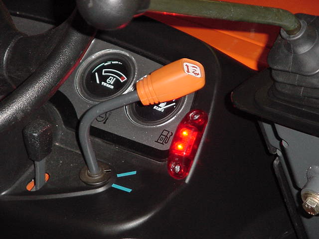

Well it did not take long to forget the park brake was on and drive around a little while /forums/images/graemlins/mad.gif so I made a little mod to my machine.
A small micro switch mounted on a bracket just above the brake pedal bar under the floor pan. and a Red LED light from Wal-Mart and some scrap wire . and WA LA No more burn up the brakes. Have pictures /forums/images/graemlins/grin.gif

That is nifty, especially since I drove around for about 20 minutes today with my brake on. Which is not the first time I have done that.
Where did you buy the micro switch? I live in a small town in East Texas and if I ask someone for a "micro-switch" around here they will ask me if I need it to beat a Chihuahua.
Bill Tolle
/ Bx 23 mod Parking Brake Light #3
Nice mod... I also have driven with my parking brake on. Could you provide some pictures of the switch and some details as to where you hooked up the wires.
John
/ Bx 23 mod Parking Brake Light #4
Yep, me too ... 'course if the brakes actually held Baby, I don't think this would be a thread. I learned quickly to sink some attachment in the ground if I really needed to keep it parked. You've got a great mod there and to preserve what little parking brake Baby has, I'm anxious to do it myself ... and the previously mentioned request for details would be most helpful.

Using the marker light was a good idea. Leaving the brake on is truly the most common mistake we make.
Radio shack usually has some micro switches if anyone is haveing trouble finding them.

more pics please.....

I know my profile says new member but I've been around on and off for a few years now....anyhow my point is I had the same issue with my bx2200, and did the same mod right after I got it, a small metal momentary toggle sw hooked to the brake pedal via a spring. Somewhere in the history of this forum are the pics of my mod, If I get the chance I'll snap some new ones and post. Mine has been done for three years and over 300hrs in all kinds of mud, snow ect and still works great! I think the issue with the brake is that the engine and tranny are powerfull enough to overcome it, don't forget it's a wet system, not dry like a car, so they will slip if forced. I'm just getting ready to do all fuilds and some general maintance and I was thinking of checking the adjustment on my brakes...since I'm gonna have my face under there and all! /forums/images/graemlins/grin.gif
