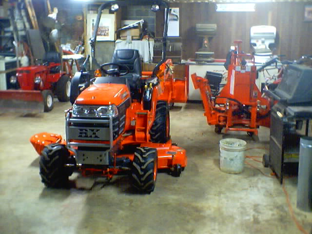

</font><font color="blue" class="small">( ............. I will let you know for sure in a few month since I bought a 2230 with a Woods FEL and BH. )</font>
Did you get a better deal by buying the Woods BH and the BX2230 vs. the BX23? What was the reasoning behind this combination? Could you please post some pictures of the mechanism that holds it to the tractor and how easy it is to remove and reinstall? What was the installed price for the backhoe itself? thanks Junk.

In the Woods install manual you can see the full length frame that they add to the BX to support the BH and strength the entire frame. The FEL attaches to that and the frame. After seeing the why the Woods attaches I think its as strong if not stronger an attachment than the Kubota. The extra heft on the BX23 is basically the same points the Woods frame adds tot he BX2230. Kubota doesn't add it to the tractor its already present on the 23.
I went for the Woods loader too since it was a bit stronger and had a few features that I liked more than the Kubota.
The Woods loader was less than the Kubota loader and the BH runs about $4500 or so. I think all said and done, you can buy the 2230 with Woods gear for a few grand less than the BX23.
The BX23 is killer, but I dont think its any better than the 2230 with the Woods equipment on it.
I'm not worried about the warranty issue at all. For a few reasons, I think the install of the Woods is excellent and I dont see it causing issues with theBX at all. Woods would warranty the hoe and Kubota the tractor. If a dispute did happen, they would have to prove that the installation caused the failure of the Kubota part. Hard to do and I doubt they would feel the Woods BH would cause any issues.
