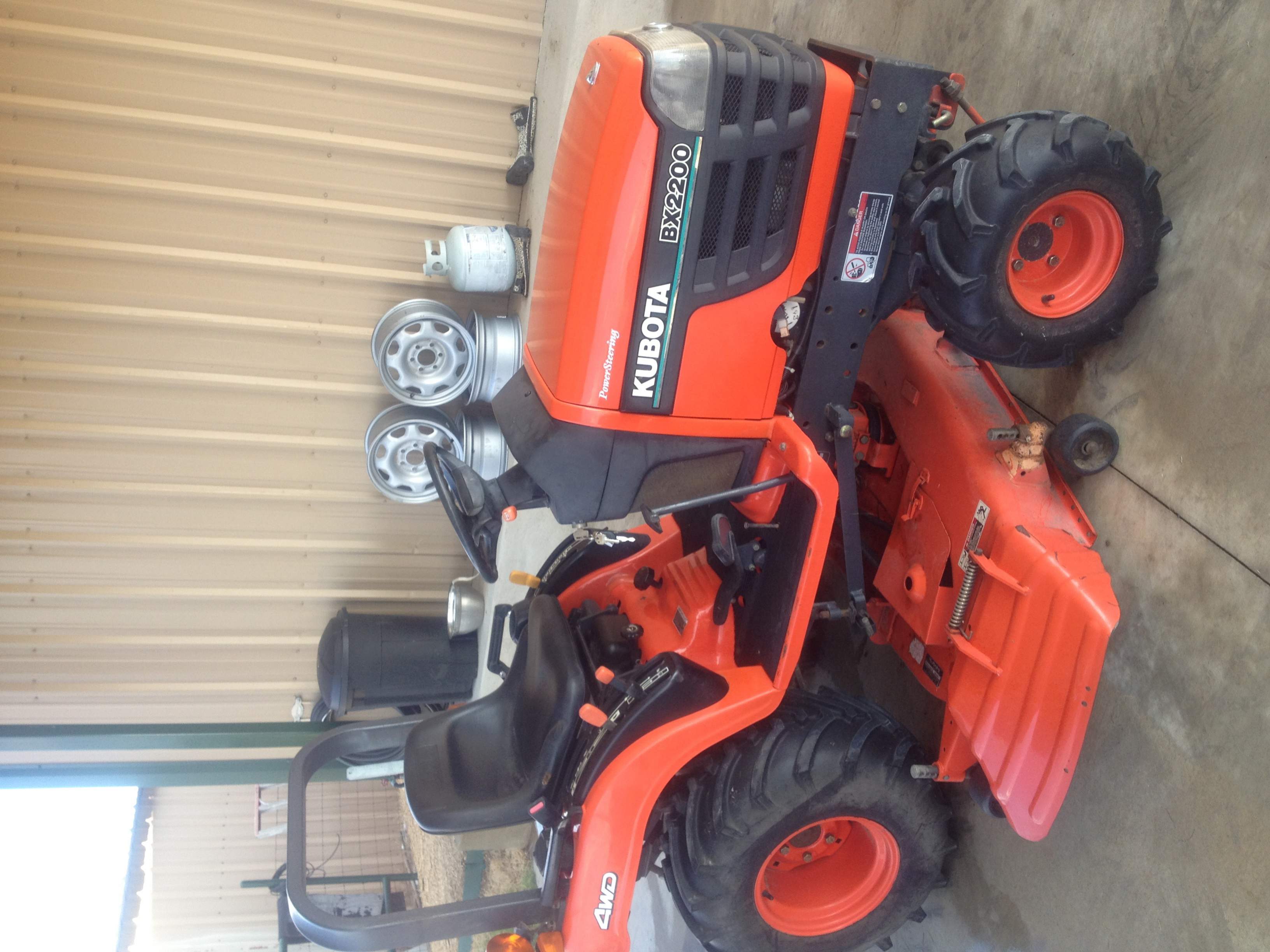

I just bought a BX 2200 and I want to do a complete service, does someone have cross reference for the filters? I could use oil filter, hydraulic filter,fuel filter
