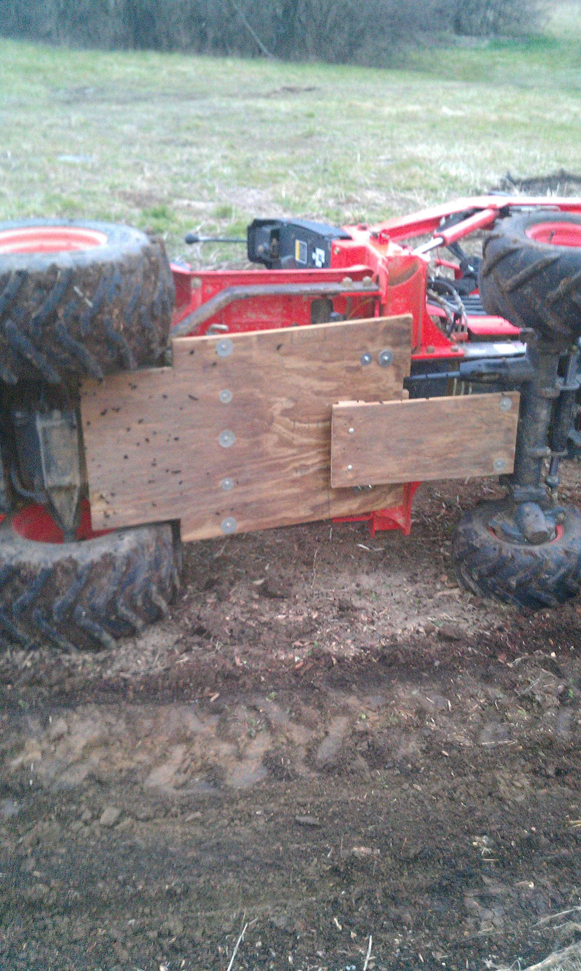

Attached is a picture of mine that I made out of 3/4 inch plywood, bed frame angle iron, and a couple of hooks. It does a good job for us and we do a lot of work in the woods.

Attached is a picture of mine that I made out of 3/4 inch plywood, bed frame angle iron, and a couple of hooks. I does a good job for us and we do a lot of work in the woods.
A.Metcalf
That's a nice stunt to teach your tractor to roll over and play dead like that...

Wow nice work I love how that is connected to the mower mount's
