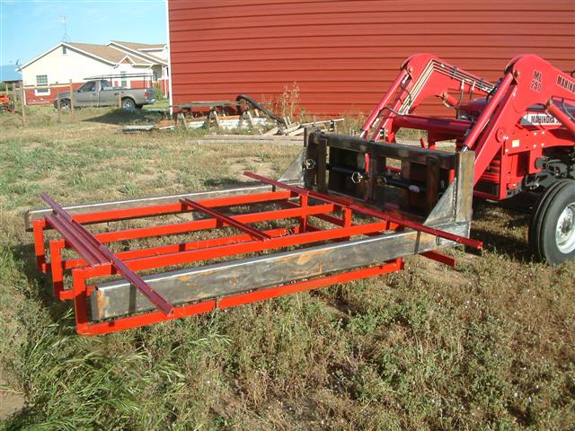

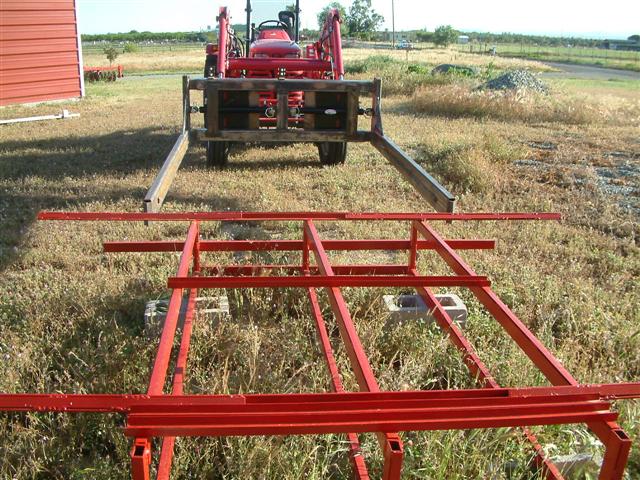

I'm doing oat hay on 6 of my 10 acres and baling with an MF124 small square baler (14x18x35-45"L, 40-50 lb bales). So I couldn't justify the cost of a store-bought bale accumulator/grapple like that Long thingy since my operation is so small. So I built my own combo bale accumulator/bale squeeze
The accumulator rides on the bale squeeze arms and handles 8 bales. Whole thing weighs about 650 lb.
I can stack and move 16 bales with the squeeze. Cost about $1600 for steel and hydraulics. Ran many pounds of 7014 and 7024 weld rod through my stick welder for this project.
