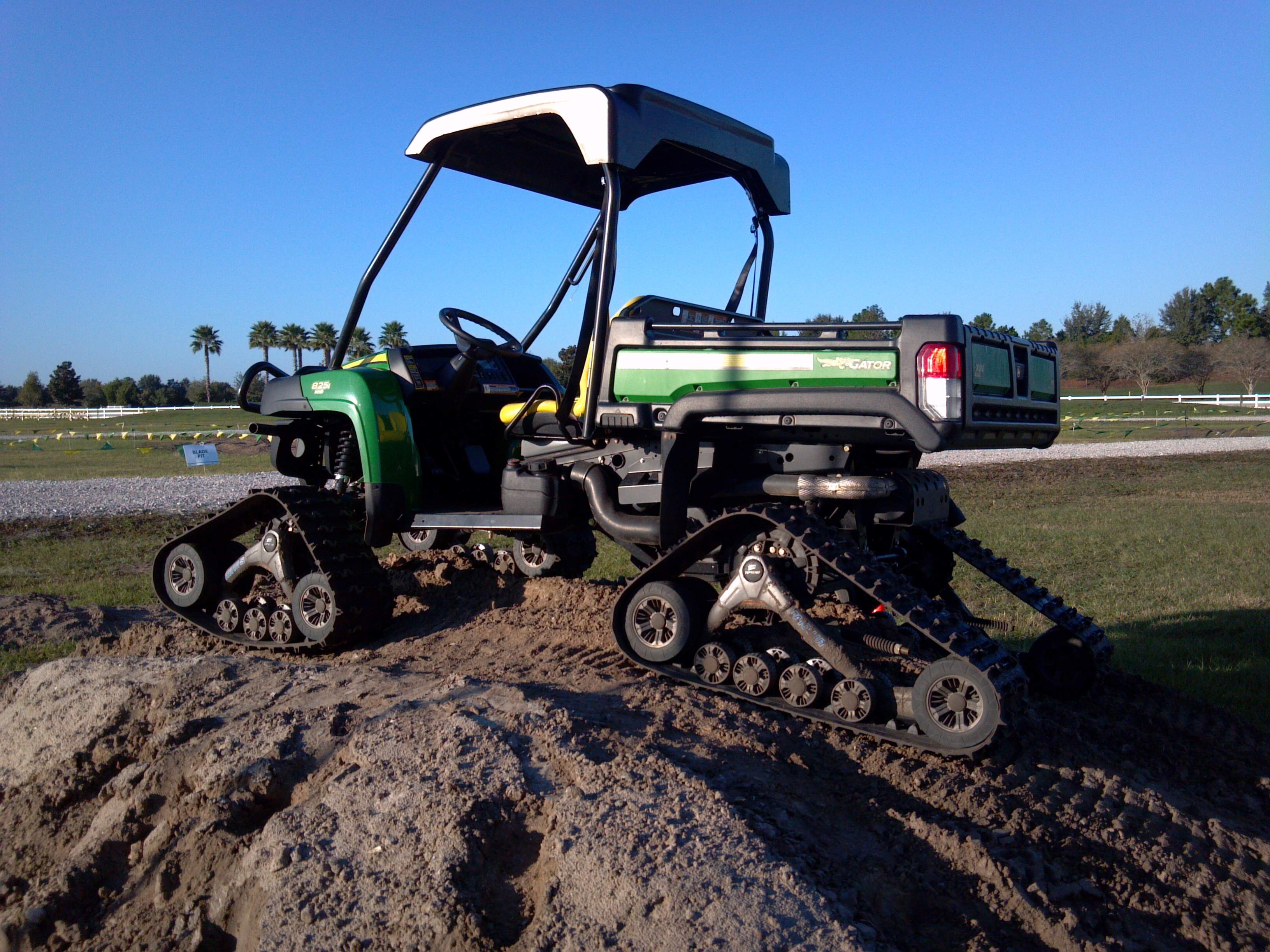

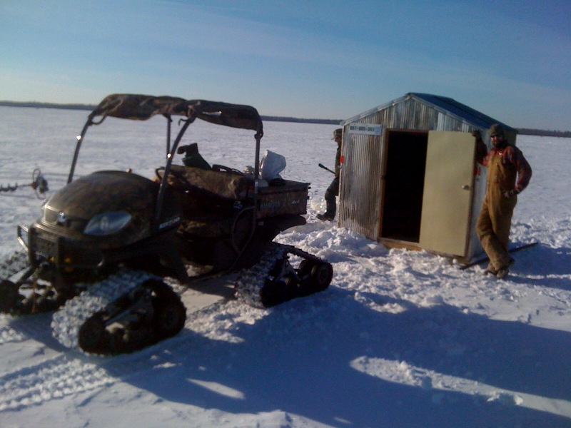

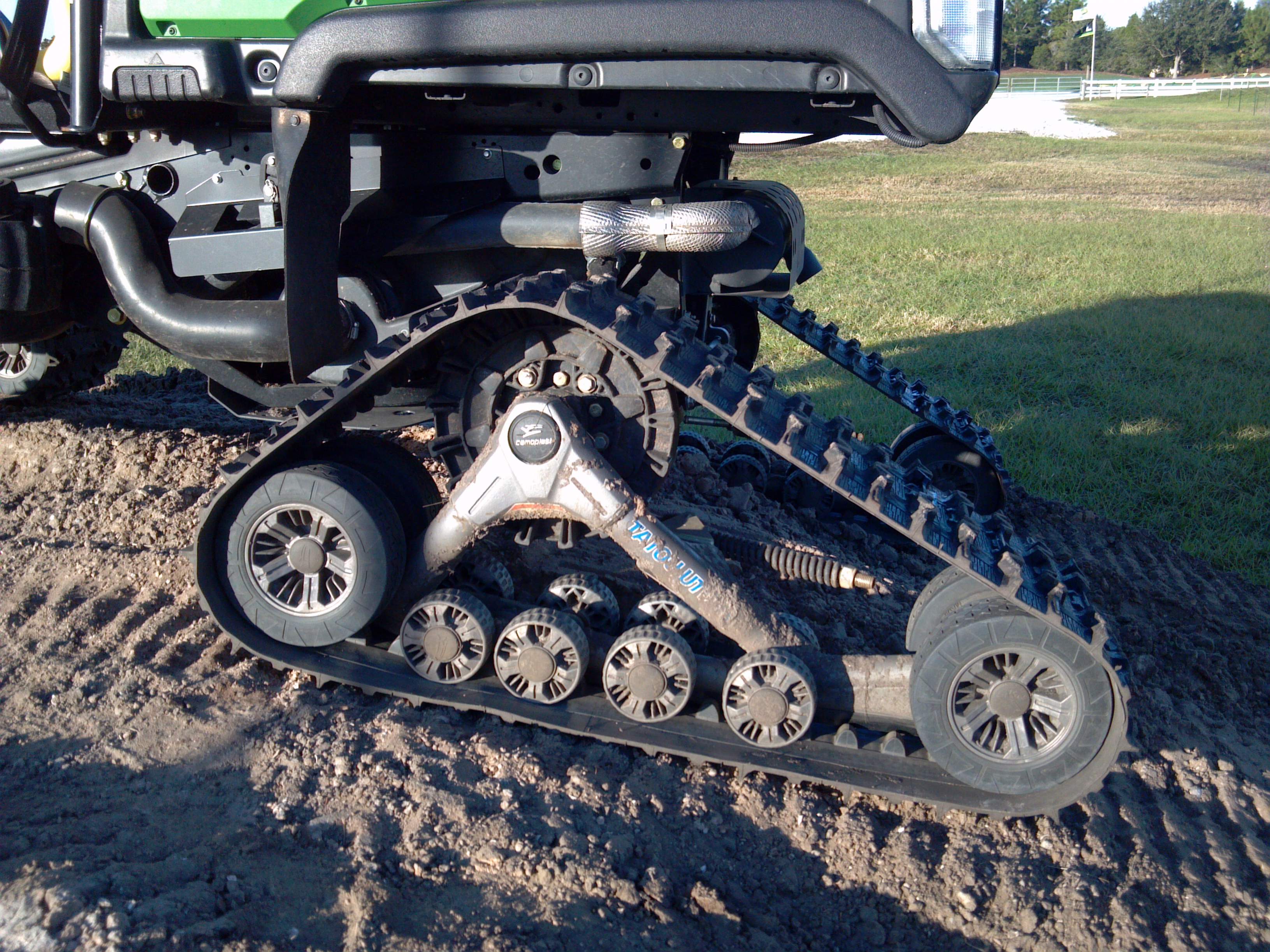

I initiated a post last year(?) inquiring about tracks on RTVs;
Someone said that they didn't like tracks on the RTV1100 because the machine is too heavy- it didn't have the necessary power to perform in deep snow and hills.
But others said tracks were fine on both the 900 and 1100. Since then, I have seen pics of both types on tracks being used successfully at cross-country ski areas and other mountain snow venues here in the northwest.
I suspect that, if you were using it for "work" (not snowmobile-style recreation), you'd be fine.
I believe that both Mattracks (Litefoot) and Tatou make track kits for the RTVs, and there are probably others.
I hope to have such a setup some day.

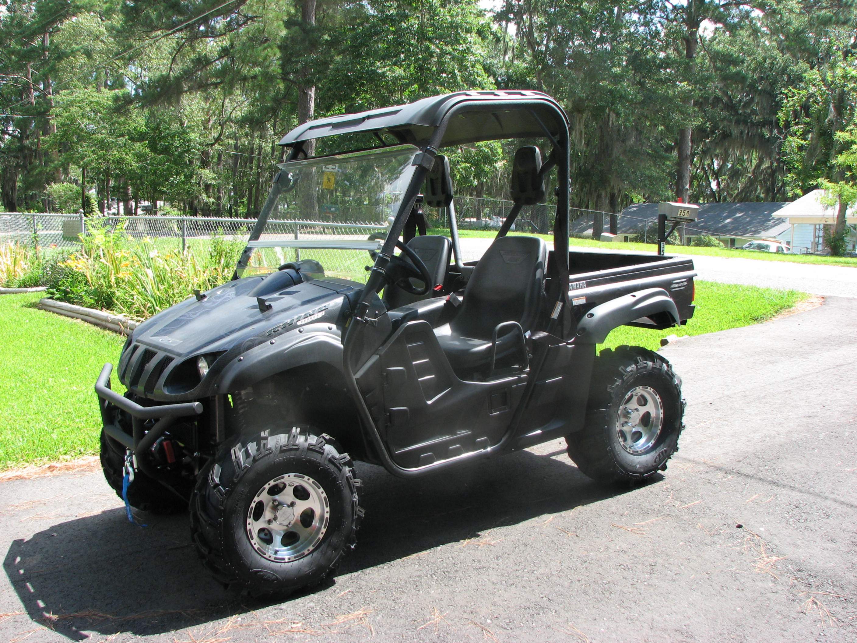

I have a 2008 Yamaha Rhino 700 and the thing is a tank. My son has a 2006 and neither of us have had any trouble with them.
