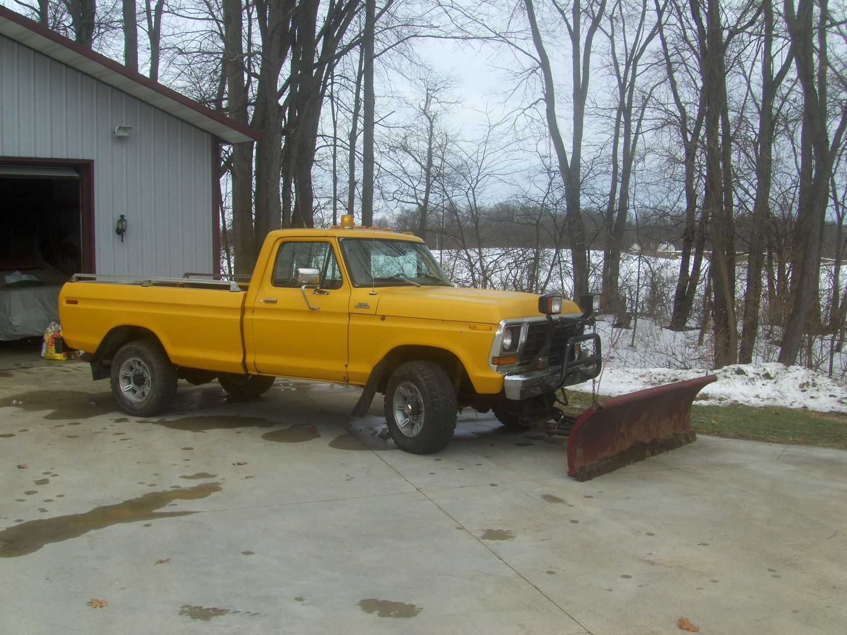

I like the older Fords I have a '78 F450 4x4, owned since new. The Michigan rust is catching up with it :cry::mad:

I love those old Fords. That's a good looking 450! I like the plow.
I've had quite a few of them over the years, at least two of each of the bodystyles. '62, '66, '69, '71, '72, '77, '79, and others I can't even remember. I actually like the "slicks" best, especially the '66, but for actual everyday use I like the Dentsides (73-79) the best.
