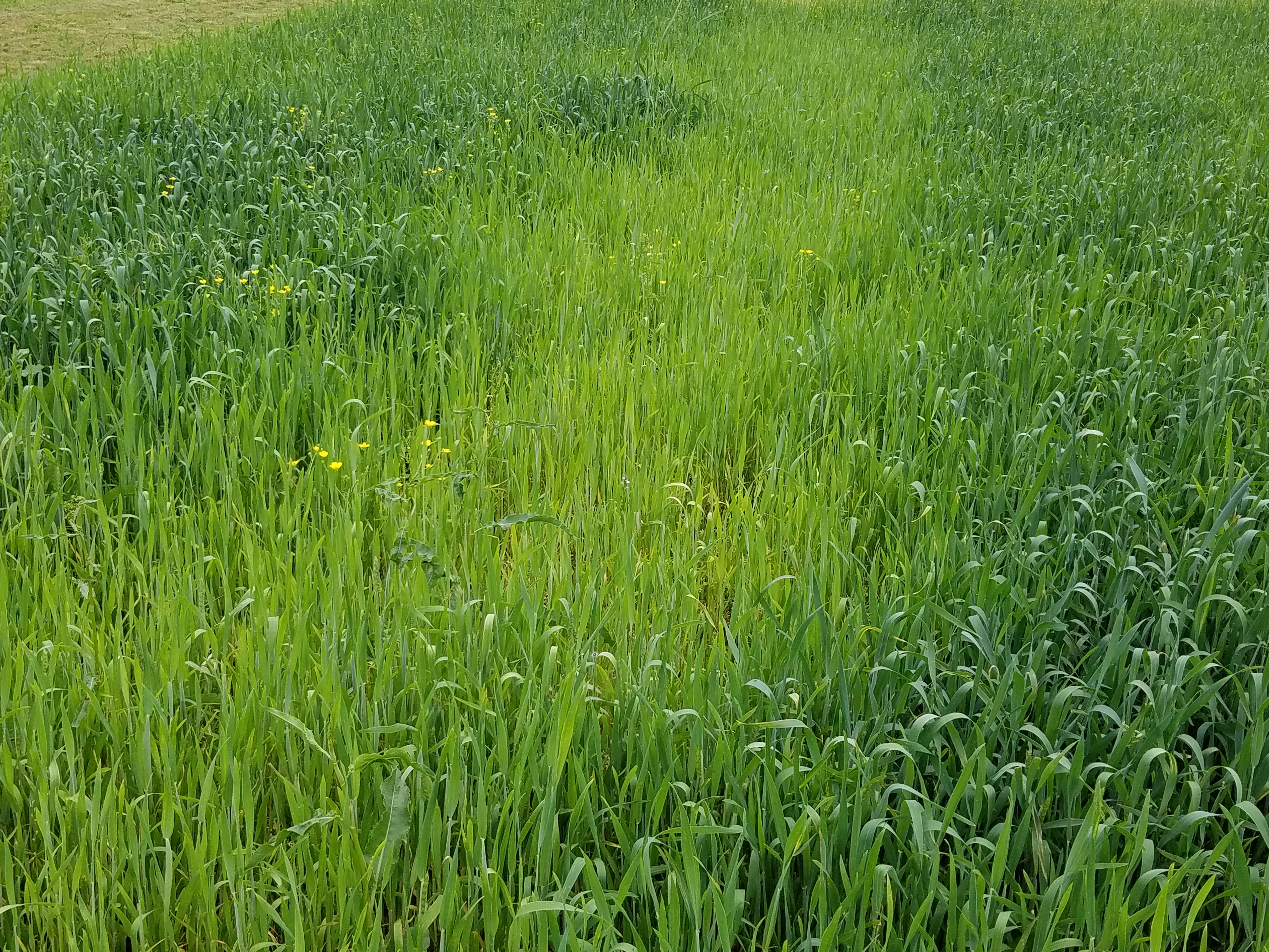

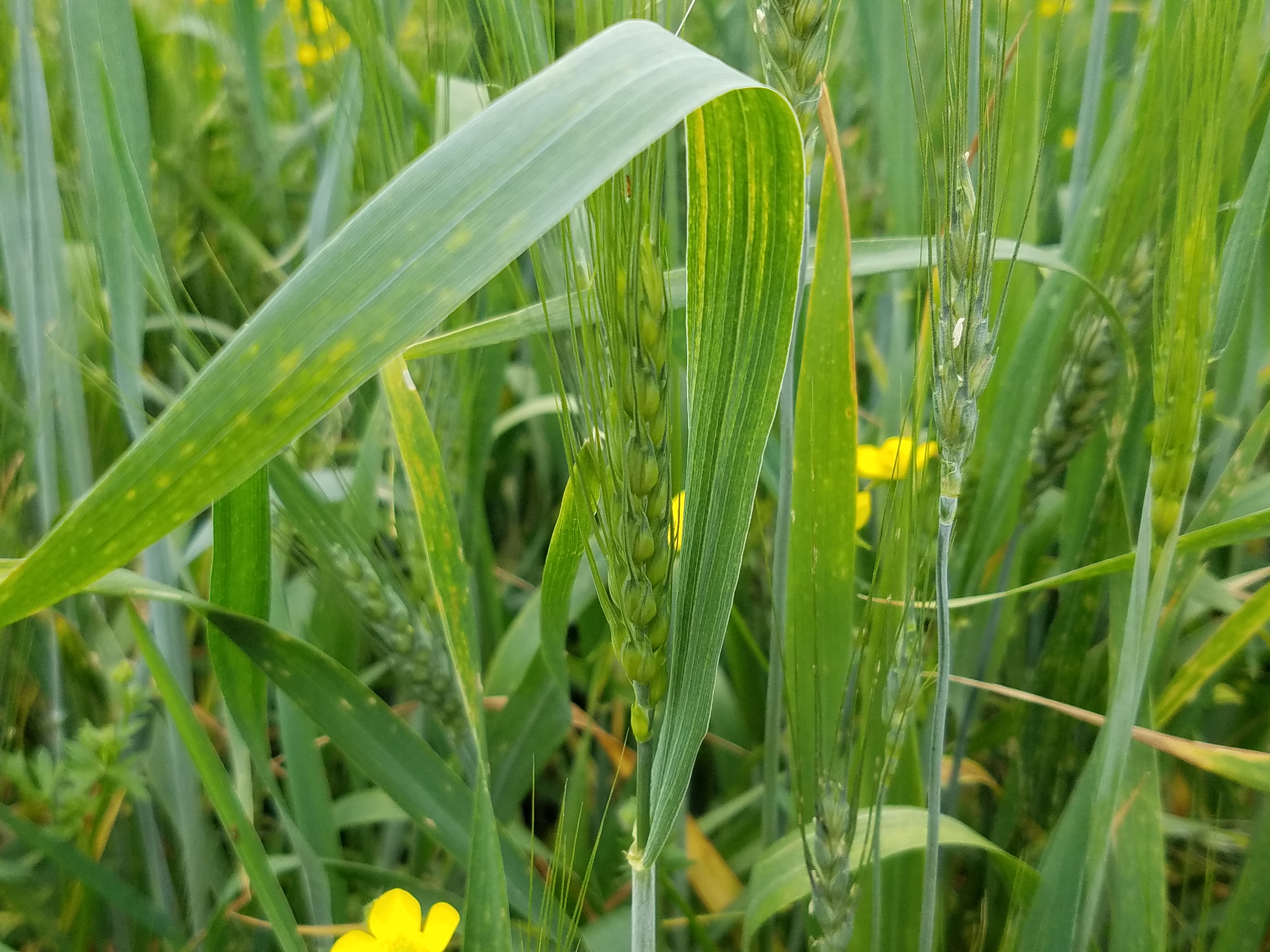

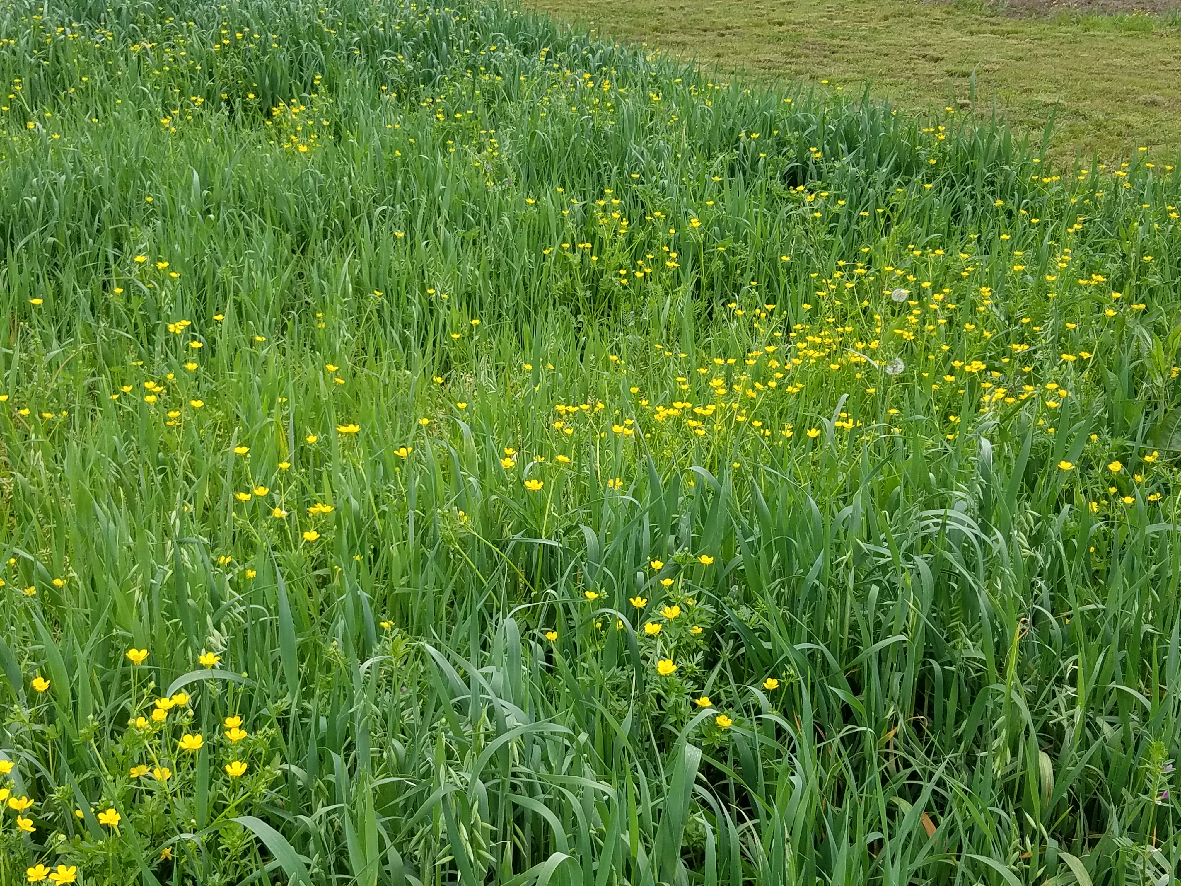

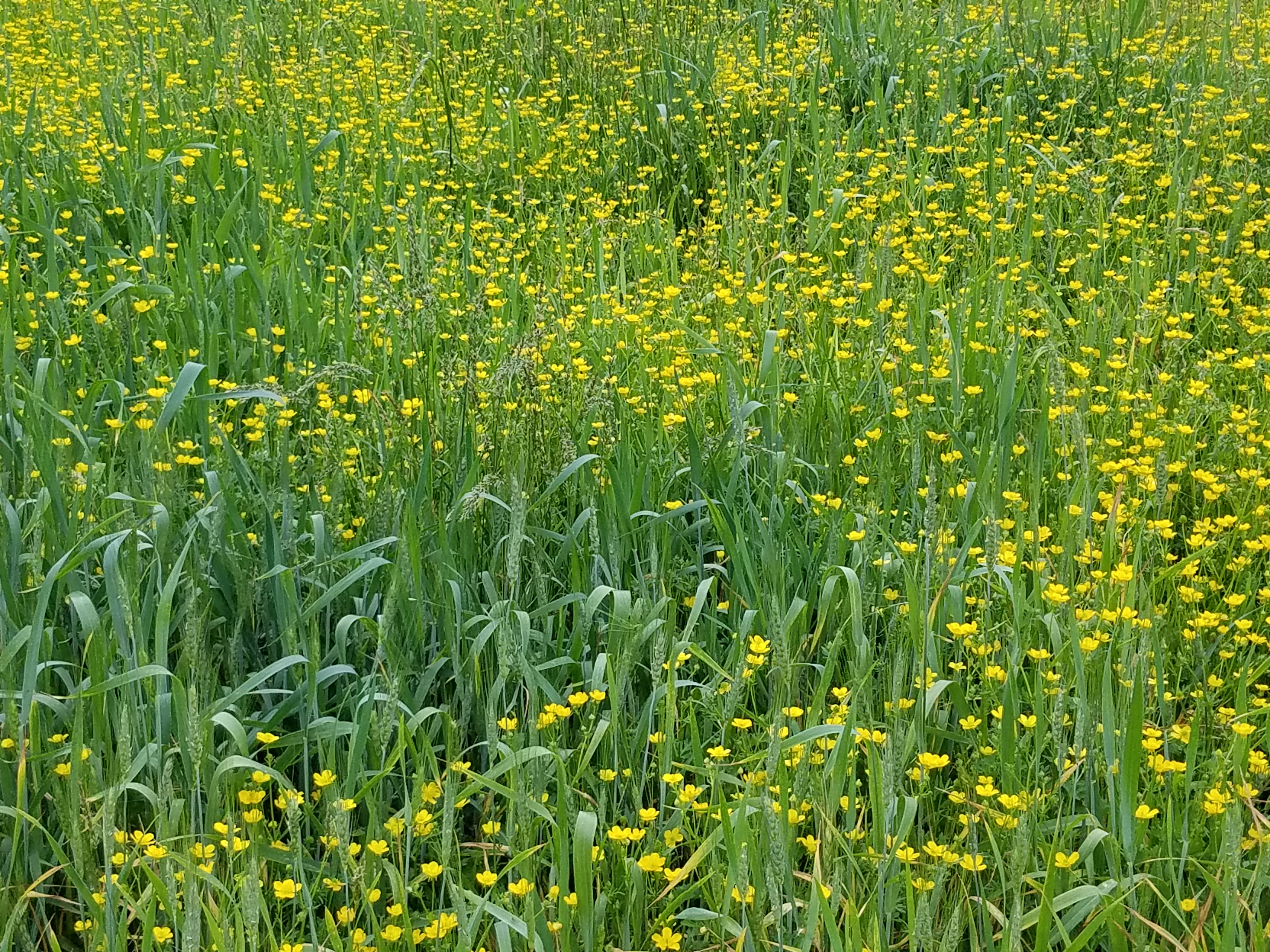

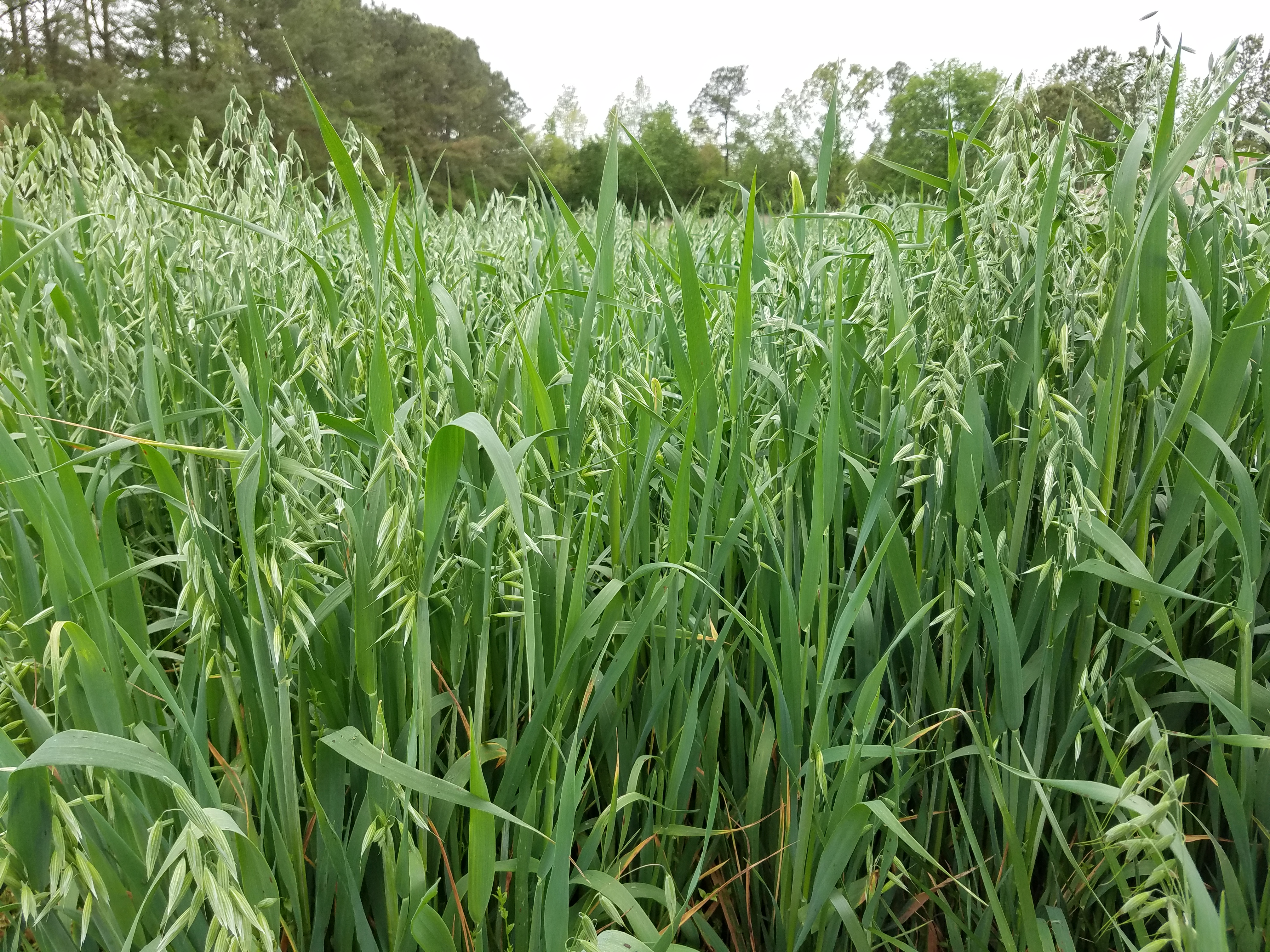

Here are a few of the pics:
This is a pic of the untouched oats in good condition
Here's where the buttercups have been effecting the oats, not nearly as bad as the wheat though.
This is the stage that most of my wheat is at
Here's the seriously infected part of my wheat
This is where the wheats not as badly infected, but does still have some damage.
I don't have much experience with Oats. Well ok none. But now I've seen more than a few wheat plants. Used to do small plot research on it.
From the pictures. Your at Feekes 10.5.1 or beginning flowering. I can see some pollinators in the photos. So definitely too late for herbicides. And without a plant tissue analysts I'd be afraid to recommend any more nitrogen for fear of inducing lodging. https://www.extension.purdue.edu/extmedia/id/id-422.pdf
But does look like you have some pretty good stripe rust and Fusarium problems. Can be stopped by a fungicide application NOW. Fusarium will rob as much yield as the buttercup if not more. As well as providing a fungus that is toxic to livestock. Have a local agronomist confirm this as I'm looking at pictures 10 hours away.
Do you get RFD TV? There is a show on on Wednesday mornings called Farm Journal Corn College. There is a guy on there that specializes in small grains. I used to work with him. Phil Needham. He's a good one to learn from. Travels the world consulting.
High yield wheat is an art. When Phil came to this part of KY the average yield was 35 bushels or less. People made more money from the straw than they did the grain. I've personally been in 120 bushel wheat. Using his management techniques. He came from England, they can raise 150-200 bushel wheat in some parts.
