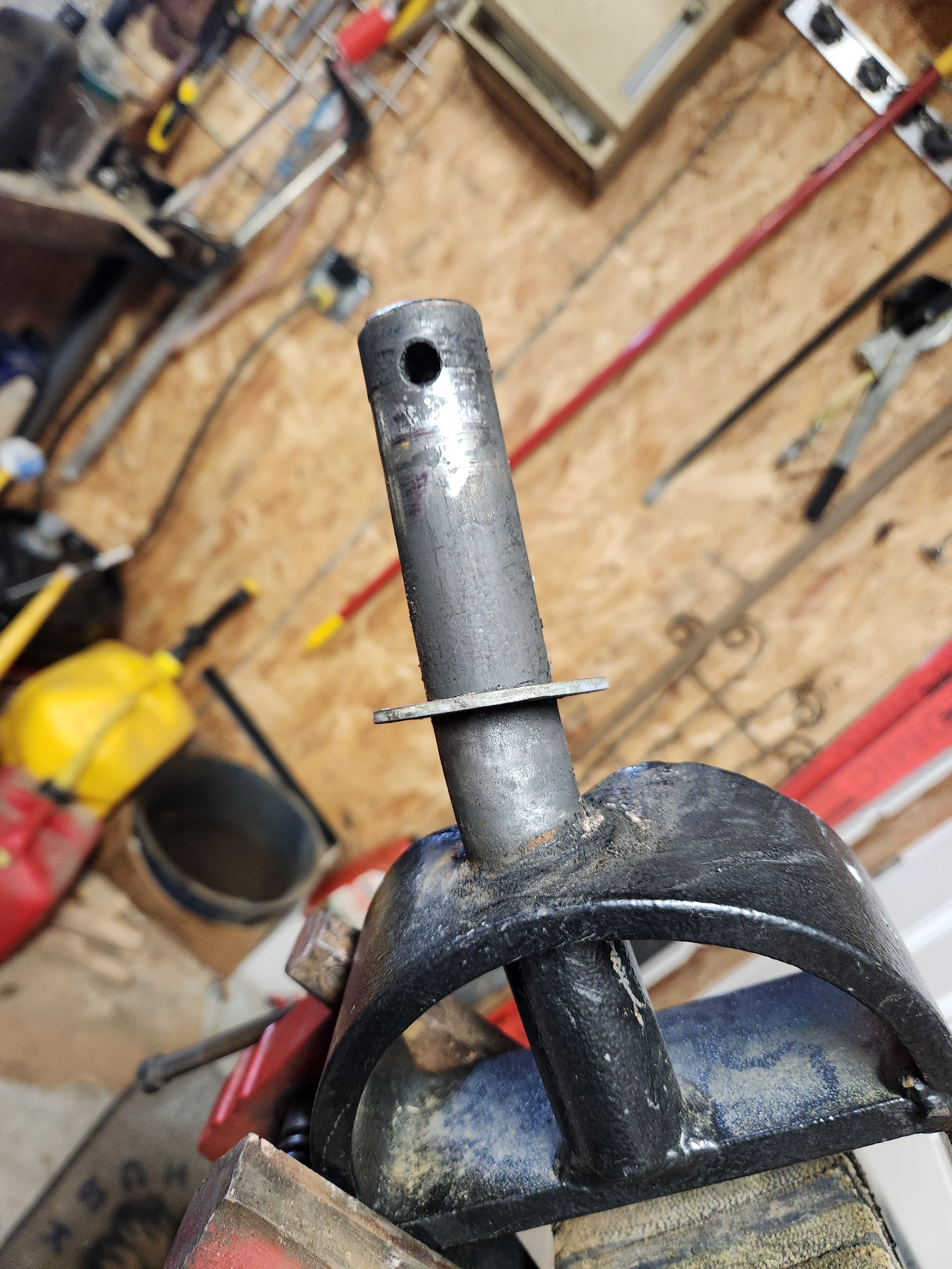

I received a NorTrac brush hog mower with used tractor. I really bent the main post and the frame. I have looked at a replacement, but can't find one that fits, anywhere. Main issue is the post length.
Sending off to a body man with right tools to try to salvage it. Bending an 1 1/4" post back into place won't be such an easy task, considering the design of fork.
I had the same issue recently. A friend of mine who is a fabricator made a new post shaft by turning a steel rod to the perfect diameter on a metal lathe. Then he cut out the bent shaft and welded the new one into the wheel fork.

The tail-wheel vertical pin must be vertical to work properly, and this means the swivel has to be run under load with the deck at some designated height off the ground and with the 3 pt. hitch geometry to support this arrangement. THEN a high caster angle relative to the vertical pin should work. Except, this tail-wheel frame has very little lateral stiffness. Get a welder to box in the front & rear of the U-shaped tail wheel frame. Better yet, make a new one using steel twice as thick. That one looks like it could be straightened by hand with a pipe wrench.

This will take effort to straighten, reinforcing and welding to strengthen to probably break elsewhere.
Whose tail wheel assembly are you referring to? If it's mine, it absolutely can't be bent by hand. The frame is about 3/8 thick, post 1 1/4". Body man said heat and frame machine is what he is using.
