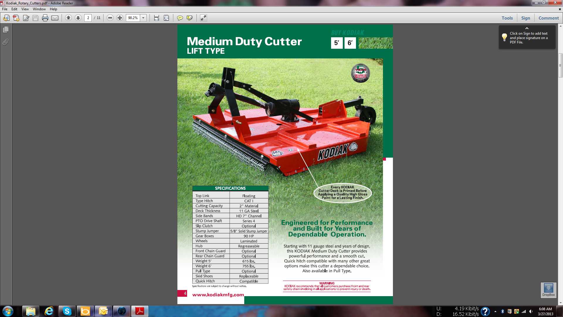

If Western Kentucky is not too far to drive, I changed tractors recently - allowing me to go from a 5 footer to a 6 footer. I was not offered as much in trade as I think it's worth, so my 5 foot Kodiak MD60 is available. It's as depicted in the attached page; with optional slipclutch, but without chains. Didn't want them, cuz chains on a previous RC clogged and tangled badly. Only been use two seasons for pasture maintenance, so the blades don't even need sharpening yet.
You should be able to get rid of the privet without damage to the underlying grasses with 2,4-D
//greg//

I have the same Kodiak mower and it's worked out great for me. I have no complaints.
