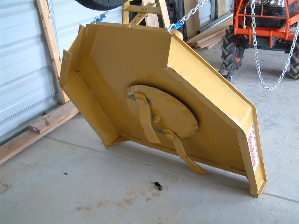

So, I used my brush hog for the 1st time recently; everything worked as expected. (Actually, far more compressed/caked grass into the left wheel rim cavity (around the hyd. motor) than expected.) I searched the forum for any mods anyone had made to brush hog to add safety & convenience to the left-rear discharge; didn't find anything...
I was thinking of adding a soft and flexible band (like a thick rubber) of some sort. That would probably work well for 'soft' material such as grass & brush, but certainly not for rocks and/or blades! The next idea I have is to weld flat bar (relatively wide) at a 45deg angle from the top down, until it reaches the same height from grade as the sides of the deck. (A rubber band could then be optionally added to reach down to say, 3/4in off the ground.)
Any thoughts? (Did I miss the appropriate thread in my search...?) Thank-you in advance,
/ bush hog threw a blade #15
On the larger brush hogs (my PT) you will find a rubber lip that is probably 6" wide and 1/2? thick that is bolted to the back. Nothing is bolted to the front or sides (there is no exit shoot on the PT hogs). I have also seen chain hung from the back of hogs as well.
In all of this you have to be careful about stuff getting sucked back in. Also, I am not sure about putting anything on the front. My feeling is I want stuff to get out from under the deck and where I live things being throw out front are of little concern.
The only big mod I made to my PT is I took my torch and i cut holes in the top deck to allow me to access the broken bolts from the mower blade. I also now use longer bolts to hold the blade (be careful as you don't get one with too long of a shoulder) and then I made a driver to push the broken bolts out.
Oh, I made my own blades. I run 1/2" thick hardened steel blades. Not sure if there is an advantage or not to be honest. Anyone want to throw in on the physics?

I'm still thinking about removing the factory blades, shortening the center hub up by 2" and then using standard off-the-shelf brush hog blades with the gull wing design similar to these to help prevent the blades from shearing off the bolts on the adjacent blade.
Blaze the trail! Once you show how it is done, I will be right there with you. Although, unfortunately, my hub setup looks somewhat different than yours, and it is not clear how to take the thing apart. Still the 4" tall hub should be cut down to about 1.5" or so.
