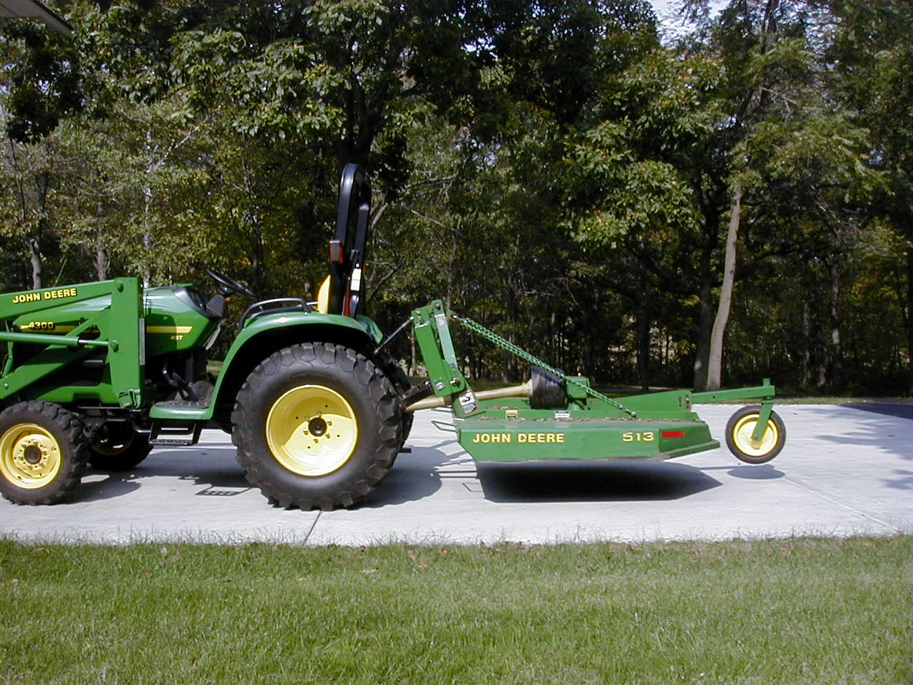

You should have a shield on the pto shaft also, a safety thing.
Never are around that shaft when the rotary mower is running, so not an unsafe PTO without a shield.. IMO.
Those shields are/were for operating the PTO on equipment that you are working around while running.. feed mixer, baler, chipper, etc.
I replaced the steel straps with chain that run to the rear of the rotary mower deck.. works great with hyd. top arm combo. Adjust top arm so the mower floats (chains loose) on the rear wheel, but lifts off the ground when 3ph raised.
Stiffened the rear skirt on the 513 with some square tubing to help backing into brush.

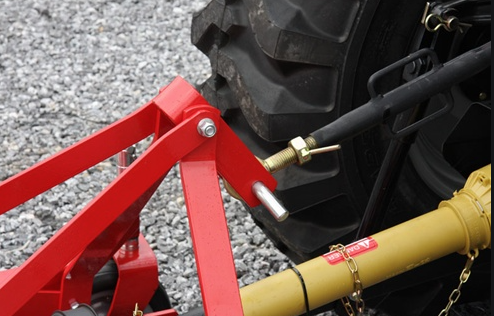

This is similar to one I have on a finish mower and on mine you want the two straps that attach to the top link to point down and generally be set at about a 45 to the ground.
Also make sure the pin is not too long or it hits the uprights.
This allows the rear of the mower to raise and lower from its standard position and follow the ground better. The more it points to the ground the more the rear of the mower can drop such as if you were backing into an area with a drop off.
On mine when I am ready to transport I just wind the top link up to take up the slack.

Glad you got it worked out. Another Idea that I like for a bush hog with real wheel(s) is to replace the top-to-back braces with welded chains. You get full float over terrain.
Another essential to me is a top link made out of a hydraulic cylinder. It's Infinitely adjustable and can lift the back very high with a flick of the lever.

Looks like you need to set the rear wheel up one notch so the mower sets flat - 1/2" off the ground at all 4 corners .
