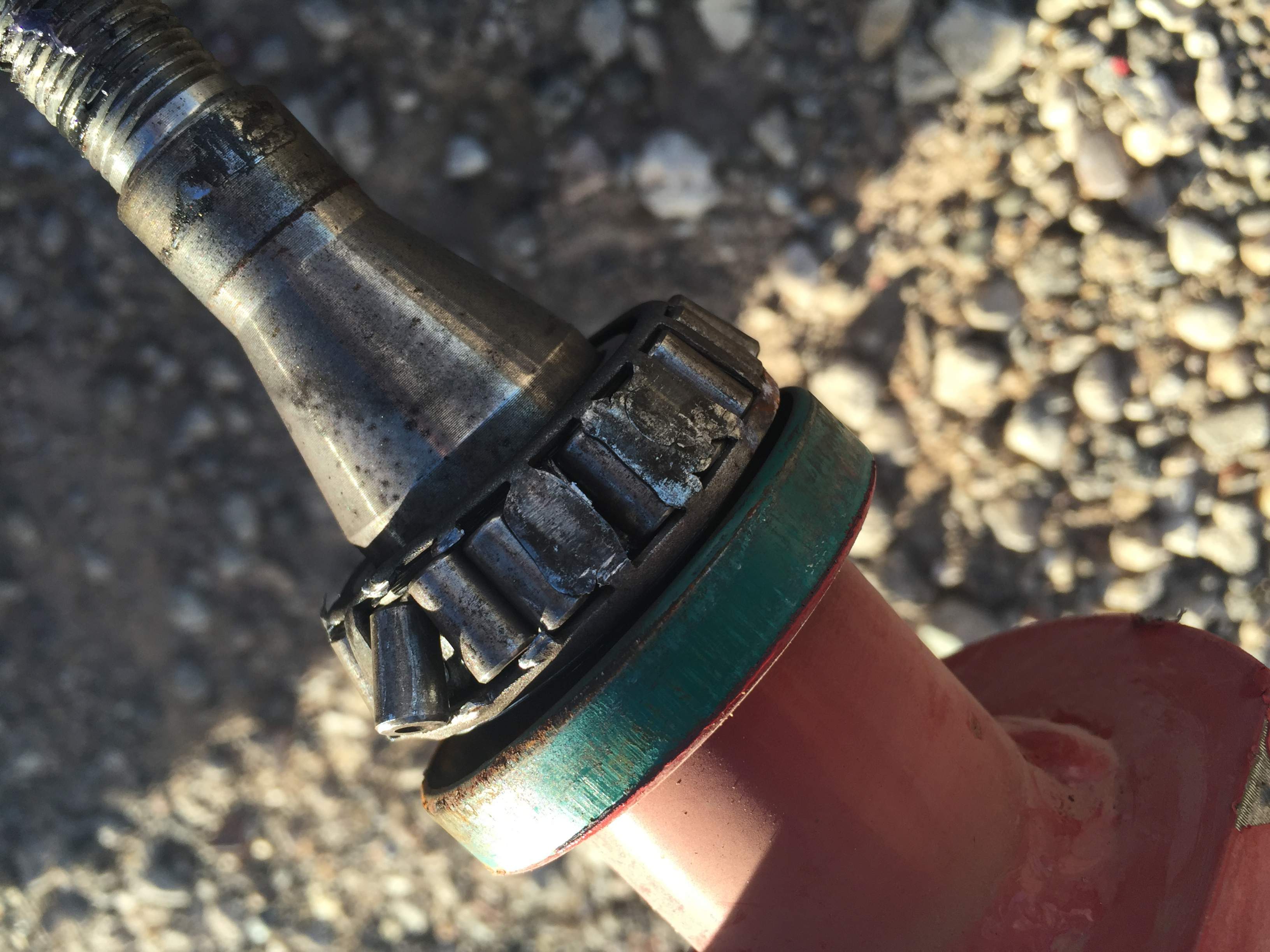

I bought a brand new Bush Hog 2010 3-pt shredder this week. Not a cheap unit it was nearly 7k.
My dealer brought it out and commented that the diagonal bars that went from the top of the 3-pt to the rear of the machine wouldn't fit. They had to cut a little off the corners by the bolt holes to make them fit. Seemed strange but it was very obvious they wouldn't fit without modification.
I hooked up the machine and went to mowing some crop stubble. I ran maybe one hour and a tail wheel locked up. I pulled the dust cap off the wheel and the bearings were bone dry and the inner bearing was shot. Dealer apologized and said they would make it right but I had mowing to do and didn't want to wait until they opened in Monday so I fixed it myself. The bearing was only $10 so no big deal but I had a heck of time getting the race off of the spindle as it was seized to it.
I got the bum wheel fixed and figured I better check the other side. I pull the cap off and see a blob of grease on the castle nut. I pull it apart and both inner and outer bearings are bone dry. Looks like they assembled it with no grease on the bearings and once the hub was bolted on and cotter pin installed they just smeared grease on it and put the cap on. Glad I checked it.
I wonder what else they neglected.

I think your spindle is finished too.
The spindle was damaged and I thought I was going to need to torch off the race but I was able to chisel it off. I buffed out the damages to it and the new bearing went on nicely. It is not like it is on a trailer going down the highway so it isn't going to be catastrophic if it fails. I think it will be ok but I am telling via email the dealer about it so that if it does fail down the road they can send me a new tail wheel assembly.

Yep - checked them all as did the dealer. They said they greased them and filled the three gearboxes and I verified that they did. They obviously didn't pull the wheel bearings apart to check them but you really wouldn't expect them to either. That should have been done at the factory when it was assembled.

I have a bush hog 84" finish mower , it was delivered with little to no grease in the mower wheels started squeaking after a half hr of mowing. The dealer said it was greased and ready to go when they dropped it off. Well the one or two pumps of grease they put in wasn't near enough, it probably took close to a full tube for all four wheels to get it to start coming out of the seals. To me it seems like my dealer and yours dropped the ball on the predelivery aspect of the sale.
I think could also be that they probably had some body with less experience grease this thing and they did it like a unit that was already in service and only give it one or two pumps of grease.
