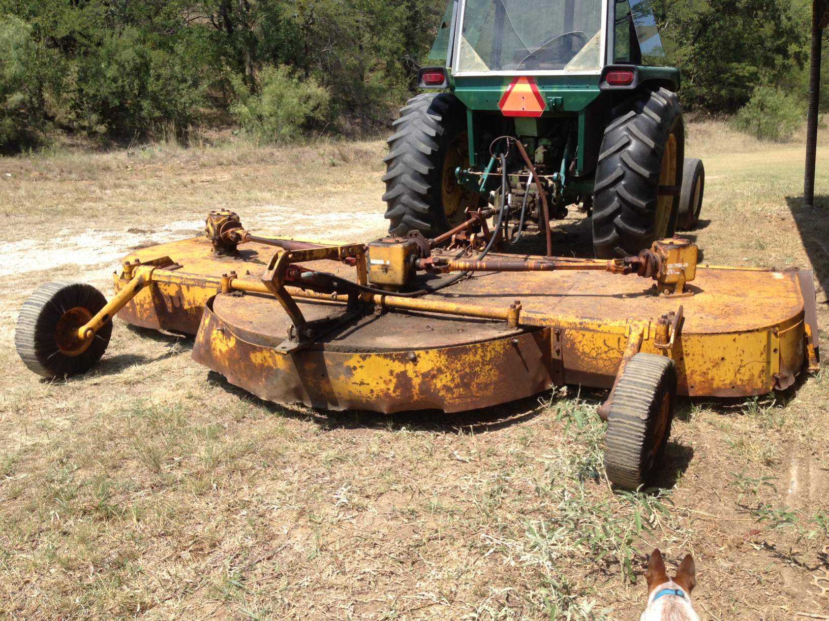

I found an old faded tag on side that says: Gyro Shredder and Chopper
I believe this is an old Servis Gyro 140 from the 1960's.
/ bush hog not cutting #85
That unit was made by Servis Equipment Company, which became Rhino. That's good news because (a) it is a quality tool, and (b) they might possibly still have parts for it. But it is really, really old - probably from the 50's or 60's.

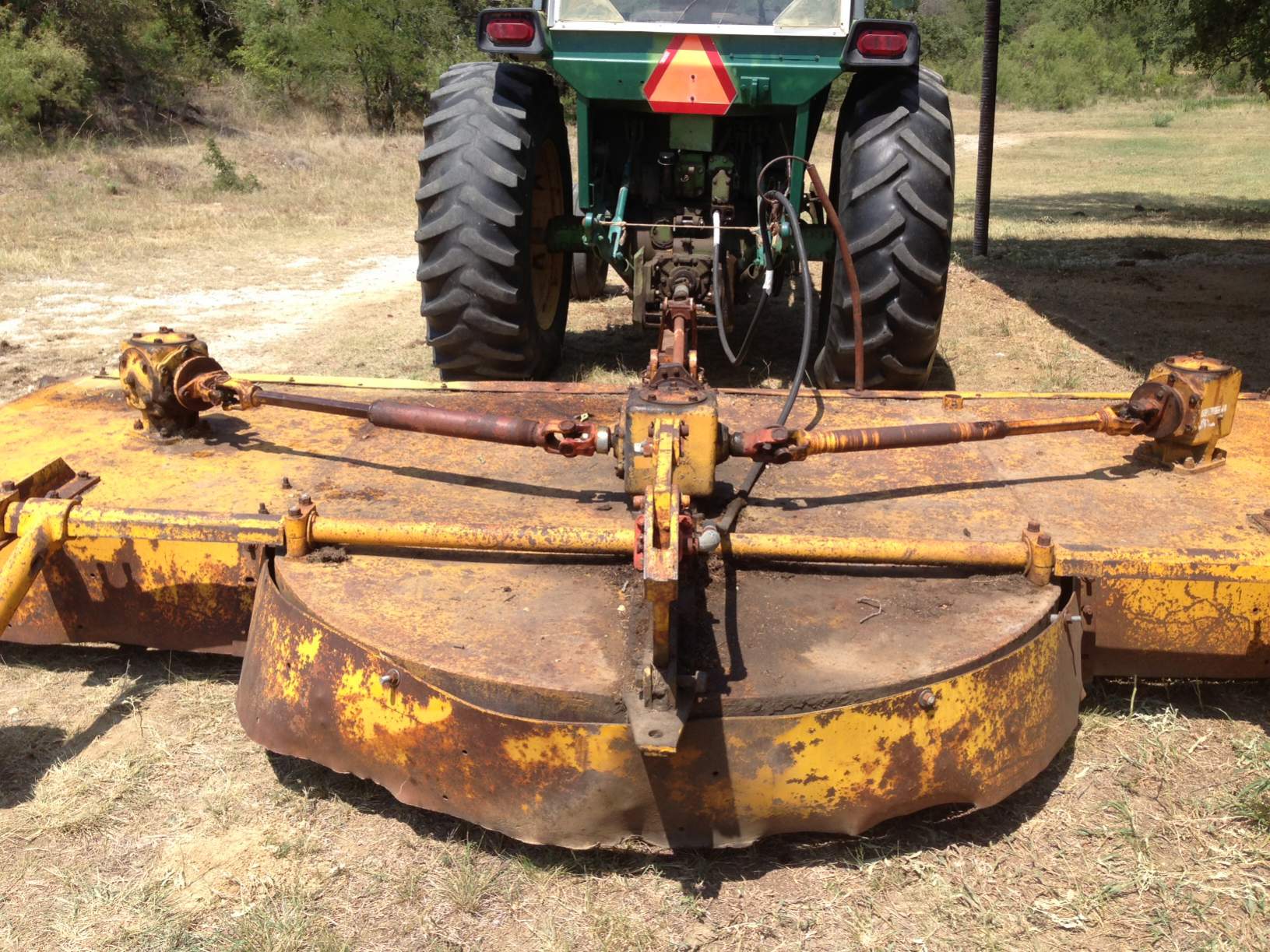

I can only suggest that if it isn't another shear bolt broken, then put the pto in gear, tractor in gear with engine not running. This should lock everything down. Then try turning the blades from underneath and see what moves. If they all turn together when you move one, then the gear boxes should be good. There will normally be a bit of slack in them and you may be able to move the blades as much as 1/2 turn or more but at some point it should stop turning. If you have a helper or two, put them to either turning or watching to see which of the shafts move. At some point you will find that the shafts are moving on one side and stopped on the other. Then you can fix it or at least figure out what is broken.
An easy way to turn the blade might be to put a pipe wrench on the outside shaft and turn it with that and have some one verify that the blade is turning underneath. If you can turn the drive shafts at the outboard gearbox with the tractor PTO in gear there has to be a broken part somewhere maybe in the tractor itself (heaven forbid)

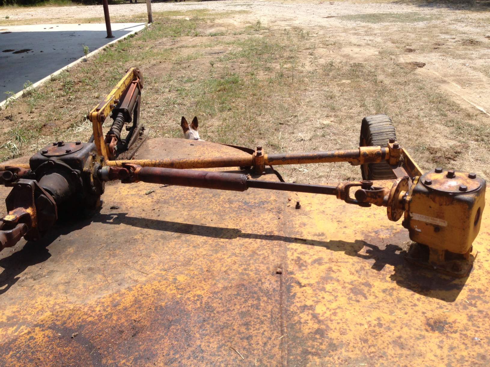

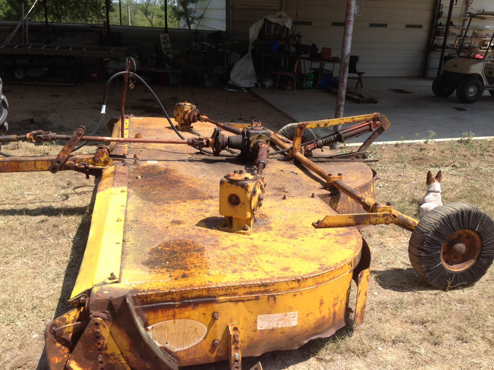

Can you post a close-up photo of the circular "device" right at the front of the main center gearbox? My theory is that it is a slip clutch of some sort that is very worn and slipping profusely. When you turn hard, it is putting enough flex in the PTO shaft that it increases the friction just a bit in the clutch, enough to spin the other gearboxes.

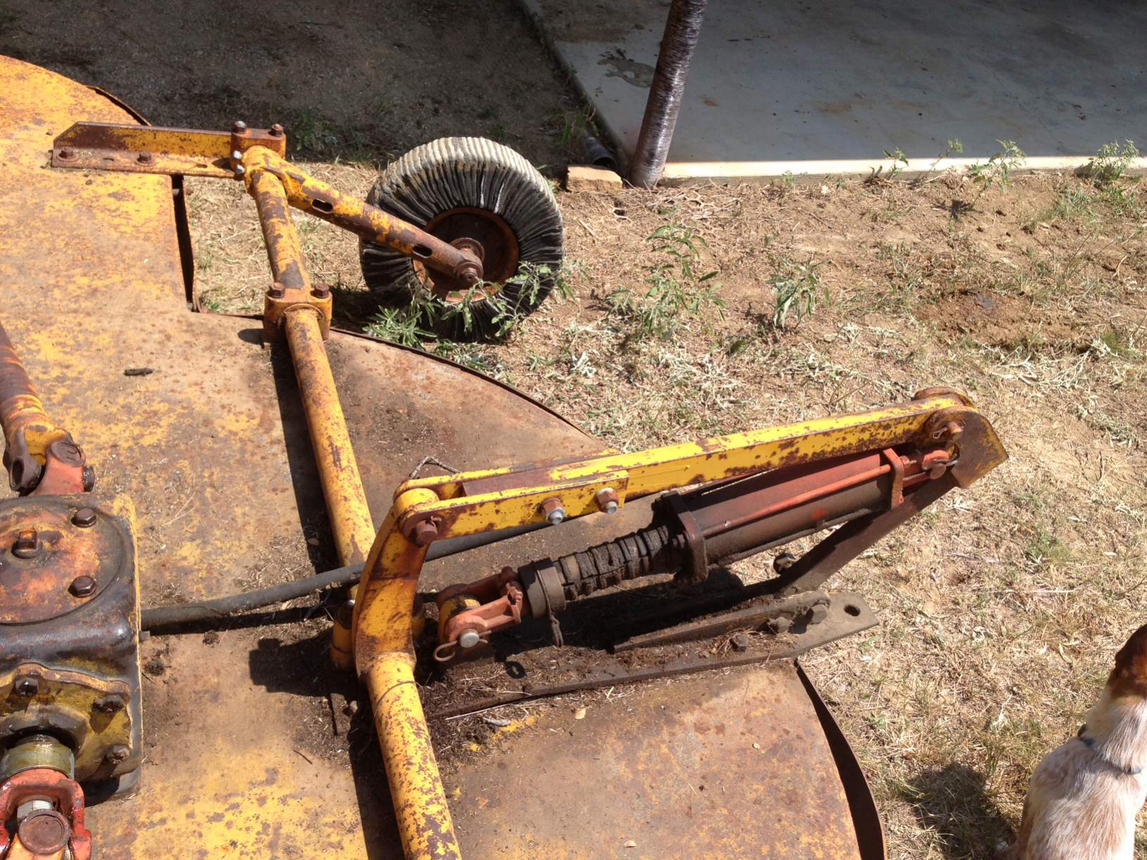

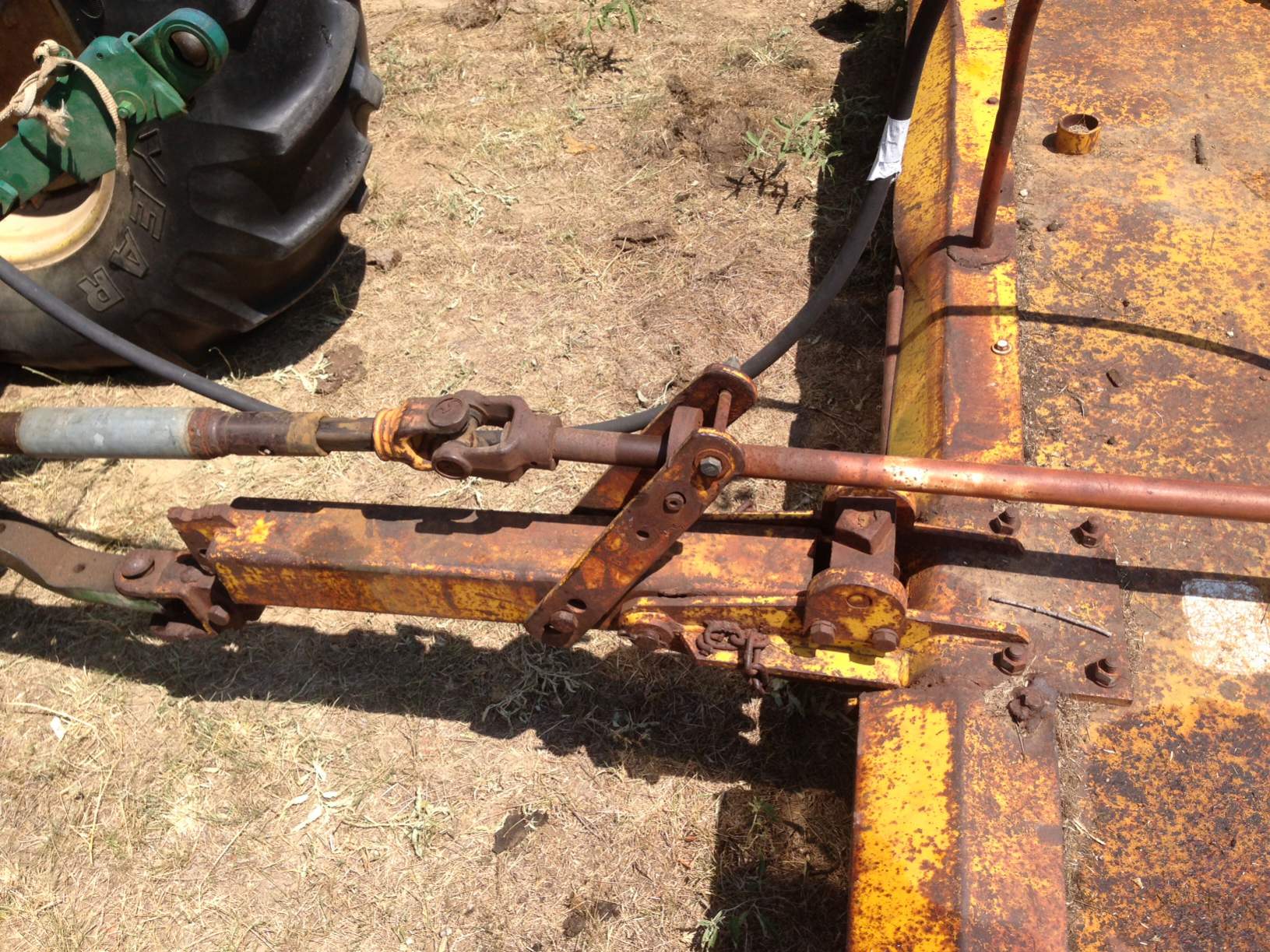

I am just curious as to where the shear pin/bolt was located that you replaced,I couldnt see anything new on the photo's you posted. I also have an old Servis brand hog. If your's is similar to mine,and by the photo's it look's like it.Where the drive line coming from the tractor bolts to the cutter, those round plates are actually two seperate pieces. The driveline bolt's to the outer round plate,and the inner round plate bolt's to the gearbox.There should be a shear pin that bolts those two plates together.Without the shear pin ,both plates turn independant of each other and would exibit exactly the problem you are describing..That may have been the one you replaced,if not take a look.I blew your picture up as far as I could and I think I see a portion of the broken shear pin hanging out toward the gearbox..If we were just a little bit closer neighbors,I would take a look at it for you..
