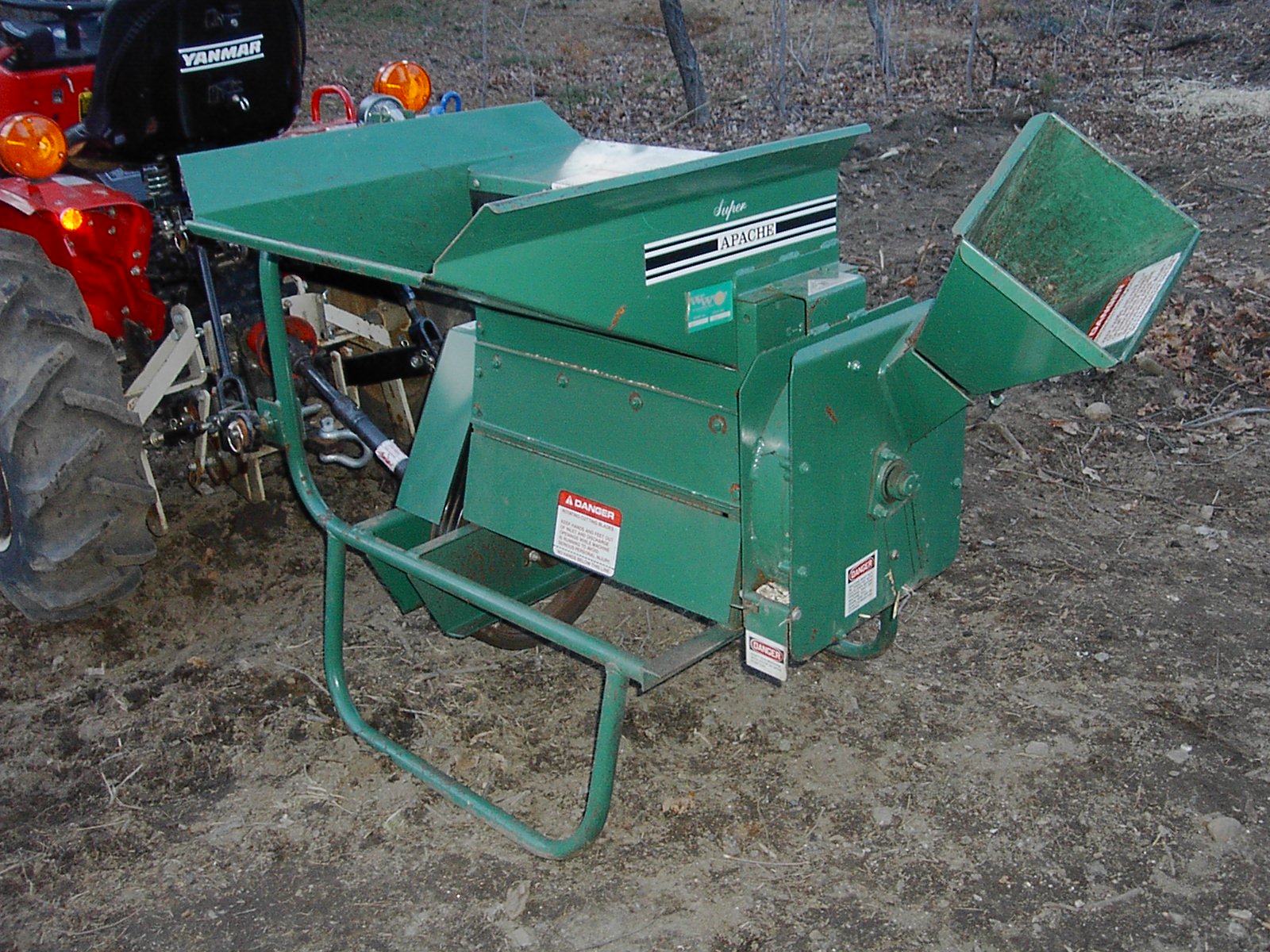

Is your chipper direct drive? I don't even think mine has shear pins, but then mine is belt driven. I think for me, the damage will be to the belt or PTO, and the belt is no cheaper than the blades.
   / bush hog cs-100p chipper/shredder #13
Mine is belt driven, but there is a shear in the pto shaft also.

Nice looking machine. The hopper looks to be real wide.
