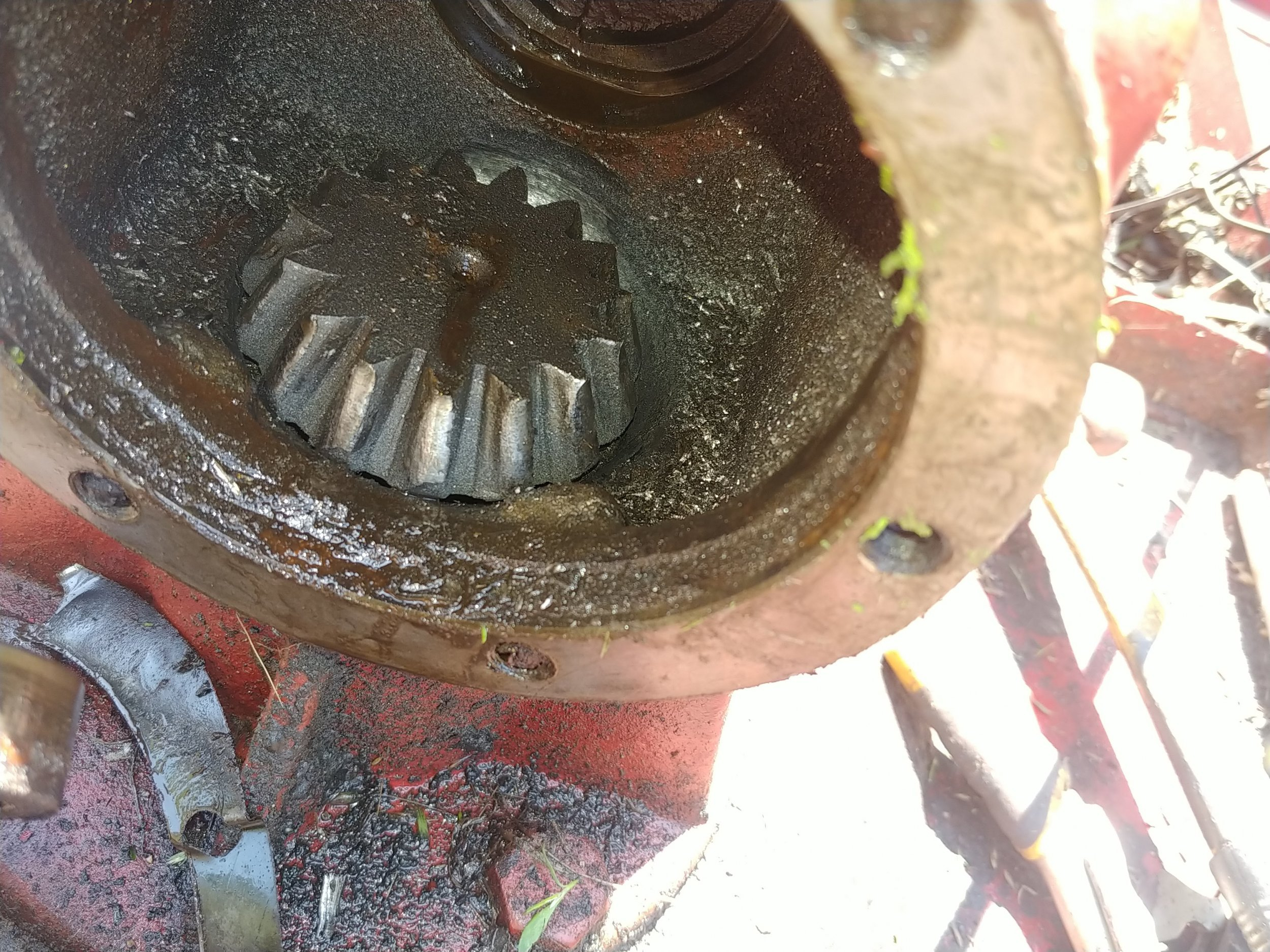

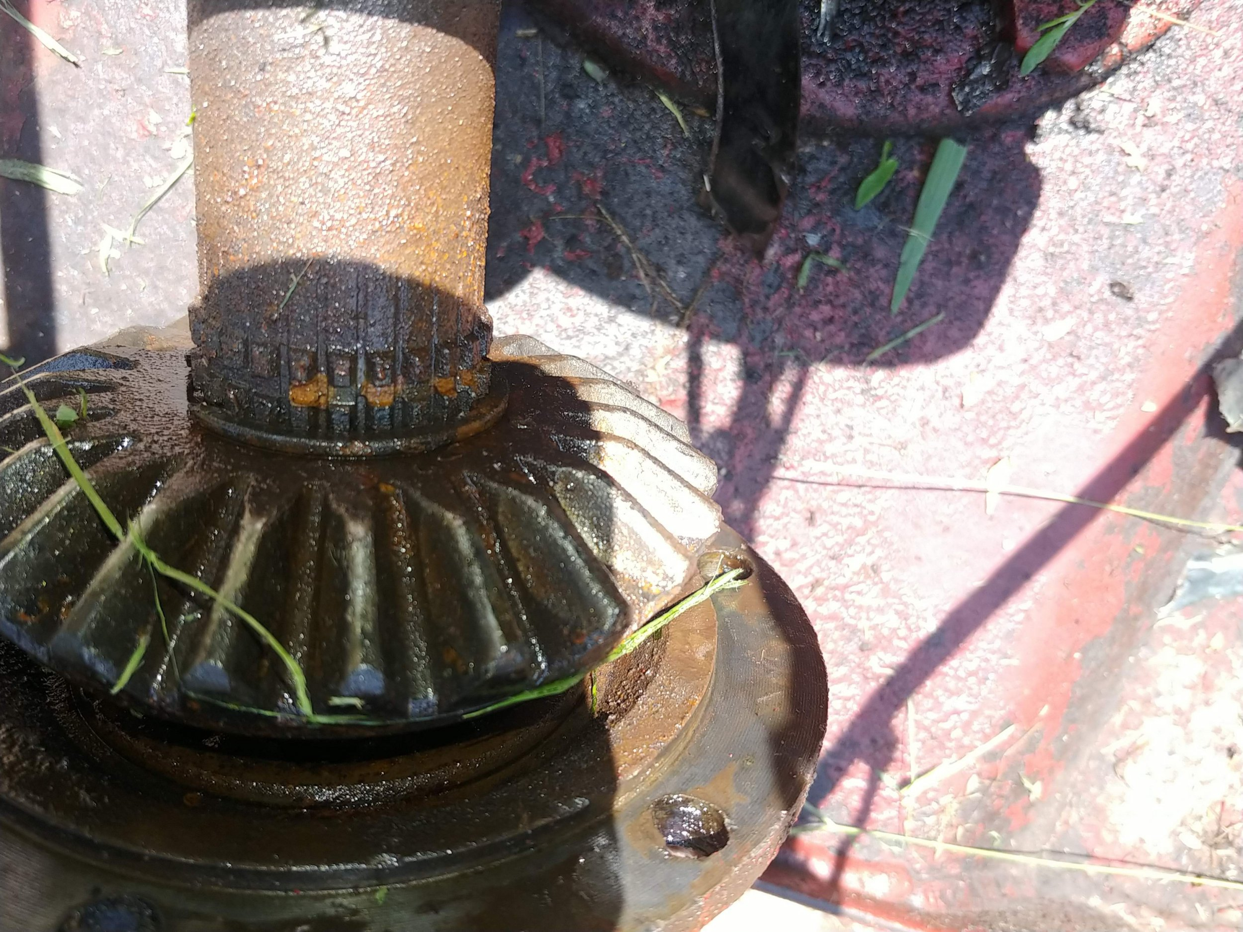

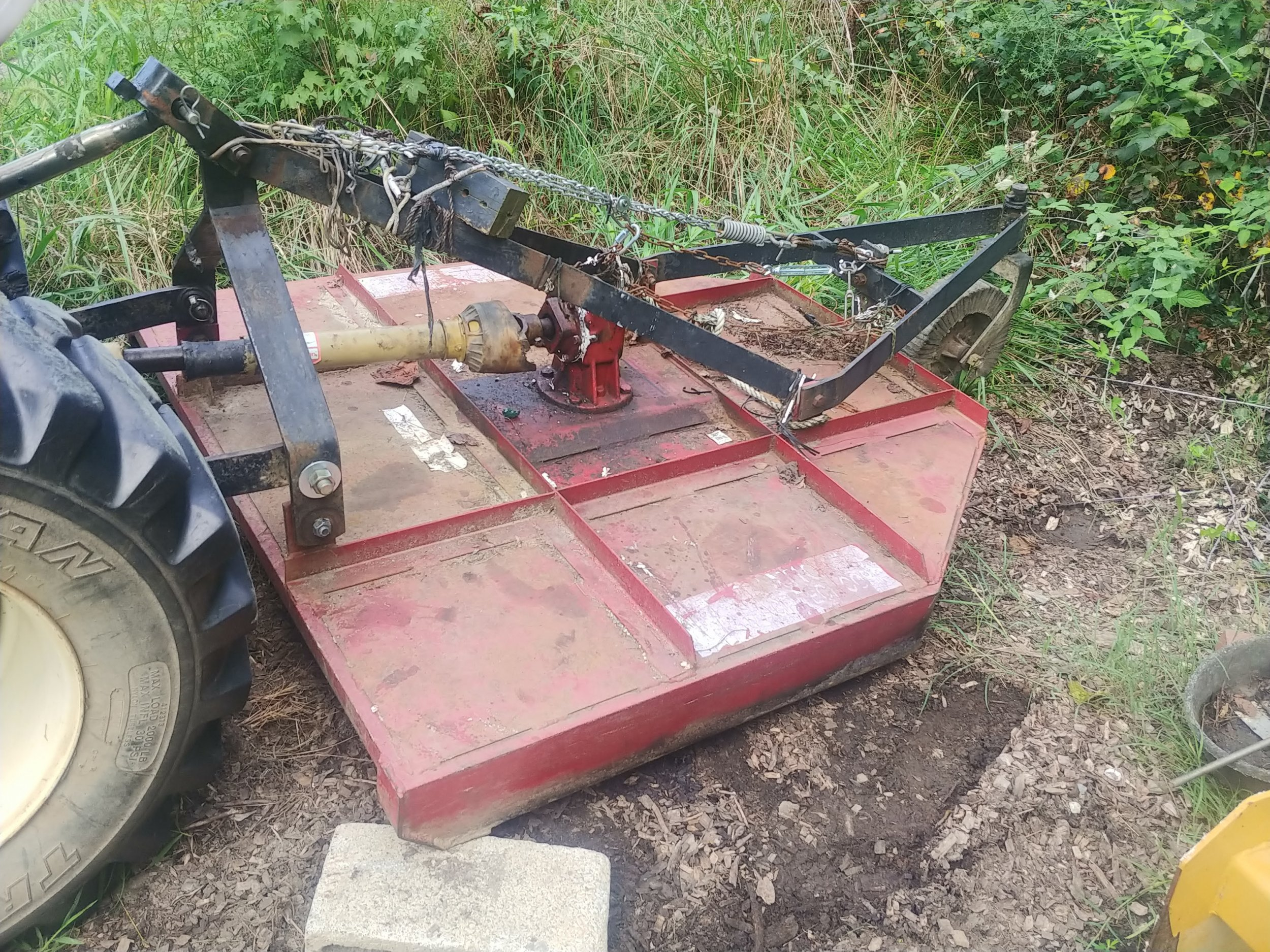

I already searched for similar threads, but didn't find anything that applied. I have an old rotary mower (King Kutter maybe? Not sure). It looks a mess, but worked fine until I was doing a heavy field of brush, and no doubt hit something. (I should also note that I committed a mortal sin and had let the gearbox run out of oil. This may be the answer).

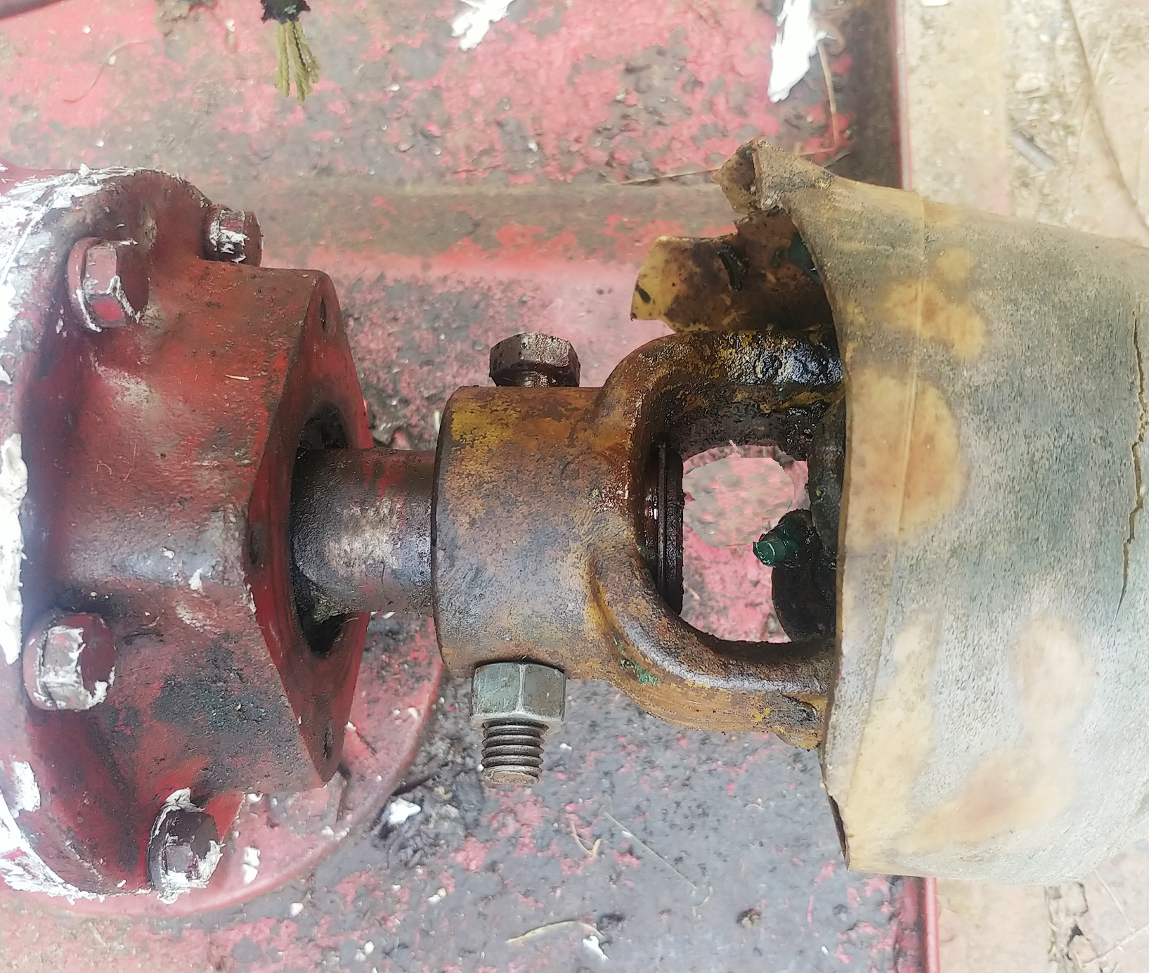

I checked that the stump jumper hadn't been knocked loose and was sufficiently tight, and saw the shear bolt was still in place. I noticed that the blades would catch and spin a little at times, but with no force. So I pulled apart the gear box and saw what MIGHT be stripped gears, but although clearly they had been rubbing, it seems to me they should still be catching okay. So clearly I destroyed something here, but I don't know what. Here are a few pics for reference.

I agree that the gears should still be catching. Do you have another PTO shaft you could interchange ? That would eliminate the possibility of the problem being with the shaft or where the ends engage. Remember, the 2 piece shaft should have 6" of engagement, one piece to the other, when in use. And you don't want much more than that for fear of forcing the PTO into the gear case of the tractor.

I think the PTO shaft is fine... the cover has mostly torn off, so I can see it turning at both ends. Is there anything else I should be looking for?

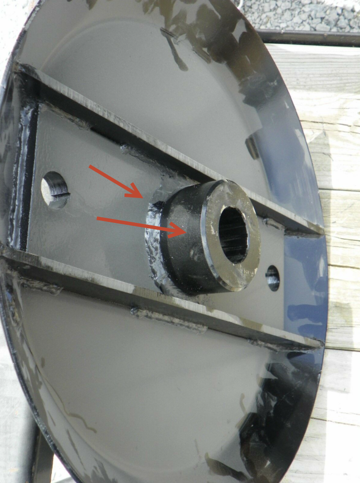

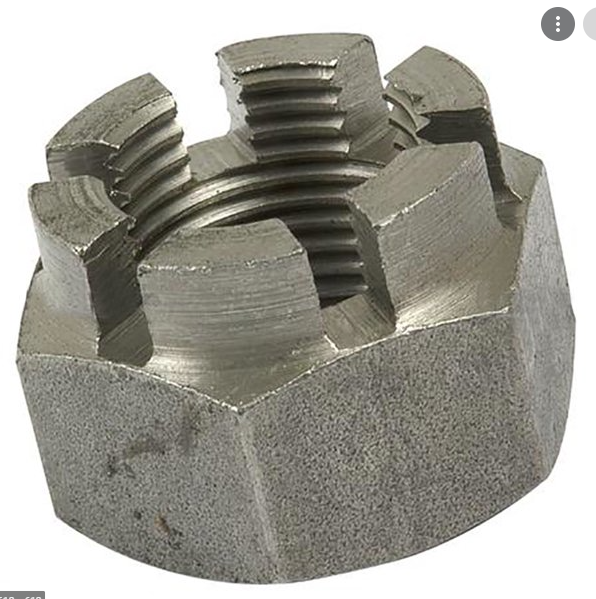

This is a typical stump jumper. It goes up onto the shaft that comes out of the gear box. It is held on by a large castle nut (pictured). Then the blades bolt to it.
To remove it you'll need to be able to access the underside of the brush hog. This is dangerous so get help and make sure to position the brush hog so you can work on it without a chance it can fall. I usually tip mine up on its side so it leans against a couple trees. A tractor with loader can be used to flip it over. Once you have access to the underside you can just look at it to see if it seems ok where the two parts are welded together.
You want to check to see if the round part (splined part at the center) is still welded/attached to the disk part. If it looks ok then once you can safely get to the underside you can see if rotating the input shaft causes the output shaft to turn.

Additionally, the output shaft and the stump jumper have a tapered spline. You might get the castle nut off easily but will have to fight breaking the taper loose. Doesn't grab like a Morse taper but pretty close to it.

The teeth on the blade shaft gear are damaged from your picture. It's new gear box time. Good news is they are cheap on ebay. Around 160 bucks shipped. The 40hp boxes on most light duty cutters are all the same. Remove the stump jumper and count the splines. I bet there is 12 splines.

If you are going to replace it only go new. You have experience now of how beat up these things get and how rigged they can get over the years.
What do you cut with it? Just maintaining pasture or are you constantly clearing 1" or larger brush, rocks, tree stumps?

Looks to me like the vertical shaft has slipped down - see where it has been rubbing on the housing? This drops the beveled gear down where it won't engage the horizontal shaft.
/ Bush hog blades won't turn #19
This is my guess as well. That output gear is sitting on the housing. Probably very dead bearings under that due to lack of oil. Teeth look ugly, but they would still engage. (and make a further mess)
