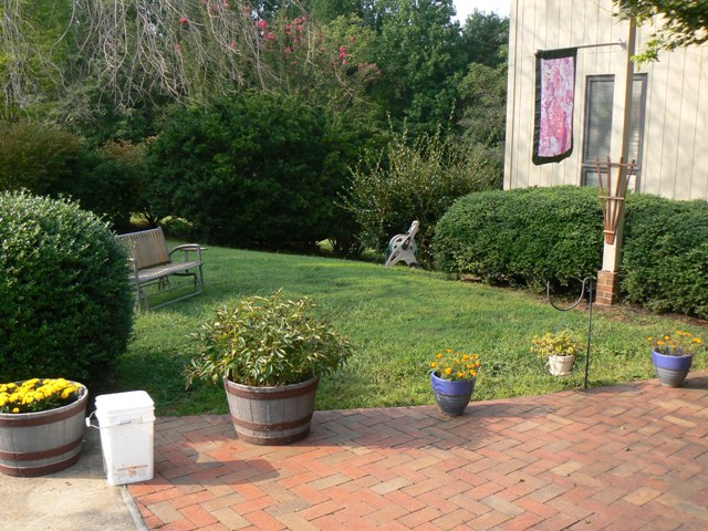

Another option if you can move it is to plant "around" it. In the pic is an above ground LP tank. See where it is? (hint, almost dead center of the picture, little to the left).
