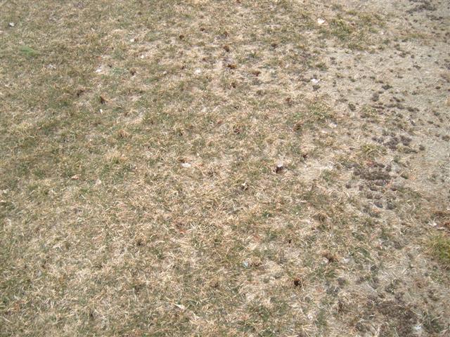

Finally got to use the aeorator today. This pic was on grass that is rooted fairly well.

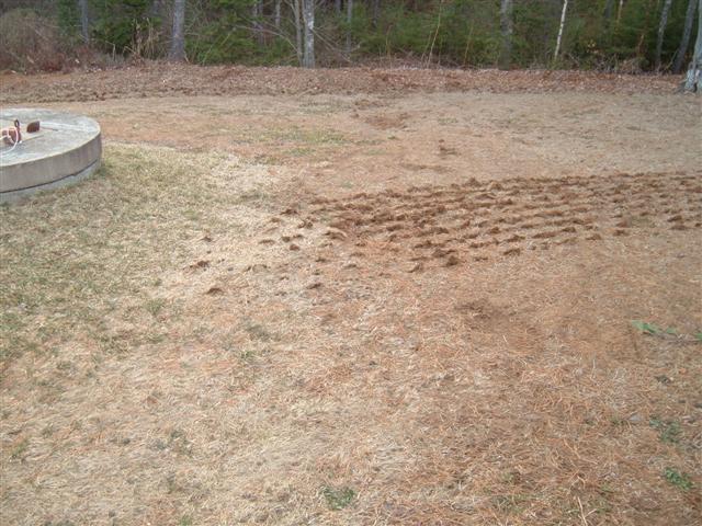

This was on an area that the grass is not very dense yet.

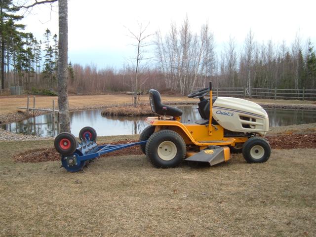

This is a finished view of the beast.
