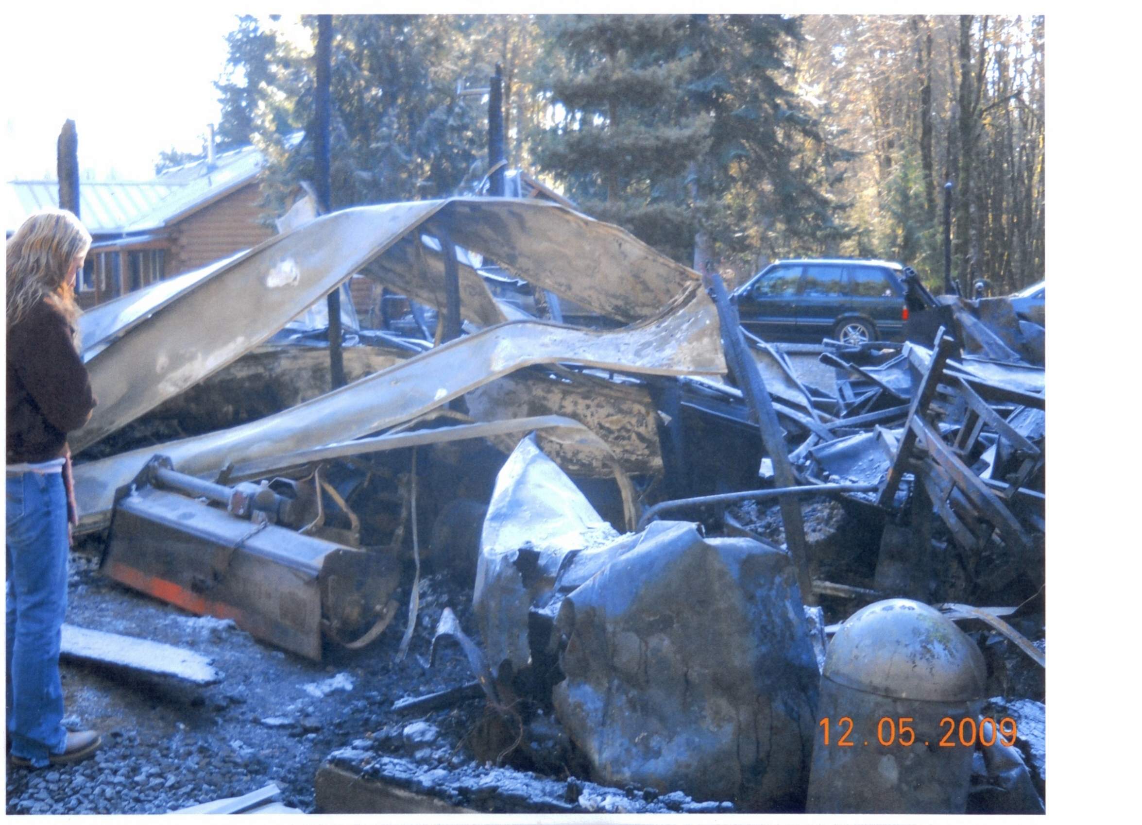

I figured the tiller would be easy to fix since i would replace seals, bearings, and the paint of course. I guess the fire got so fot that the neighbors toyota 50' away was steaming. So the first thing he did was back it down to the end of his driveway. I guess we wont know very much about the tractor until I pull it out of that mess. I figured that i would unhook the tiller, put it on my forks, and haul it home. If the tractor and FEL are not saveable, i guess I can earn some money from the scrap yard. If the loader is in fact savable though, it will be a job to remove it. I know the fire was hot though since the motor home (nolonger a motor home) had a puddle of aluminum under it. It would be just awful to loose so much stuff that you worked so hard for. Especially waking up to all the fuel tanks exploding. I know the tractor had a quarter tank of diesel left in it when i Parked it for the last time. I do think the neighbor is a little excited to get a bigger 2007 kubota though. And this one has a backhoe. I cant wait to drive it. :cool: The picture is in memory of the 4100, this was the last time it ran. I did offer my tractor to him while he didnt have one but he has been so busy at work that he hasnt needed a tractor. In the next week or two, i plan to grade his road to his house for him with my Yanmar.

There is nothing there that would be worth saving, except maybe (big maybe) the tiller. I wouldnt even use the pins or bolts from that tractor as they are most likely weakened from the heat. If your parents are agreeable, it would be a great thing to take apart to learn from, but I wouldnt part it out. Too much risk of selling someone a peice of junk that appears to be ok but breaks the second someone bolts it to their tractor, not a good way to make friends.
The tiller could probably be rehabbed for the cost of bearings and seals, and if it still turns out to be junk, oh well, still not much money in it. You cant put a price on the kind of learning experience this will give you just taking it apart and seeing how it works. Probably still get $100-200 scrap once its taken apart.

Clean it up real good, spray some cheap green paint on it and sell it on ebay. Some idiot will buy it! The guys are right it is probably not worth fixing but if you want a good learning experience and you have the time tearing it down would be a good project. Who knows you might tear into it and find it is not as bad as you thought.

I know you are an enthusiastic young man wanting to rehab this poor tractor; but from what little appears to be poking through the ashes in your picture, that 4100 isn't worth messing around with.
Just because it's free doesn't make it a good deal. There are plenty of tractors out there for you to rehab. This is not one of them.
I'm not even sure I'd mess with the tiller given the heat generated by that fire.

I have to agree that rehabing is probably not worth it, but the experiance and knowledge gained from taking it apart could be great. I would spend the time to dismantle it and learn what you can about how it functioned, then take the parts to the scrap yard.
The tiller is the only thing that I would consider trying to salvage.

Thanks for seconding my earlier suggestion about using the tractor as a teaching tool. I made that suggestion before I saw the picture Jacob posted.
I admire Jacob's enthusiasm for machinery and I would rather see him sink his money into his Yanmar or another tractor that is a candidate for rehabilitation.

You may need to find another gearbox for the tiller(or at least watch it in use). I think they used heat treated(hardened) gears, and a slow cooling would make them soft. If you have a slip clutch, there wouldn't be much of a consequence if they failed, though.
