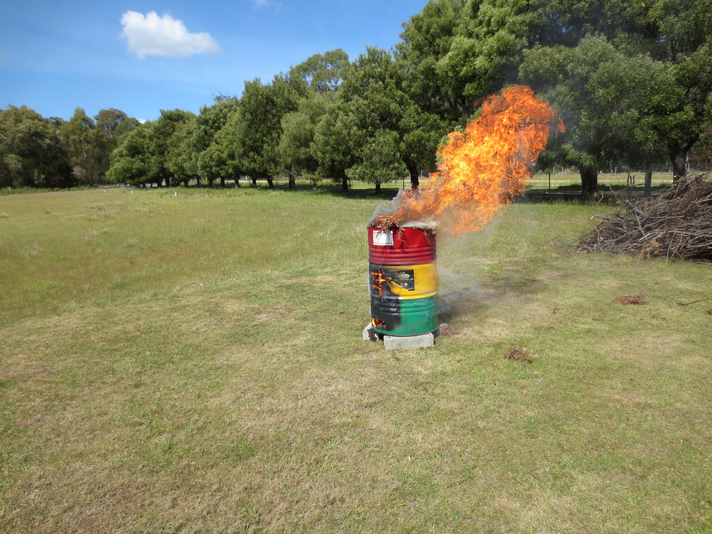

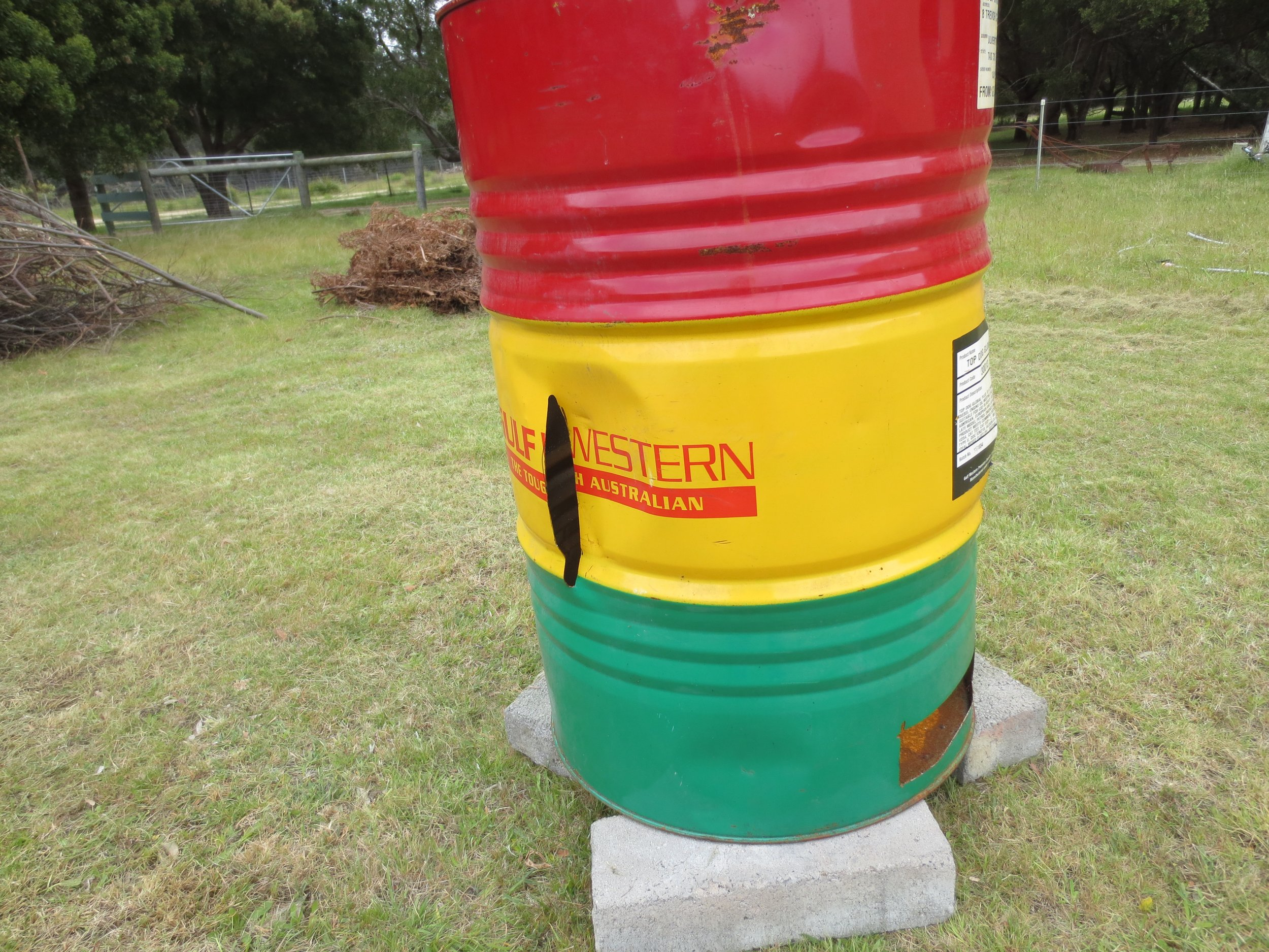

I cut four - 2" holes around the bottom of my barrel. Barrel sits up on four bricks - evenly spaced around the barrel. This eliminates the chance of a "hot barrel bottom" starting a grass fire.

I put six slots close to equal distance around the bottom and middle. The flames will swirl out the top. Burns paper very quick except for glossy magazines and they won't burn in anything. Sister found a plastic box of quilt tops that had a hole in the bottom and they were soaked from a leak in the basement. We threw them in two or three at a time on top of the paper/wood fire that had been burning for a couple hours. And they all brunt.
One problem: The wind was blowing very hard today and the flames came out a foot or two from the vents on the downwind side. Burnt the grass three or four feet away. Sister has learned to watch the smoke and always approach from upwind. Really funny to see my 73-year old sister scream and hop backwards to avoid the flames.
Second problem: When I put the top (top off an old dishwasher) flames sometimes come out the side. A long way out the sides. Can't really cover the top and walk off from it.
Old barrels would sit and smolder for three or four days before completely consumed. This will be ready to dump in two days with ashes completely cool.

I cut a few 6x1 angled slots near the bottom. Fire swirls and burns hot. Empty into the pit in the fall.
   / Burn Barrel that works #26
Getting flames to swirl and rise 4 feet above the barrel isn't near as difficult as putting out grass fires caused by floating embers. :oops:

I used a 1.5 inch hole and drilled 4 holes nicely spaced at the bottom and another 4 just below the first ridge but staggered between the lower ones.
That is true. Next one will have the vents a little higher and maybe a little smaller. My main problem with that was the wind blowing very hard.

I use a stick welder to cut about 6 vertical slots about 6 inches long a few inches from the bottom of the barrel so air can feed the fire from the bottom, barrel lasts about 5+ years, and it always burns excellent !
