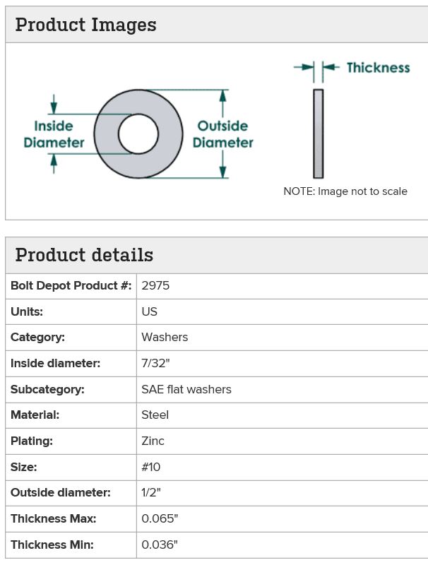

Can someone with a shim please post a picture of it and also measure the diameter and post that? Do the shims have a hole in the center (like a washer)? If so, what is that diameter? Thanks.
   / Bump up lift capacity of L3400/LA463 Loader #312
Most just use a #10 machine screw washer. Looks just like any other washer.
Put a gauge on it first. And make sure you dont over do it.

   / Bump up lift capacity of L3400/LA463 Loader #318
For the others like myself who don't know the size of a #10 washer, here you go.....
