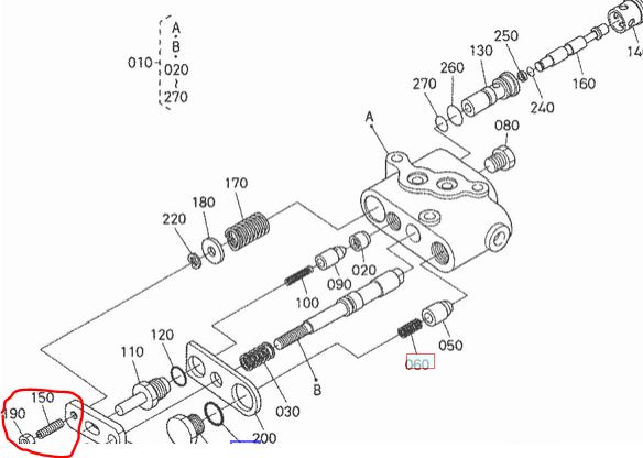

I looked through the PDF for that tractor many times and could not find but one relief valve which is in the FEL valve. .
Some times there are three relief valves, the FEL relief, the remote relief valve, and the 3pt.
J_J
What is the adjustable valve(parts keys 130-270) for the 3 pt control valve for a L3400 if it not a relief valve for 3 pt? Parts key 150 outlined in red is a socket head screw.
Thanks,Jim

J_J
Thanks,Jim
Jim,
You guys keep trying to get me on something, and even if you do, I don't mind. He**, I make mistakes like everyone else.
McREBEL said he had a B2920, so I don't know what to tell you.
Look up the B2920 and tell me what you find.
I usually do my homework.

FWIW, my tractor (B2910) has two PRV's (not counting the one on the rear remotes)
It's certainly true that the PRV on the loader likely sets the max pressure for the system (being first in the chain and furthest upstream) ... but it is also possible that if there is another PRV downstream of the loader valve - say for the 3PH - it might be set at a different pressure.
The data on your tractor is correct with a relief valve at the rear, and if you have remotes, you probably have another relief valve, and if you have a loader, then you probably have another relief valve.
Go ahead and look at the PDF for the B2920 and tell me what you find.
Your tractor probably came from the factory with only the 3pt relief, and has the tractor set relief pressure.
The loader and rear remotes are add on.
The other relief valves should be set the same, unless you want to set them different for some reason.
